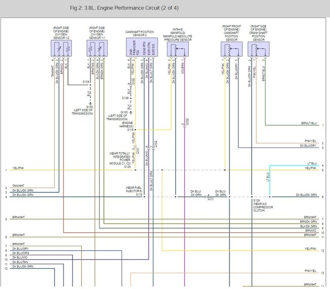

Check the fuses and check the wiring harness that leads to the sensors. These codes can be caused by power failure to the heater circuit or an open circuit to ground.
Both of those share the same ground wire and are spliced partway up the harness before they reach connector C111. Check for continuity between the grounds of the sensors and the chassis. No ground = broken wire or bad connector.

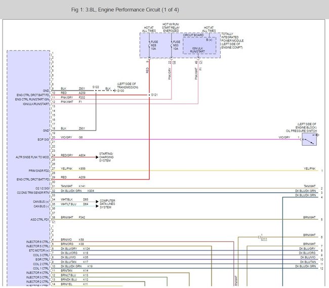

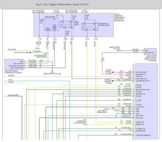

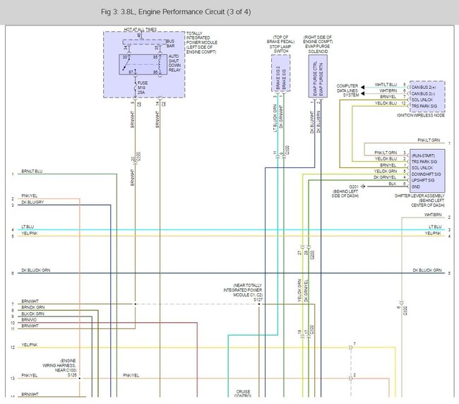

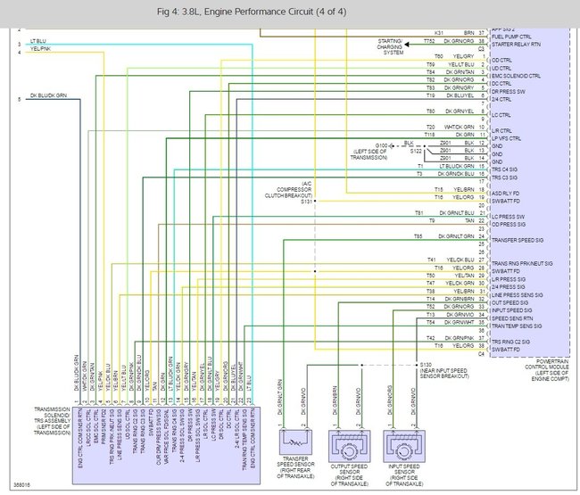

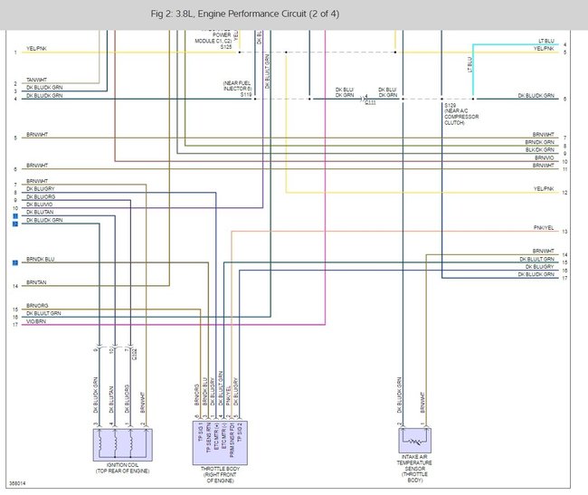

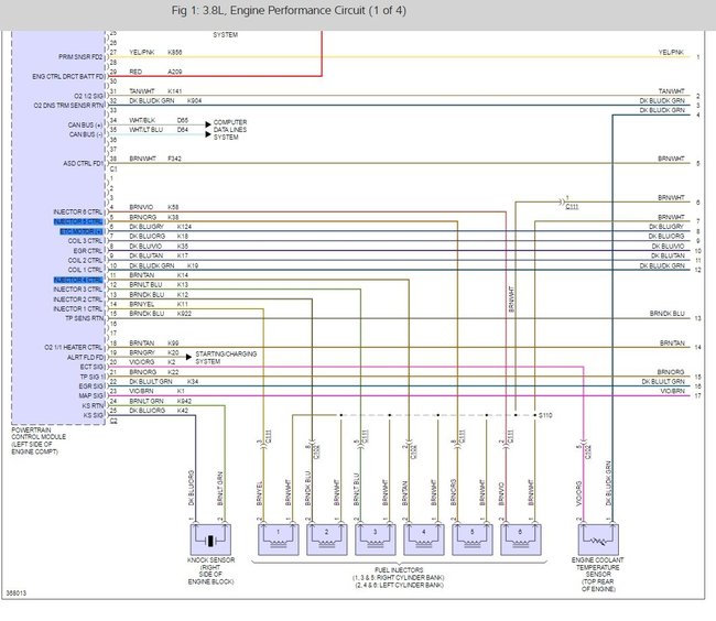

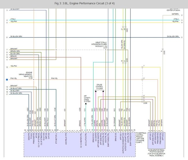

It sounds like its time to check some wiring, here is a wiring diagram and a guide so you can do some testing.
Please run this test and get back to us so we can continue helping you.
