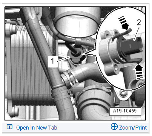

Yep, I agree with MECHTRIX, I would change the sensor and then clear the codes,
P0118 - Engine Coolant Temperature (ECT) Sensor Circuit High Input
Here is the sensor location which is right below the throttle body. Check out the images (below). Please let us know what happens.
