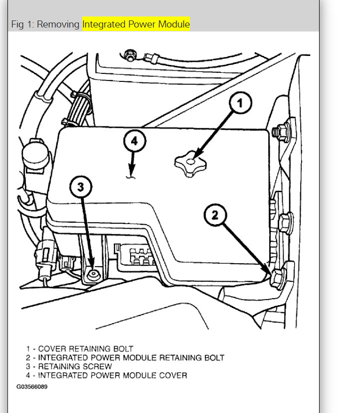

Driving down street, truck turns off . Will not start again. Codes p0920 p0921 p0999 no bus on cluster

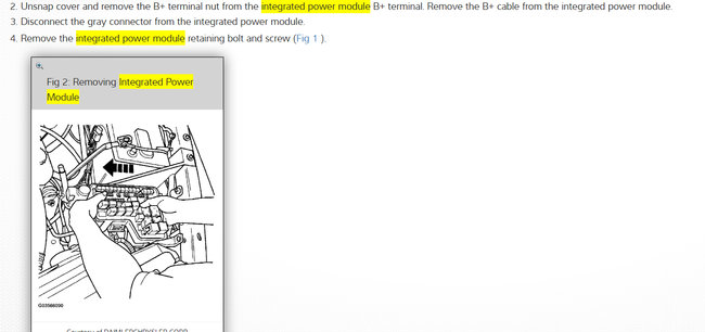

This is common with these trucks when the TIPM goes out, it will make the truck stall and pop up with crazy codes like this, it is easy to change because it self learns so it is plug and play. Check out the diagrams (Below). Please let us know what happens.
