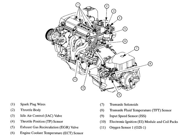

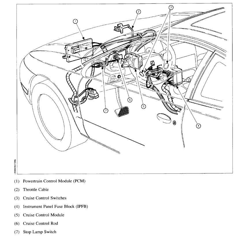

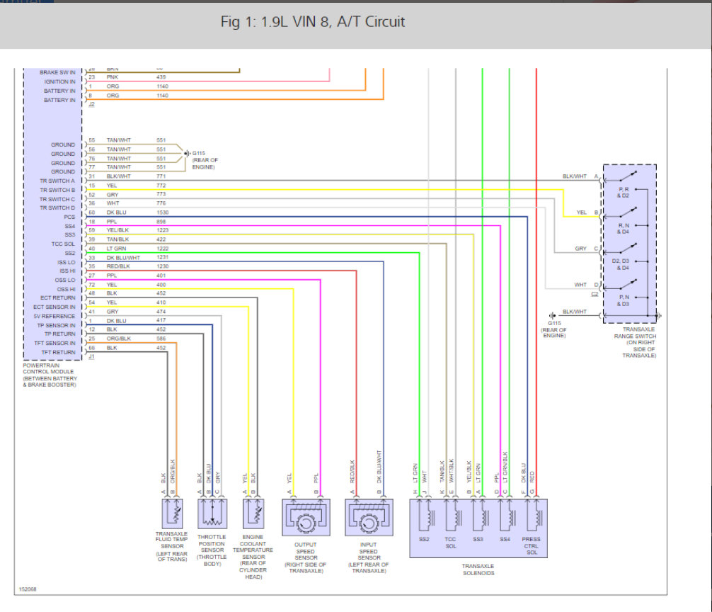

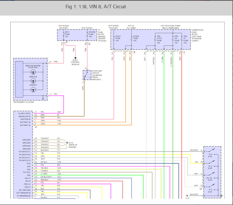

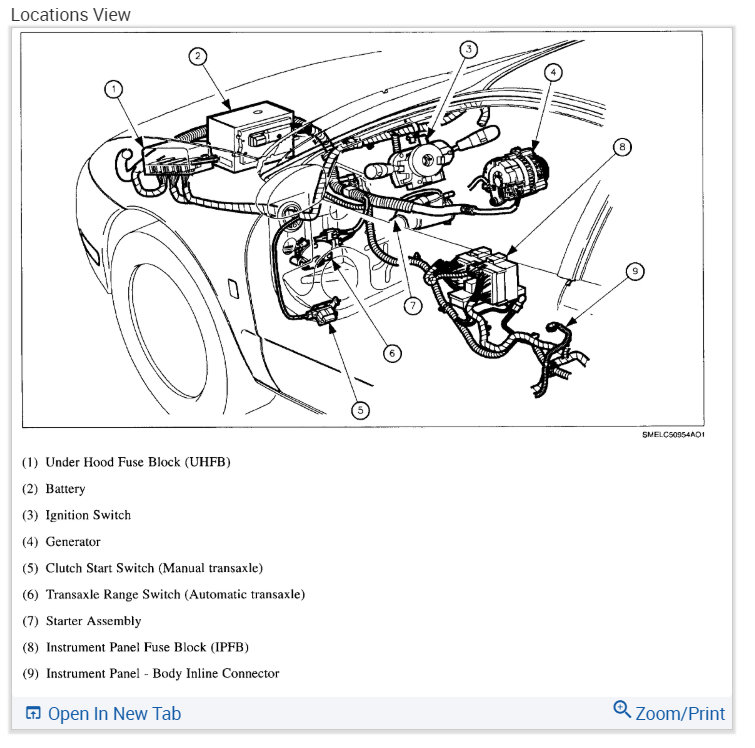

Hello Samuel,

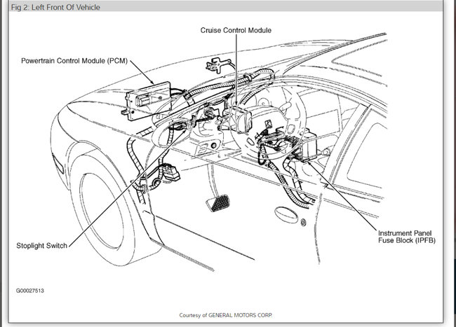

Let's test the transmission wiring to the ECM and if okay let's replace the ECM with used unit. Here are the wiring diagrams and the location of the ECM to be replaced:
Check for power at the fuses in the diagram as well. Check out the diagrams (below). Please let us know what you find. We are interested to see what it is.

I just checked all the wiring, the only thing out of the normal that I found is that the output speed sensor and the input speed sensor have a voltage of.452 volts, well below 5 volts. I'm going to check background the wiring to see if I find something out of the ordinary. But I would like to hear your opinion.
Jan 28, 2019 at 2:17 PM
Sounds like you are on the right trail, let me know what you find.

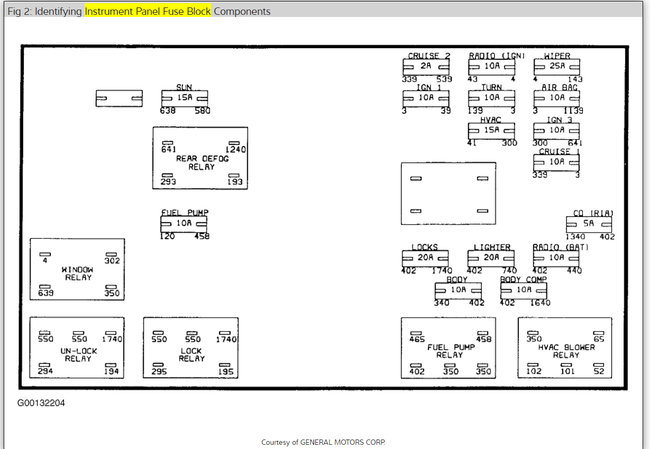

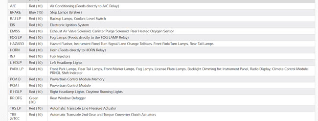

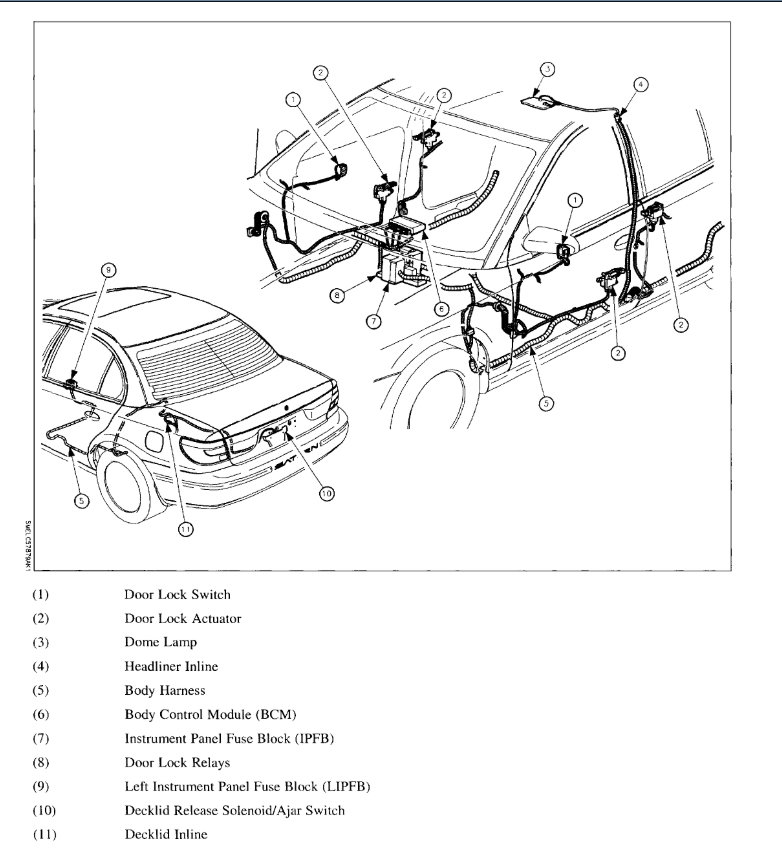

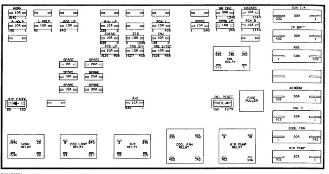

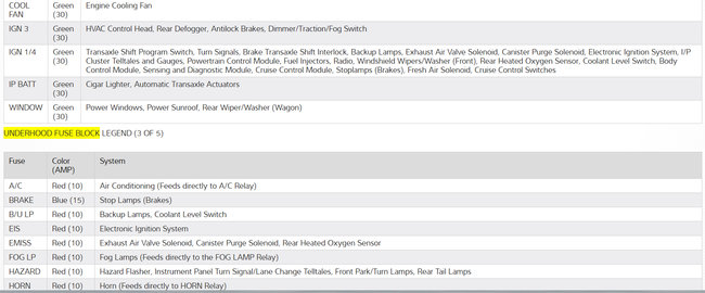

I would like to know if you have the owner's manual? I did not know there was a fuse box inside the car. I do not know what function each fuse has. I looked for the manual on the Internet but I found it.
Jan 28, 2019 at 4:23 PM

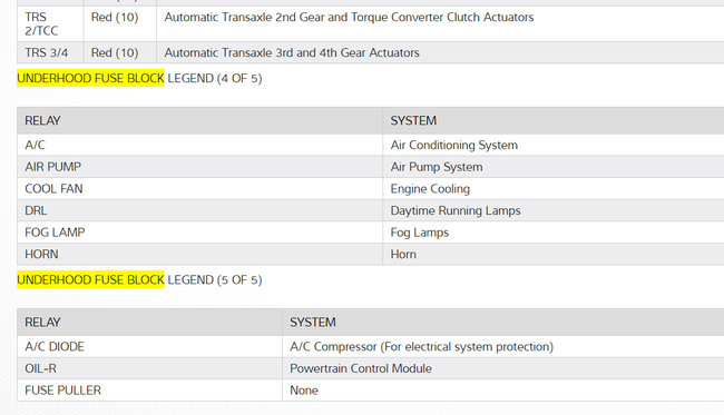

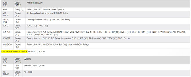

Yes, I have the fuse panel location below and the fuse identification. Here is a guide to help test for power at the fuse:

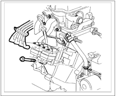

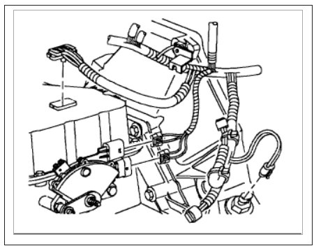

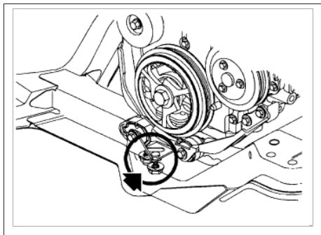

I have an idea. I remembered that a turbine (input) sensor can cause this issue. Here is its location. Check out the diagrams (below). Please let us know what you find.
Jan 30, 2019 at 10:12 AM

Oh sorry, the turbine sensor is the input speed sensor. Let me know.

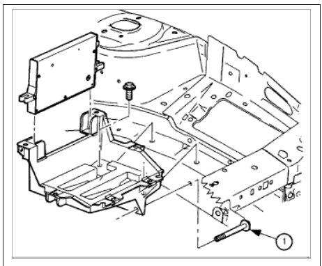

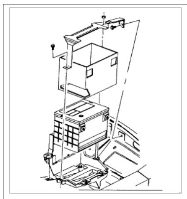

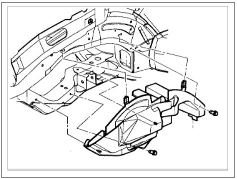

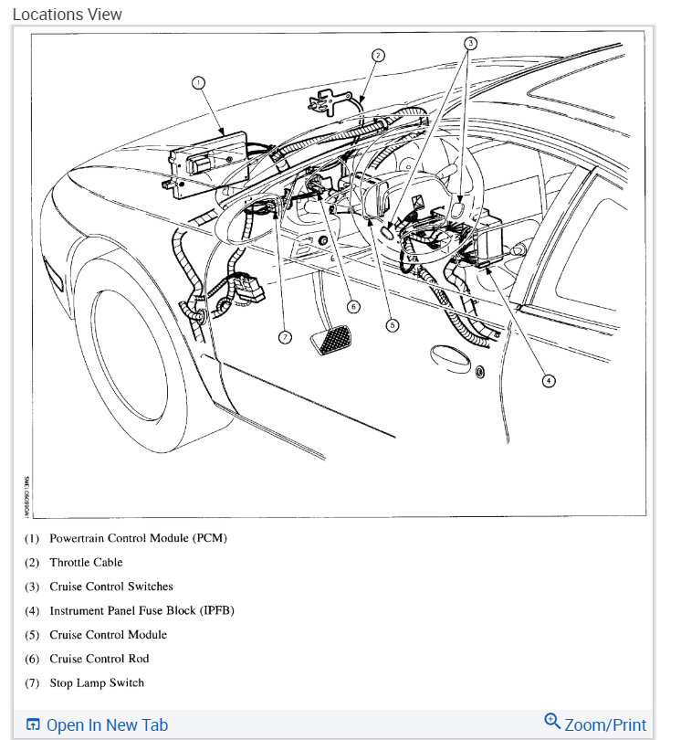

If you checked all wiring it sounds like the PCM is bad lets try a used or rebuilt unit to save some money. Here is the location. Check out the diagrams (below). Please let us know what happens.
Feb 5, 2019 at 10:11 AM

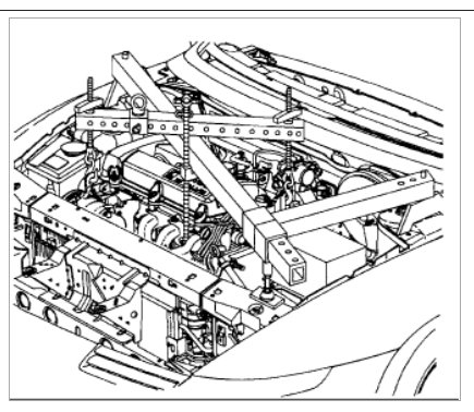

I'm going to change the transmission, can you give me a recommendation to replace it?
Feb 26, 2019 at 7:24 AM

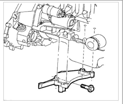

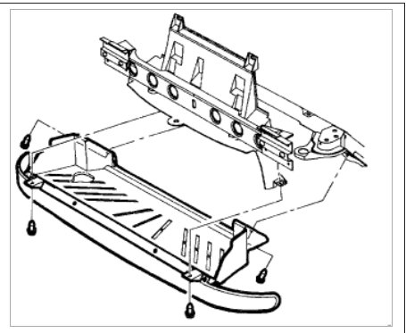

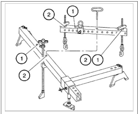

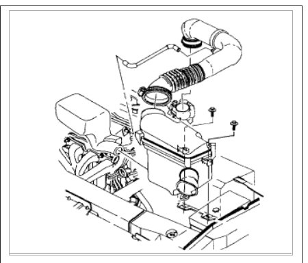

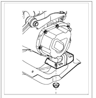

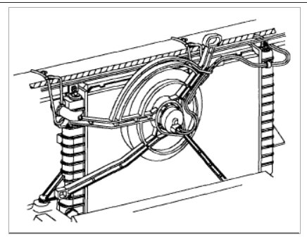

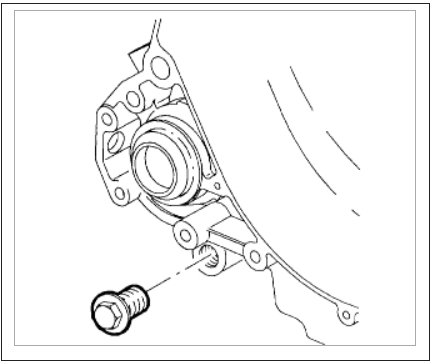

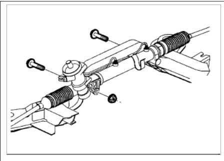

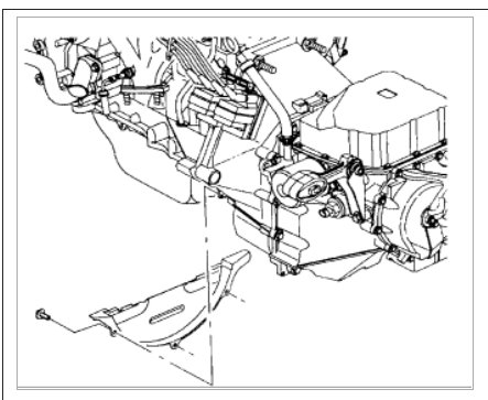

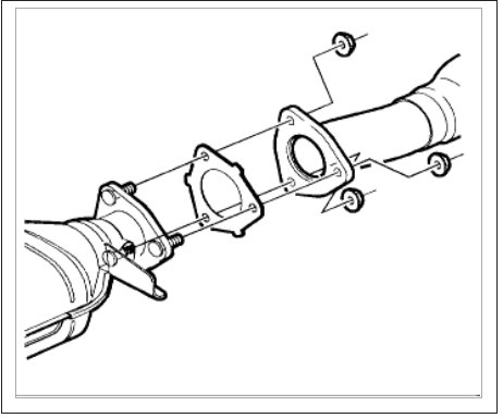

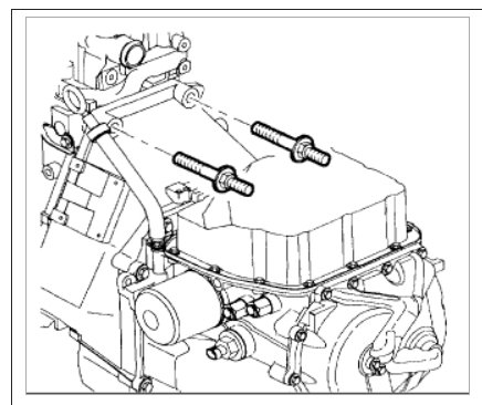

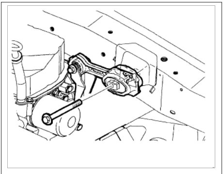

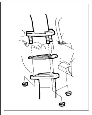

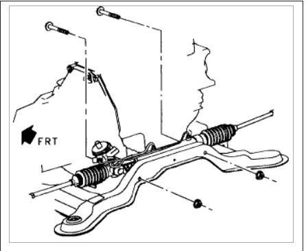

Yes, start by watching this video which will walk you through the steps, it's not the same car but the process is the same. Also check out the diagrams below to see instructions and diagrams for your car.
