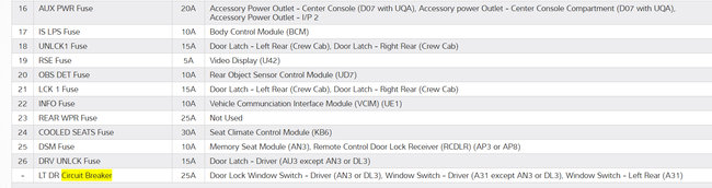

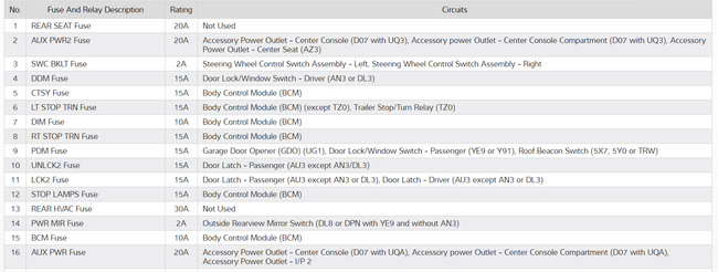

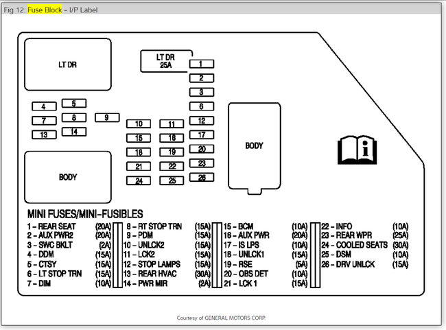

Lets check for power at the BCM fuse in the interior fuse panel. here is a guide to help and the fuse location a well:

okay, do you have power at the BCM fuse did you use a test light?

Yes, there is power and ground. And I did a continuity test on the wires.
