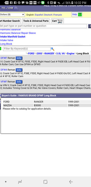

This is what I see for vehicles that work.

As Saturntech9 shows, it is not just that the engine is the same family that was used in other vehicles. As you surmised there are multiple differences in the engines. Some are minor, maybe a dipstick was moved from side to side, others can be an instant problem. Like they changed the control system used and the replacement engine cannot talk to the rest of the truck.
Looking at Hollander it looks like Late production (after 9/99) 1999 and 2000 Vin V engines from Rangers and B3000s are drop in units.

SATURNTECH9
  • 30,869 POSTS
I am going by Rock autos catalog they have a awesome fitment catalog. that is what issues to help answer questions on this site.

I have Hollander interchange data as well. It shows a long block as the same from 1999-2001, but the complete engine uses different numbers due to the flex fuel option.

Yeah, it is a long block listing from rock auto all the bolt on stuff is easily swap able from the old engine.
