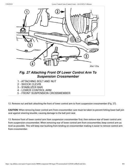

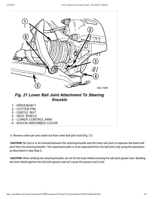

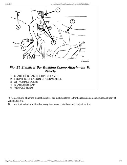

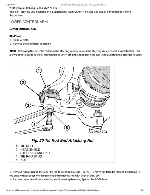

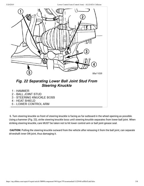

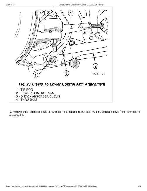

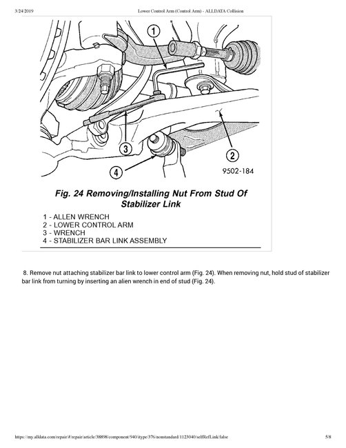

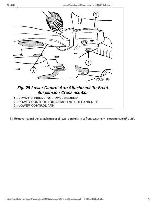

I have attached to this message the instructions for removing the lower control arm, installing should always be the reverse of removal. This might give you an idea of what needs to be done to get the knuckle to move.

Hi Joe, thank you for your quick response! I will try using the wrench to pull joint stud closer. Here is a quick run down of what I tried prior to asking for help:
Removed old control arm and installed new LCA with all nuts and bolts but unable to insert ball joint to knuckle. So I:
1) Removed tie rod from steering knuckle.
2) Removed bolt from front mount.
3) Detached stabilizer bar and removed thru bolt for clevis.
4) Rear mount has bolt and nut and is tightened therefore only thing holding control arm in place.
I have a few questions. First, should I loosen the rear mount bolt and nut?

Loosen off the that rear mount nut and bolt first. Then fit the control arm into the front mount on the sub-frame. Start the bolt for the front mount but do not tighten. Then lift the lower arm, line up the ball joint stud and start the nut. You should then be able to line up the bolt hole with the clevis and attach the shock. Also reattach the sway bar.
