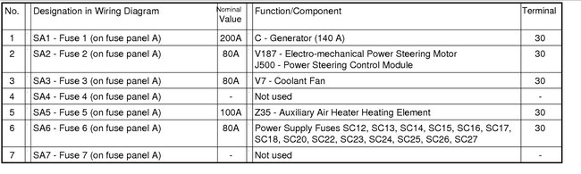

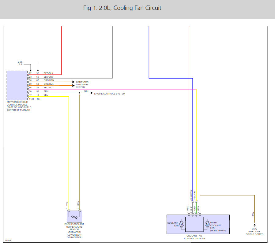

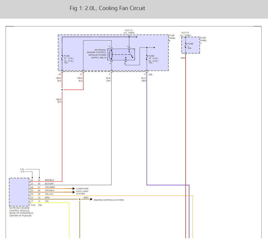

The fan does not run all the time unless the air conditioner is on. It is regulated to only come on when the temperature is above normal and that will only happen in slow traffic situations. Here is a wiring diagram so you can test the fan motor to see if it is working.

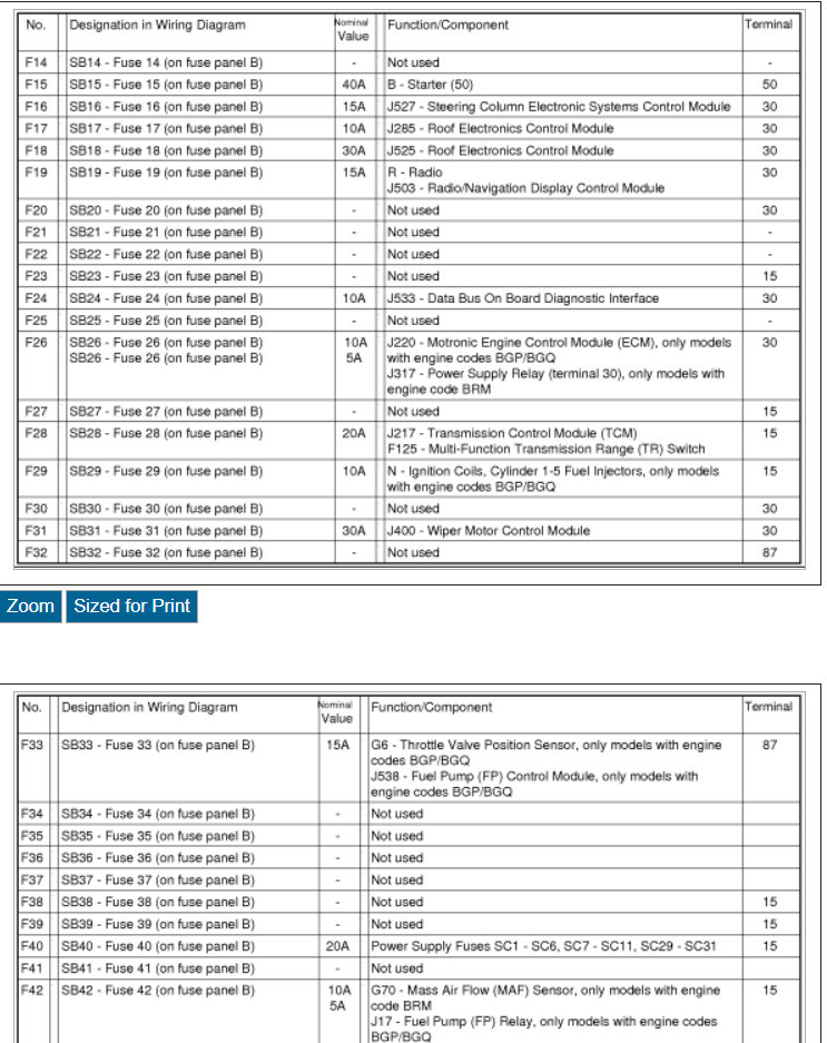

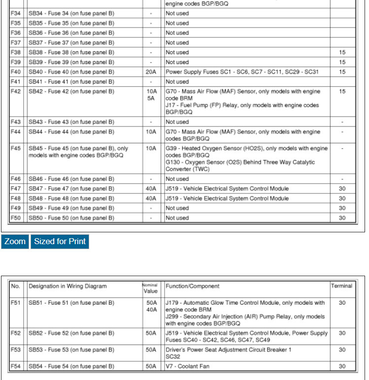

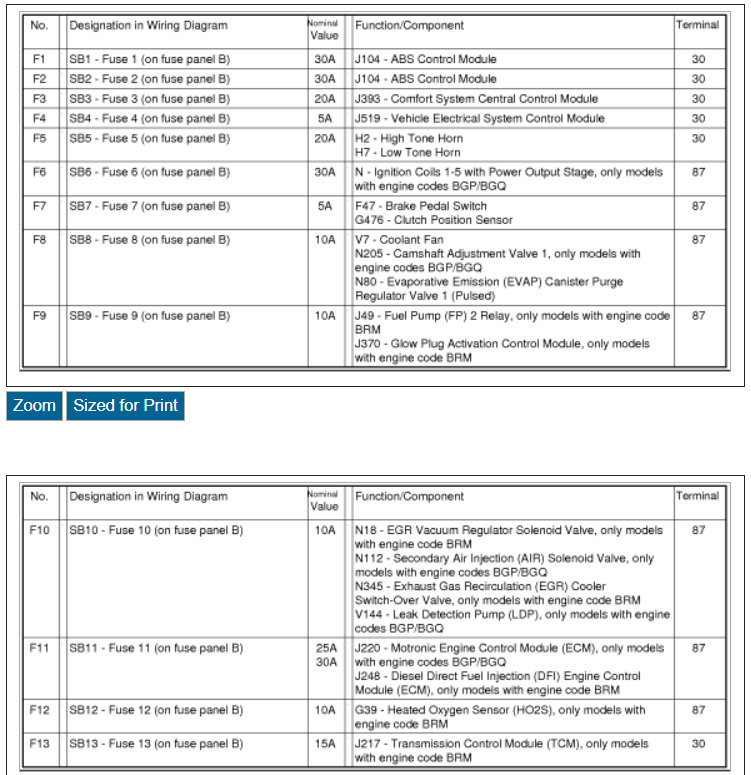

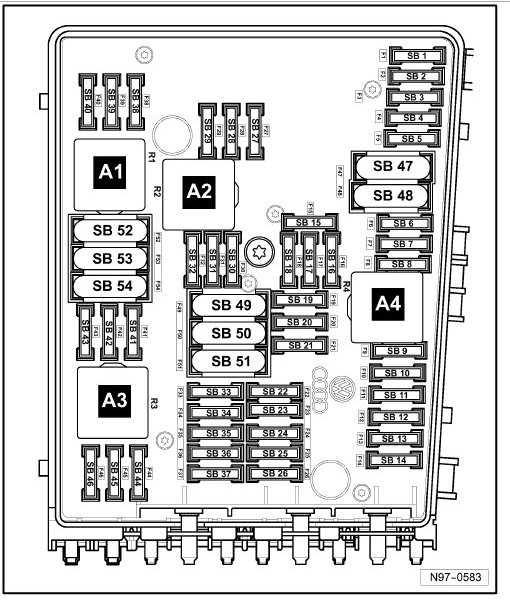

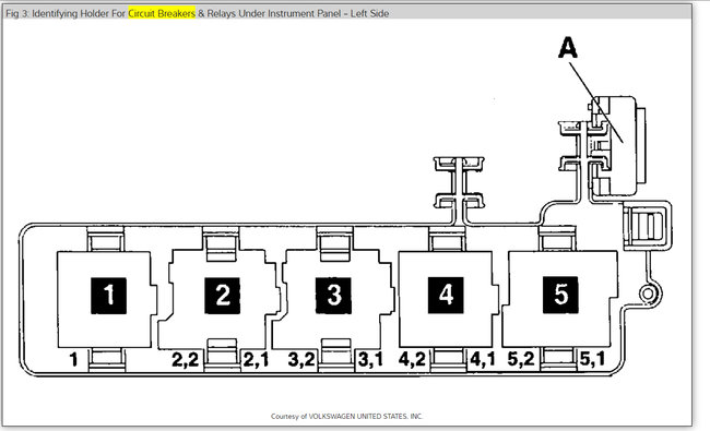

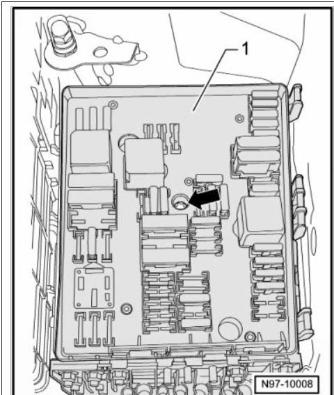

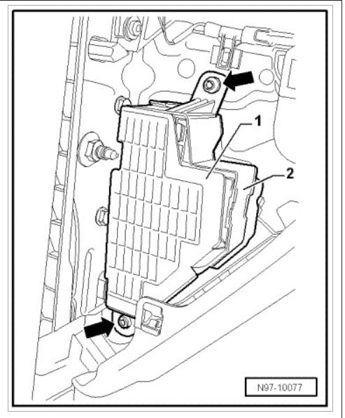

Also check fuse #38 and #3 this powers the fans.

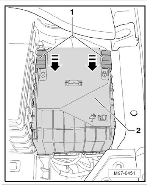

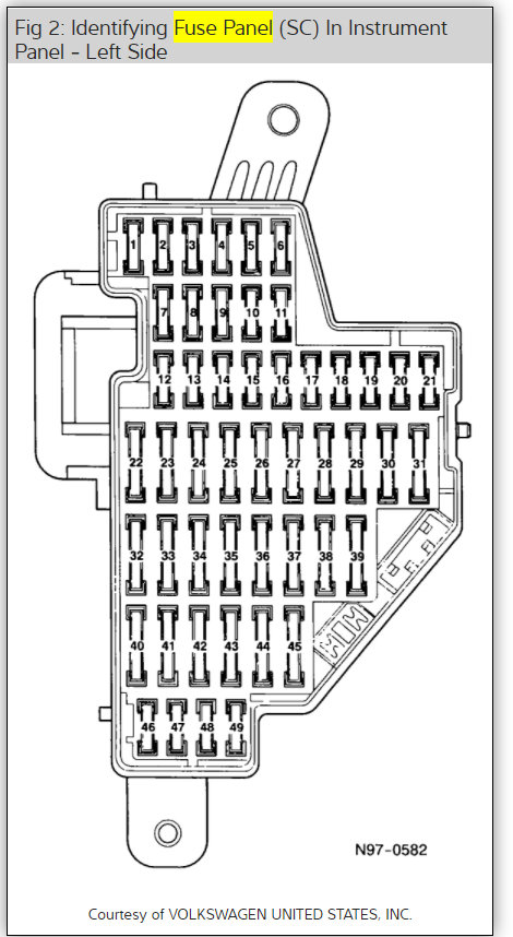

Here are the fuse panel locations.
Jan 17, 2018 at 4:31 PM
