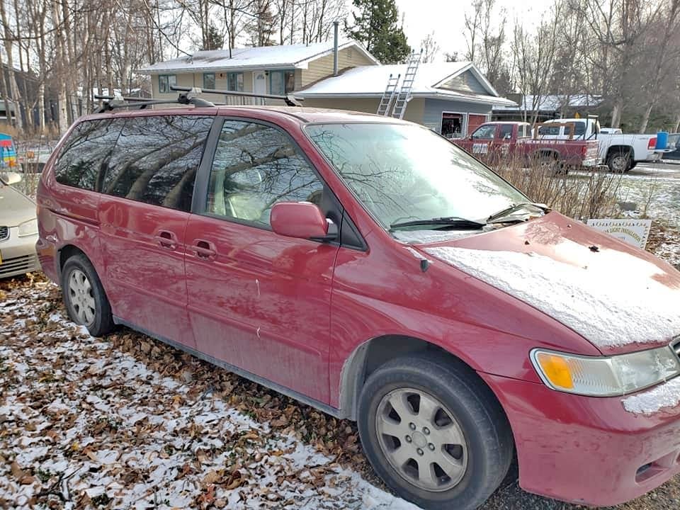

How much would it cost to fix a used vehicle listed above EX Minivan 4D?
- Electric sliding doors don't always work. Not to big of an issue if I can manually open/close them.
- Engine rpm's currently dip slightly while idling but drives smoothly. May need new spark plugs and/or ignition coils.
- Shaky occasionally. Probably needs to align tires I'm guessing?
- Starts misfiring randomly at 45+MPH.
