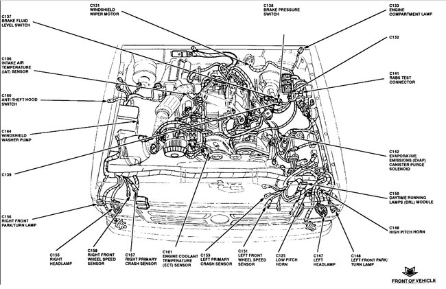

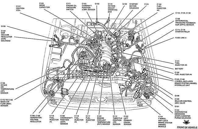

Do you have fuel pressure at the fuel rail? In the diagrams down below I have included factory directions on how to test the fuel pressure on your vehicle. If you are very careful, you can turn your vehicle's ignition key to "run", not "start", for 5 seconds and then with a finishing nail, or something similar, quickly press the little pin in the middle of the fuel pressure relief valve for a split second only. If your vehicle has fuel pressure, fuel will spray out. Be careful when doing this as gasoline is extremely dangerous and flammable. Please get back to us with what you find out and we can go from there.

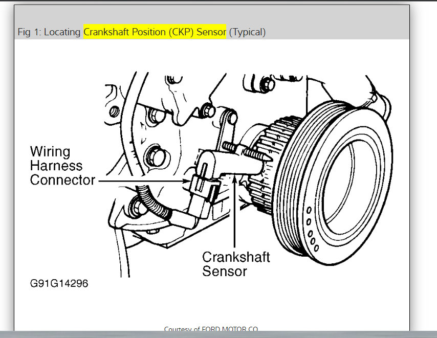

Okay, that's good. This could be a problem with your vehicle's Crankshaft Position Sensor(CKP). In the diagrams down below I have included the instructions for the removal and installation of your vehicle's CKP. Please go through this guide and get back to us with what you are able to find out.
Thanks,
Alex
2CarPros
Jul 28, 2019 at 8:37 PM
TREYHAWKINS
I just installed a new crankshaft position sensor today and it still cranking over but still will not start.

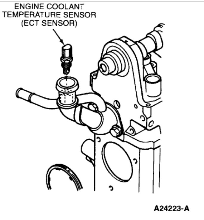

This sounds like a classic engine coolant temperature sensor issue or you have a vacuum leak.
Here are two guides to help us figure out which is the problem:
and
https://www.2carpros.com/articles/coolant-temperature-sensor-cts-replacement
If the coolant sensor is not responding it will not give a trouble code.

Below is the location for your car.
Please run this test and get back to us.

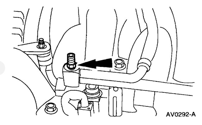

It sounds like you have a vacuum leak can you go over this guide to see what you find?

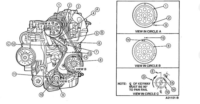

Good morning,

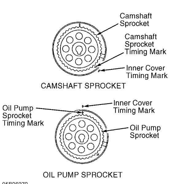

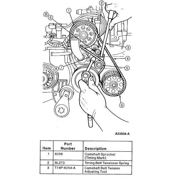

Yes, It could be the timing belt. A compression test will confirm if the timing is off. You should have around 125.140 lbs of compression.
I attached a diagram of the belt for you to check and see if the marks are aligned.
REMOVAL
1. Remove spark plugs.
2. Align crankshaft so number one piston is at TDC (top dead center) as indicated by timing marks.
3. Remove outer timing belt cover.
4. Loosen timing belt spring pivot bolt. Do not remove.
CAUTION: If you attempt to remove timing belt or adjust tension without loosening both timing belt tensioner adjusting bolt and spring pivot bolt, you will break Camshaft Belt Tension Adjusting Tool T74P-6254-A when you attempt to relieve tension on belt.
(Part 1 Of 2)
(Part 2 Of 2)
5. Hold tensioner with Camshaft Belt Tension Adjusting Tool T74P-6254-A.
6. While holding tensioner, loosen adjusting bolt and gradually release spring tension.
7. Using adjusting tool, rotate tensioner, against spring pressure, as far clockwise as possible. While holding, tighten adjusting bolt to hold tensioner away from belt.
8. Remove timing belt.
(Part 1 Of 2)
(Part 2 Of 2)

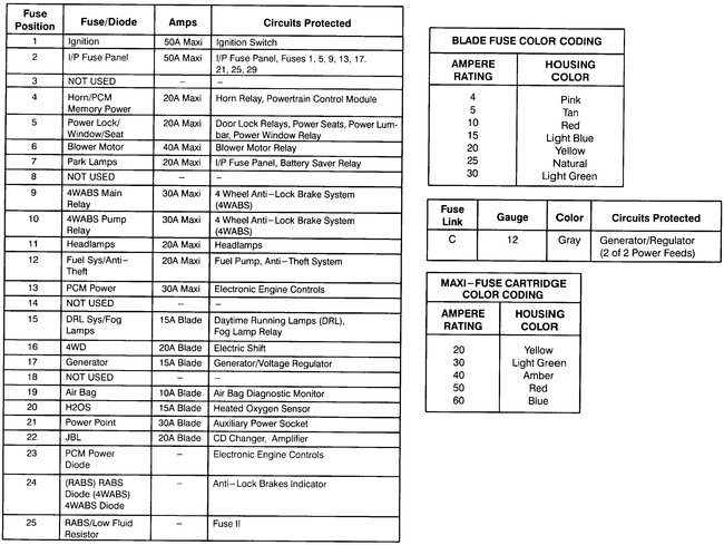

My 96 ford ranger has stopped starting. I replaced the #23 fuse while the truck was running and upon doing so the truck quit running. I have checked all the other fuses. Did notice that I am no longer getting fire from my plugs. The timing belt looks fine and have also replaced the coils. Will turn over but wont start. Really appreciate any help. Cant really afford to take it in.
Mar 2, 2021 at 5:29 PM (Merged)
Hi mojo_7733, Welcome to 2carpros and TY for the donation
No snapping blue spark continue to troubleshoot the ignition system-power input to the coil/coil packs,coil's resistances,distributor pick-up coil, ignition control module, cam and crank sensors and computer Note: If it doesn't apply disregard it
What did the #23 fuse cover? Also, have you checked the crank sensor? Are you getting power to the coil? Also, pop the distributor cap off and make sure the rotor is turning when the engine is cranking.

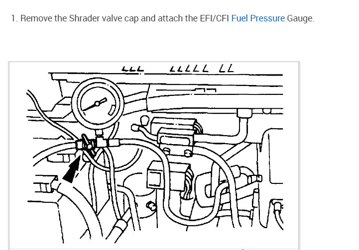

I went to the local AutoZone and rented a fuel pressure test kit, $149.95 deposit, plus tax, BUT, I get it back when I return it. NO RENTAL FEE!
Anyway, I connected it to the schrader valve on the injector rail. It went up to 40 lbs pressure when I cranked the key. It's getting, and holding fuel pressure, but still won't fire up!

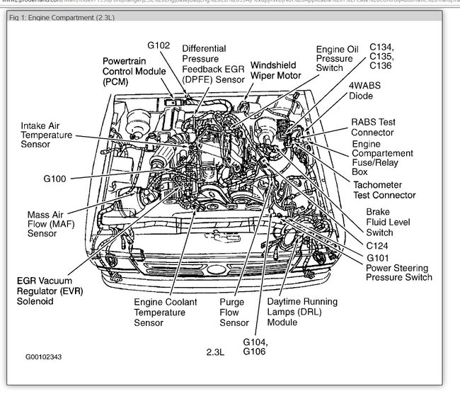

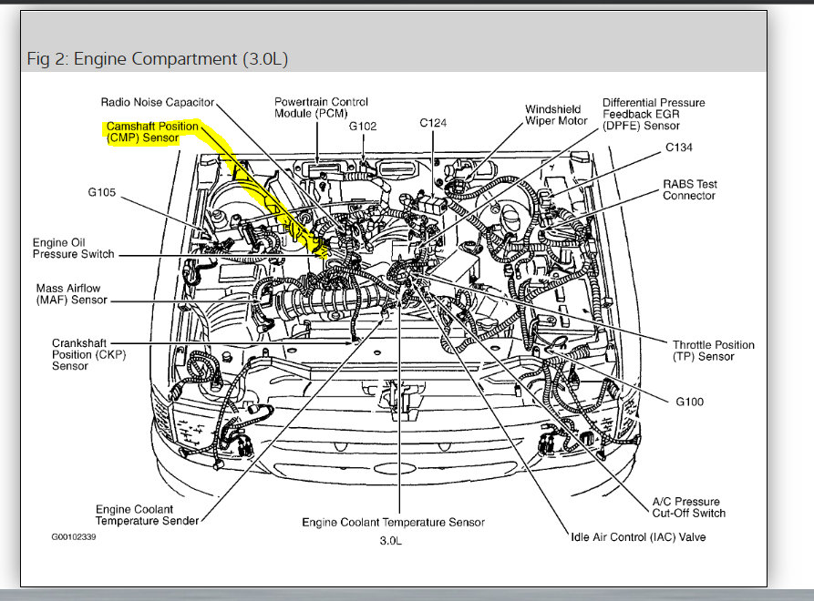

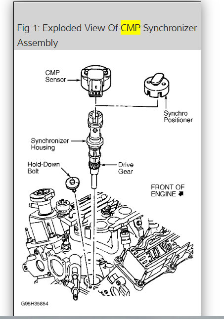

The camshaft sensor is located on left front of engine behind oil pump pulley. Your ICM looks like this below and I dunno where its located been looking into Mit1 and Alldata auto references no exact location-sorry
https://www.2carpros.com/forum/automotive_pictures/12900_icm_8.jpg

The PCM is located in the firewall on the passengers side. Here is a diagram that shows its location.
Please check the timing belt as well.

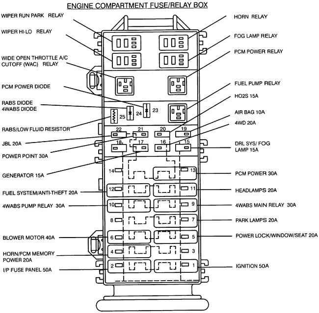

The first thing that comes to mind is a bad electronic engine control relay (EEC). This relay will prevent the fuel pump from coming on as well as shutting off the ignition.
It's been awhile, but I recall several reports of this in the past where the car ran fine, someone would park, come back a few minutes later and it wouldn't start.
With that in mind, here is what I want you to do. The PCM power relay functions the same as the EEC relay on your truck. What I want you to do is this. When the engine refuses to start, switch that relay with a different one in the fuel/relay box that has the same part number and then see if it will start.
I attached a picture of the relay box under the hood as well as a legend of what each component is for.
Do this and let me know if it works. If it does, just replace the relay.

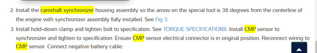

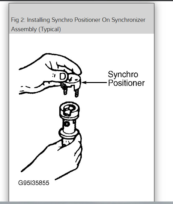

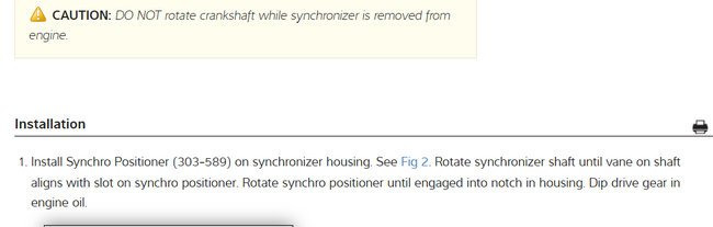

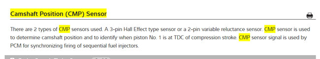

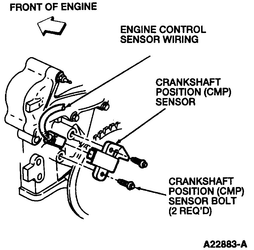

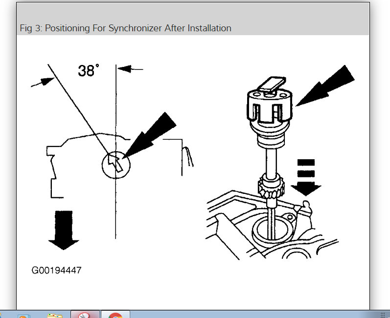

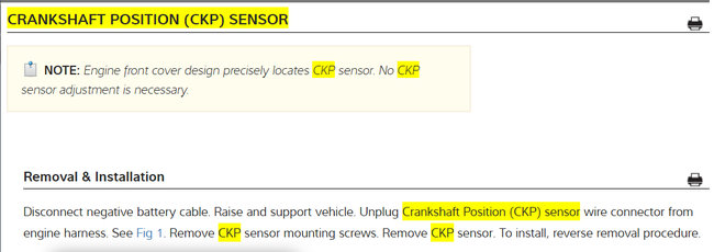

If the EEC isn't the issue, the next suspect is the crankshaft position sensor. Take a look through this link.
The Crankshaft Position Sensor is located at the lower front of the engine. (See Picture 1)
Crankshaft Position (CKP) Sensor
See Picture 2
REMOVAL
1. Disconnect battery ground cable.
NOTE: When battery voltage is removed from the Powertrain Control Module (PCM), all learned values will be cleared and reset to predetermined values. When battery voltage is restored to the PCM, the vehicle may exhibit certain driveability concerns. It will be necessary to drive the vehicle to allow the PCM to relearn values for optimum driveability and performance.
2. Disconnect Crankshaft Position (CKP) sensor electrical connector.
3. Remove two CKP sensor screws and remove sensor.
INSTALLATION
1. Position CKP sensor on engine .
2. Install two CKP sensor screws and tighten to 4-7 Nm (35-62 Lb in).
3. Route CKP sensor wiring harness and connect electrical connector.
4. Connect battery ground cable.
