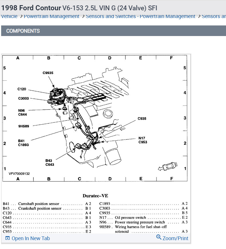

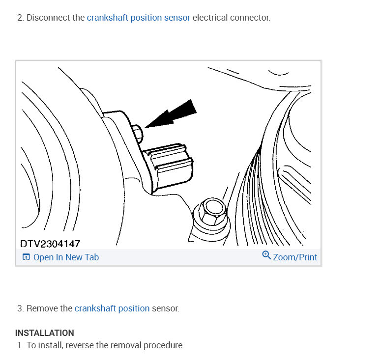

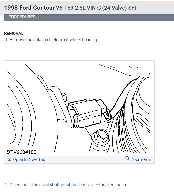

The crankshaft position sensor is down in front of the engine near the front balancer. Below is the location and the replacement instructions in the diagrams. Check out the diagrams (below). Please let us know if you need anything else to get the problem fixed.
