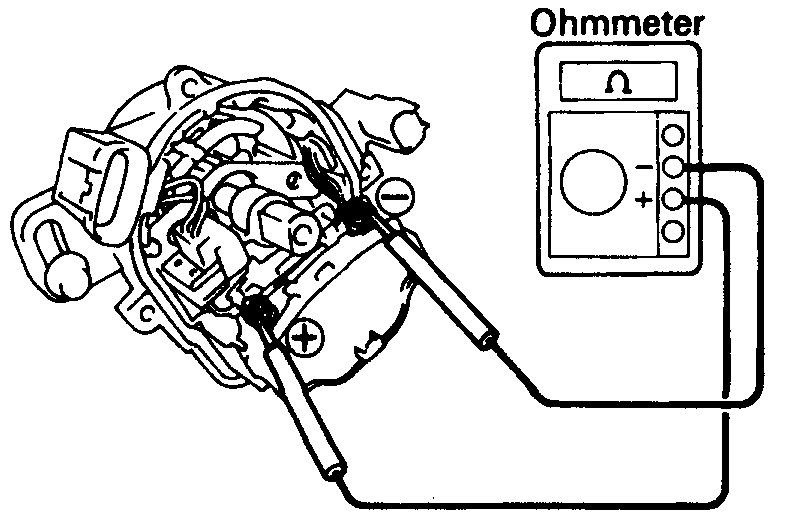

5. Inspect primary coil resistance.
-Using an ohmmeter, measure the resistance between the positive (+) and negative (-) terminals.
Primary Coil resistance:
Cold: 0.36 - 0.65 Ohms
Hot: 0.45 - 0.65 Ohms
^ If the resistance is not as specified, replace the ignition coil.

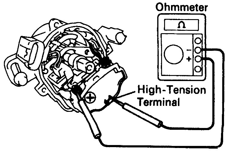

6. Inspect secondary coil resistance.
-Using an ohmmeter, measure the resistance between positive (+) and high-tension terminals.
Secondary coil resistance:
Cold: 9.0 - 15.4 k Ohms
Hot: 11.4 - 18.1 k Ohms
^ If the resistance is not as specified. replace the ignition coil.

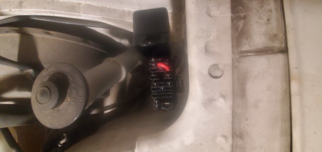

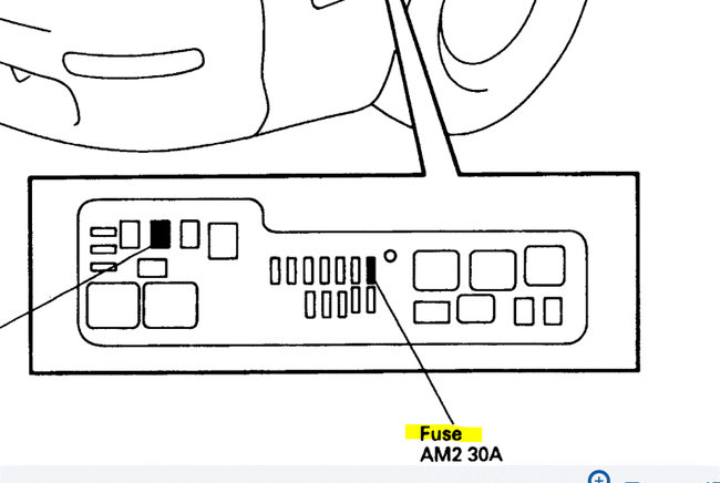

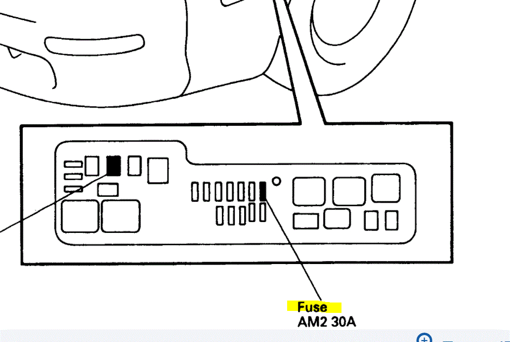

Note: I provided info for a vehicle having Federal Emissions. If you are in CA, I need to know.
If you are in CA, check the fuse indicated in pic 3.

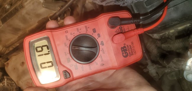

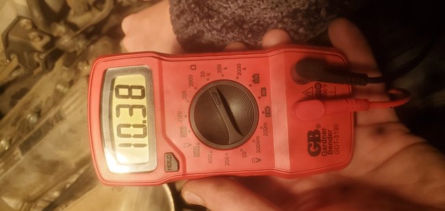

I just preformed the checks and these were my findings:
Primary coil resistance: 1.9.
Secondary coil resistance: 10.38k.
Both checks were performed in cold weather. To be clear does this mean that I need to replace the ignition coil?

It sounds like the primary circuit is bad. This sounds like the problem.

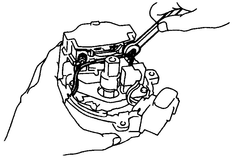

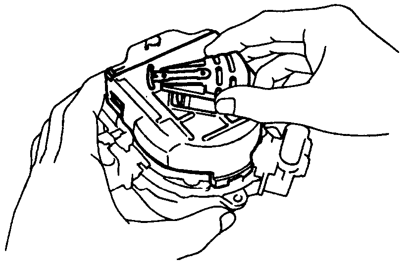

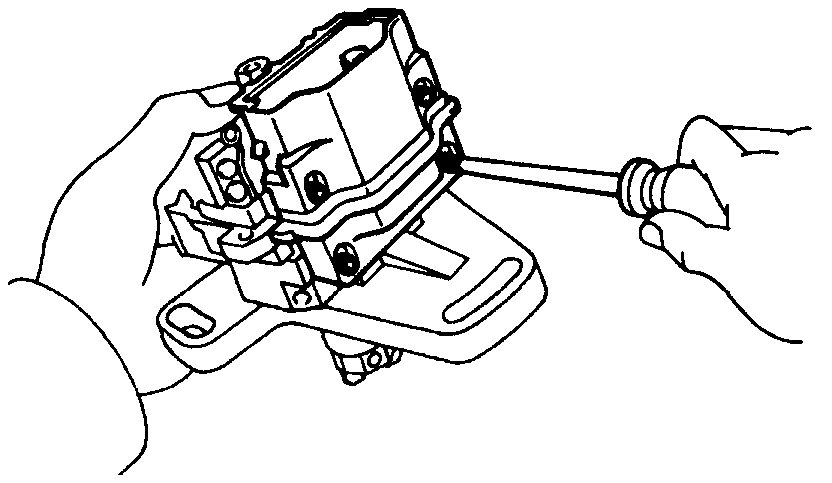

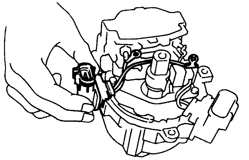

I don't know if you need them but here are the directions for removal and replacement. The pics attached correlate with them

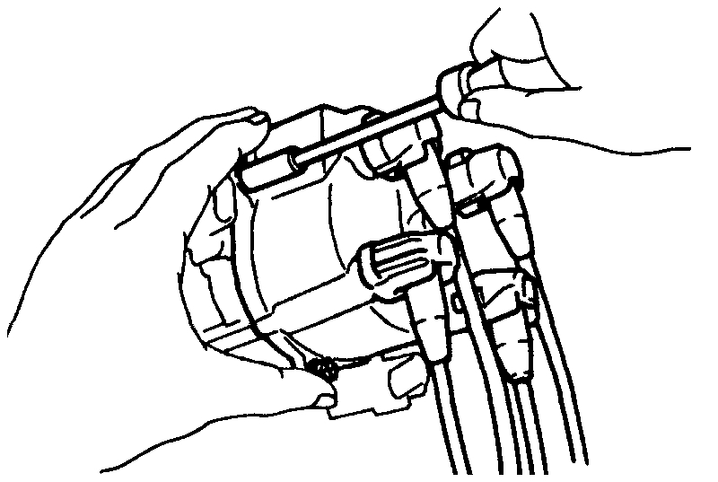

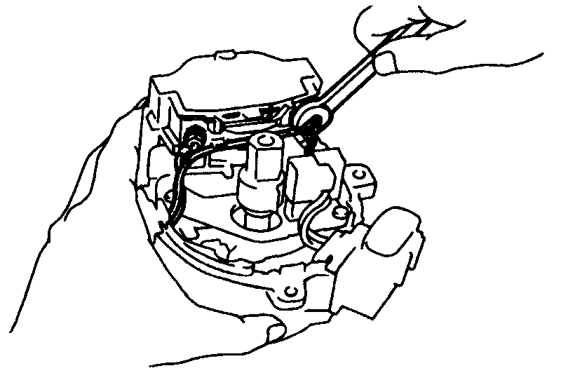

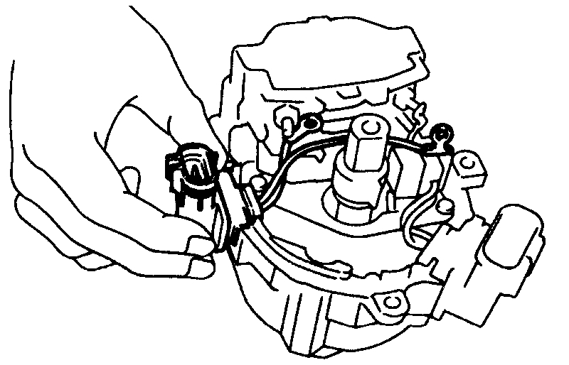

DISTRIBUTOR DISASSEMBLY
1. Remove distributor cap.
pic 1
-Remove the 3 bolts and distributor cap.
pic 2
2. Remove rotor
3. Remove ignition coil dust cover.
a. Remove the dust cover.
b. Remove the packing.
4. Remove distributor wire.
pic 3
a. Remove the 2 nuts, and disconnect the 3 wires from the ignition coil terminals.
pic 4
b. Remove the distributor wire from the distributor housing.
5. Remove ignition coil
pic 5
Remove the 4 screws and ignition coil.
