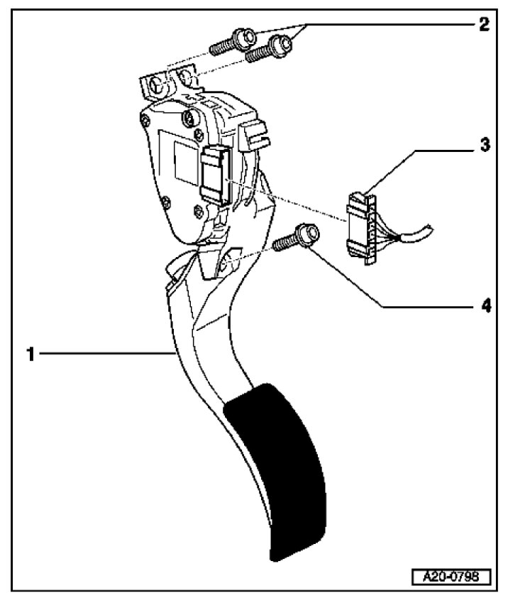

It sounds like you have an accelerator pedal position sensor that has gone out. Can you tell me if there are any codes that are stored when the scanner is connected? Also, will the engine run on starting fluid? Here is how to replace the accelerator pedal position sensor in case a code comes up for it:
https://www.2carpros.com/articles/car-not-running-advanced
and
This guide may help out as well. Check out the images (below). Please let us know how it goes.

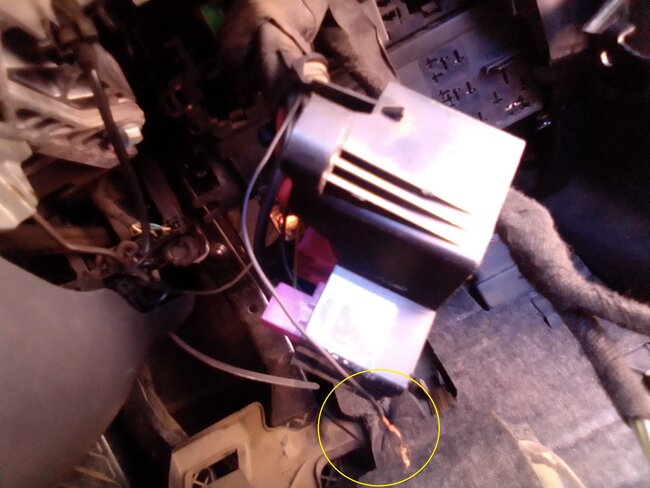

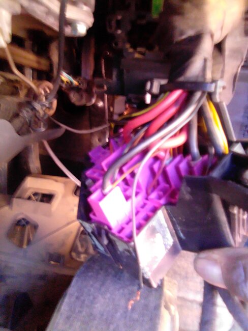

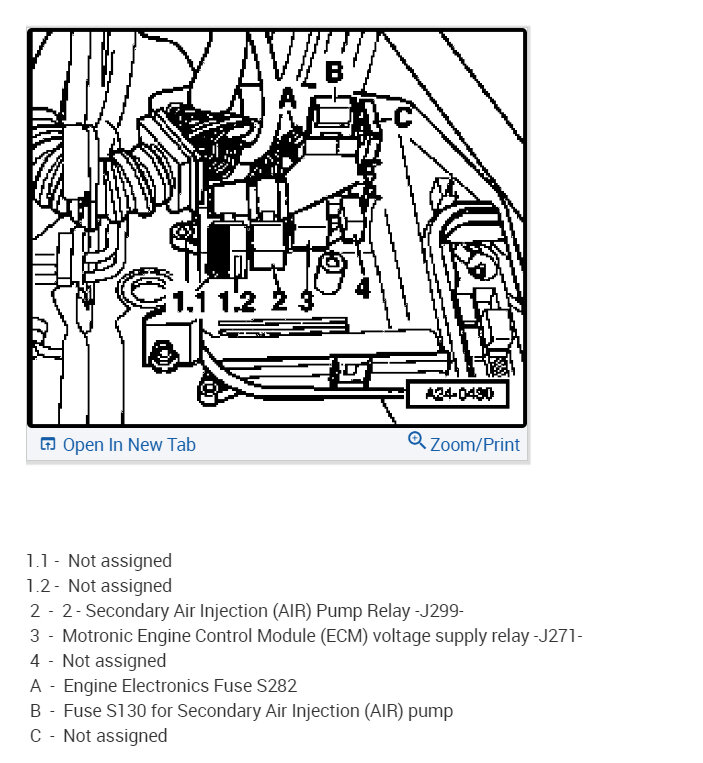

Hi Ken, quick feedback. I have inspected all the fuses; they seem fine after testing them with a multimeter. Although I have noted that there are some fuses missing - especially near the steering column. The horn relay is missing; the fuse amp 40 in the engine bay was incorrectly placed on F51 slot, instead of F52 which, according to the diagram, is the secondary air pump (SAI) so this was fixed and placed at F52. Removed the ECO and inspected the wiring for corrosion the back connectors are completely clean without signs of water damage or corrosion. I wouldn't be sure about the internals though, but the wiring to and on the pin connectors seem completely unravaged.
Removed and inspected the instrument cluster, all cables seem fine without any shorting, completely clean and no corrosion.
After removing the cover below the steering wheel, i noticed some cut wires that are leading to the fuse box and I'm not sure whether these came with the car like these, or they were meant to lead somewhere. (i have attached picture). Also inspected the steering angle sensor and one wire was slightly cut, it seems and reconnected not sure why. i have tightened the sensor to make sure it's not loose.
I haven't attempted to start the car because I'm still waiting for the new thermostat and housing, replacement of missing fuses and horn relay.
Lastly, I have noticed now after reconnecting the ECU, when ignition is switched on, the cooling fan begins to run i wonder what this means...
Oct 14, 2023 at 7:44 AM
I don't see the picture. I would replace all missing fuses and relays to start, then repair the wiring. Once that is done clear the code and re-run them. Please let me know.

Thanks Ken, I reattached both pictures. Perhaps you might have an idea about where these should be leading?
Oct 16, 2023 at 3:15 AM
Not really, try to look around to see inside the connector for an open terminal. Is there any other loose wiring around?

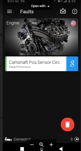

Found that the cable to the camshaft position sensor (connector) was corroded- fixed

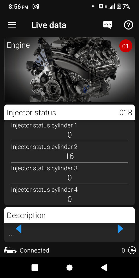

primed enough fuel and removed bubbles and car started. The result is that its idling rough, more like misfiring. I have cleared all the errors, but the camshaft fault seems coming back.
Another worrying factor is that when analyzing live data from obdeleven, on the 'Injector Status' channel, it seems as if the only responsive injector/cylinder when revving the car is Cylinder 2. The other three don't present any values at all. Please also note that the 'three' PD injectors installed have not been coded/adapted - not sure if this is the issue. But here's an attachment of the screenshot of the channel.

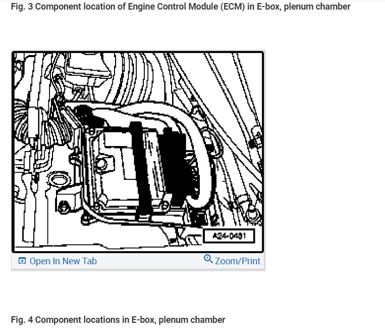

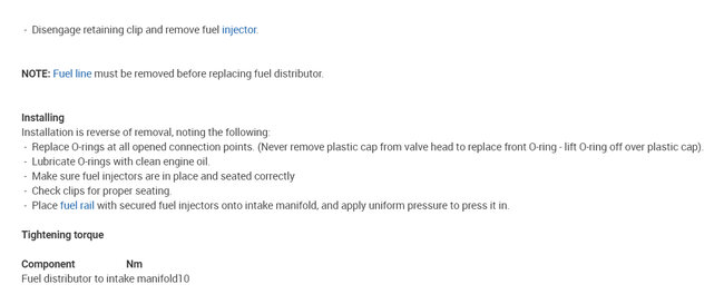

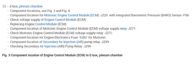

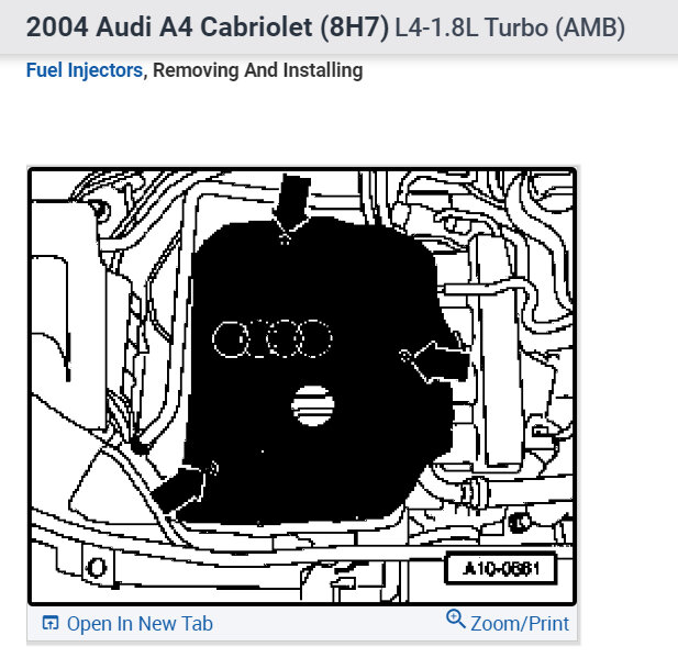

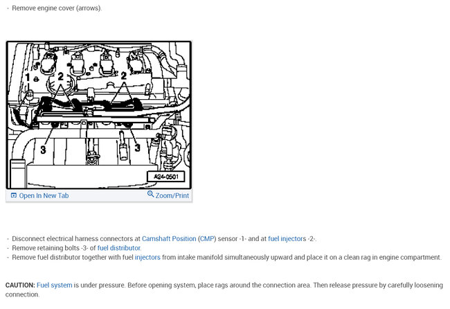

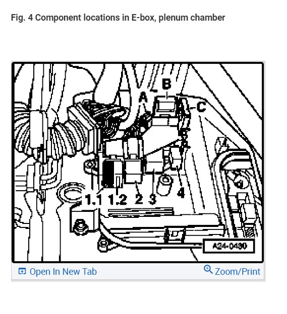

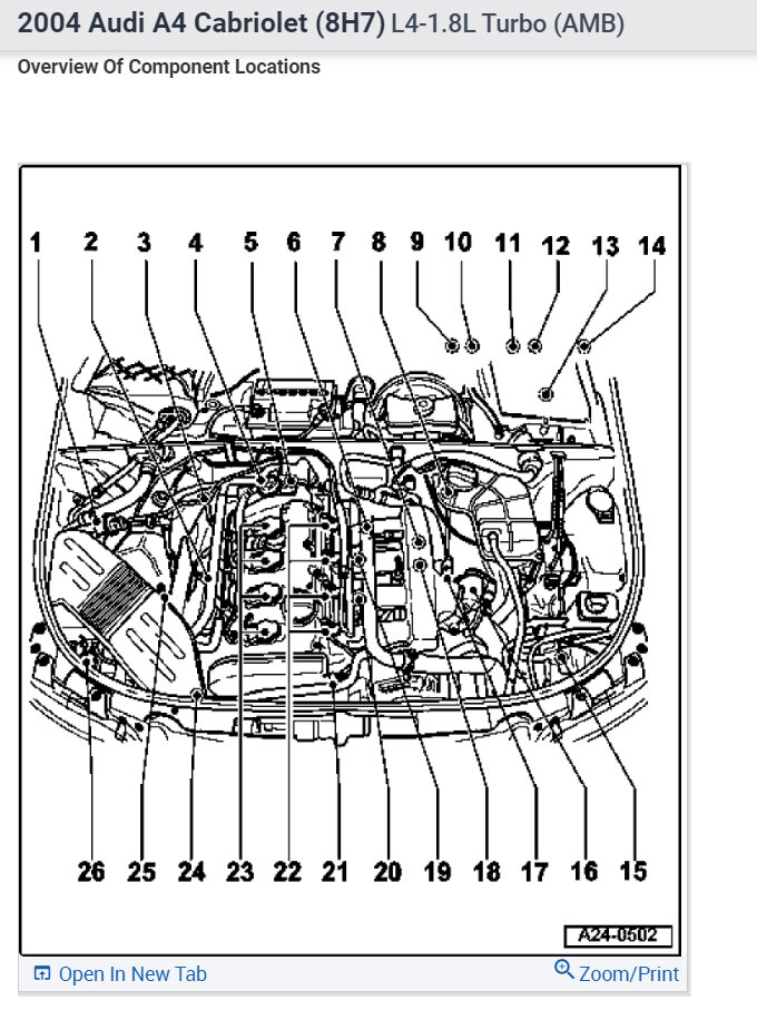

This can be caused by a fuel injector that is shorted or you have a bad PCM.
Here is a guide to help you test the injectors and how to change out the PCM in case the injectors test okay:
https://www.2carpros.com/articles/how-to-test-a-fuel-injector
I have left the location and instructions on how to change out the PCM, you can get a preprogrammed unit by searching Google or Ebay. Check out the images (below). Let us know how it goes.

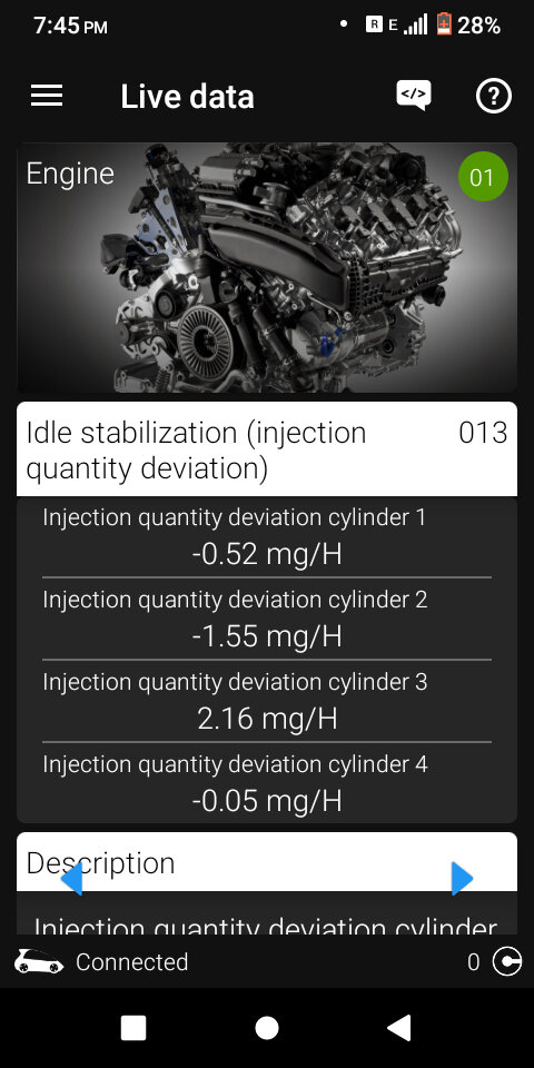

Ken, here once again. I have just discovered that the above screenshot of the obdeleven on the Injector Status with the value 16 has to do with a faulty injector on cylinder 2. What do you think? I will have to then replace it and get some values on the injector quantity deviation to see how much they spray.
Nov 14, 2023 at 12:18 PM
Yep, a bad injector can cause this problem, let me know what you find after the fuel injector test.
Nov 16, 2023 at 9:58 AM
SAPHHIRE
  • 10 POSTS
I have run the injector idle test and still running rough though. As promised, I have attached the screenshot of the injector idle values. Please let me know your thoughts on the values. I could suspect cylinders 2 and 3 but i could be wrong.
Nov 17, 2023 at 10:47 AM
I would remove the electrical connectors from the injectors and use a voltmeter to test the Ohms across all injectors and report back please.
