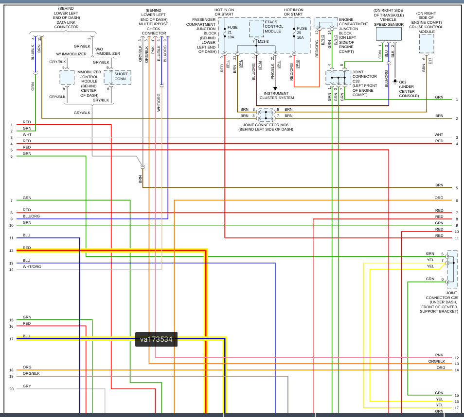

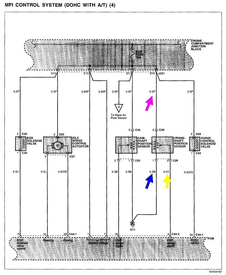

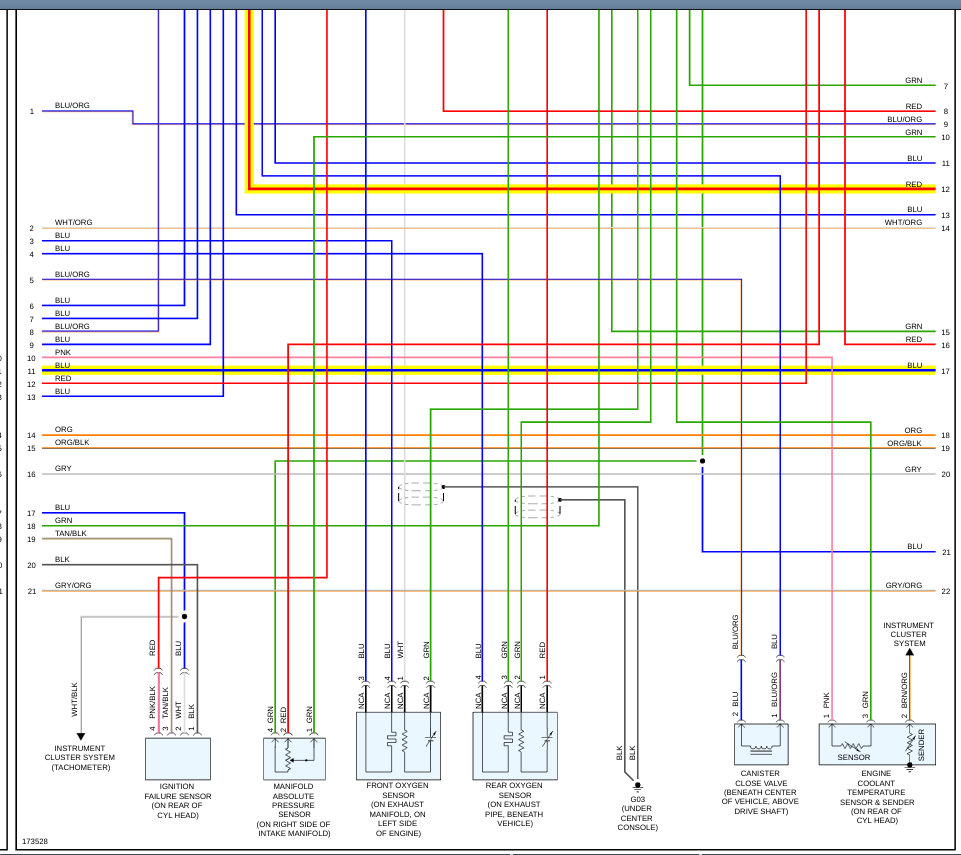

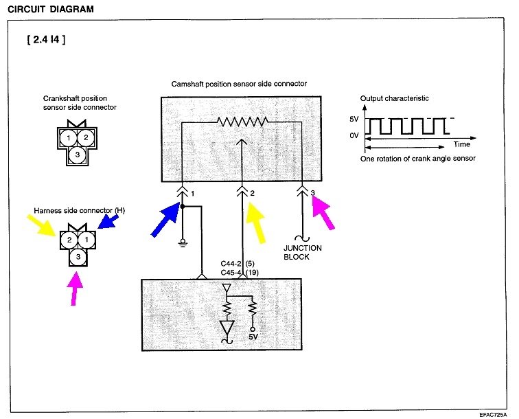

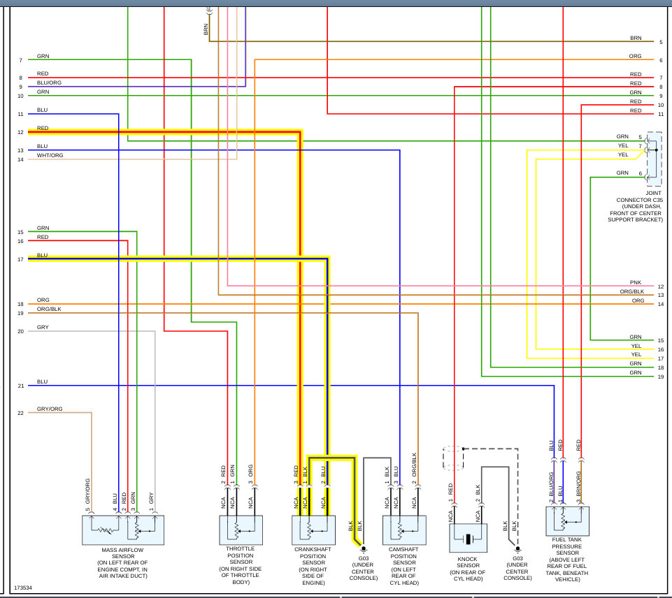

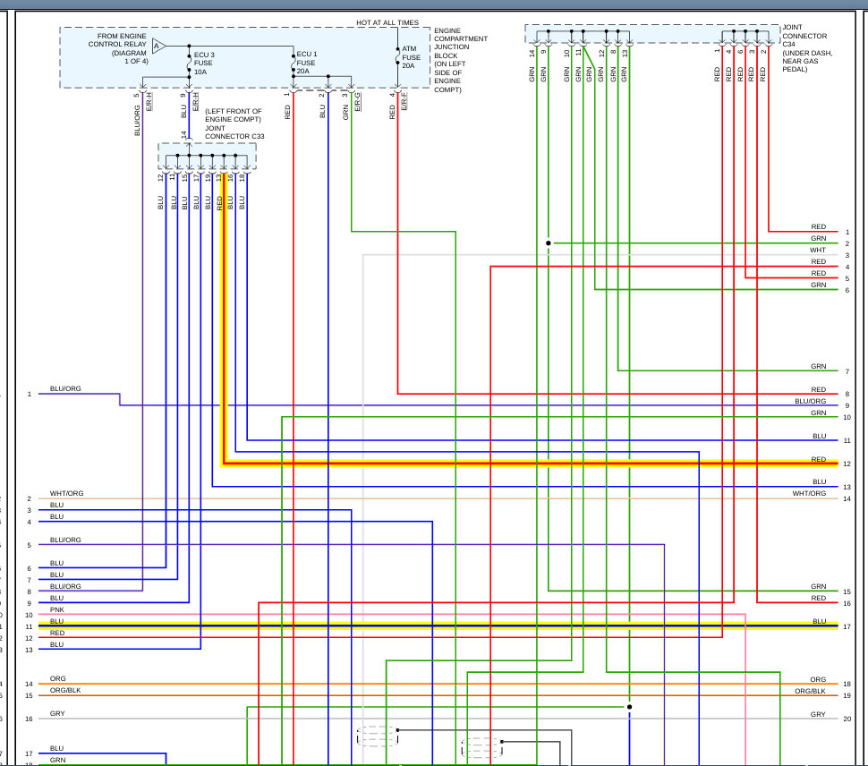

The wires on the connector came out. so I need the wired specs as to what wire to where?
Jan 27, 2020 at 2:46 PM
SCGRANTURISMO
CERTIFIED EXPERT
4,897 POSTS
In the diagrams down below I have included the engine management wiring diagrams for your vehicle with the Crankshaft Position Sensor wires highlighted for you. Please go through these wiring diagrams and get back to us with how everything turns out.

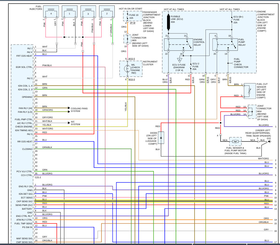

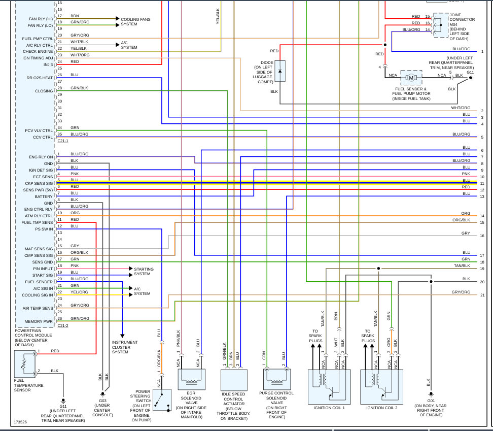

Here's the diagram showing the wire colors and connector terminal numbers. The second one shows the terminal layout.
