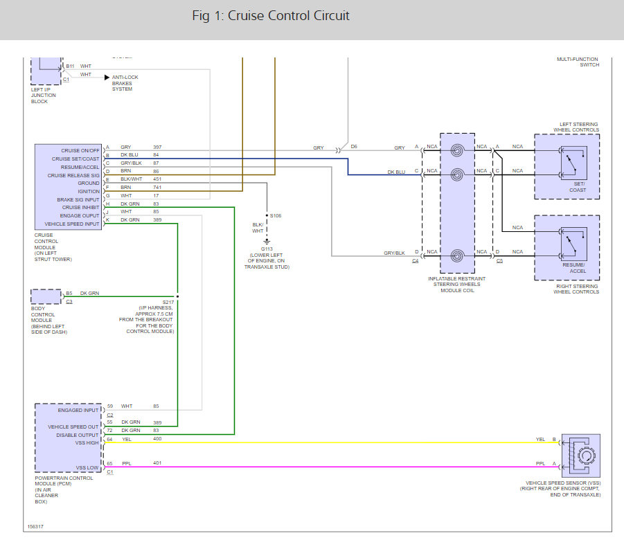

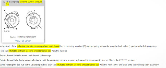

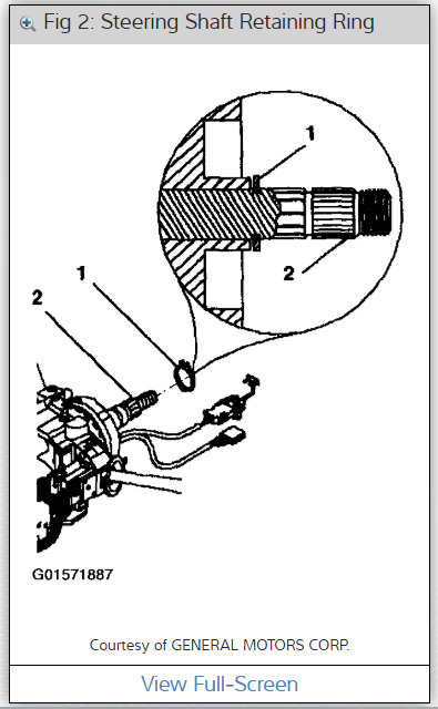

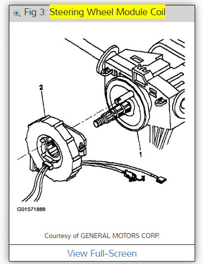

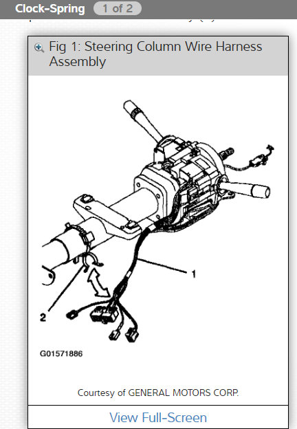

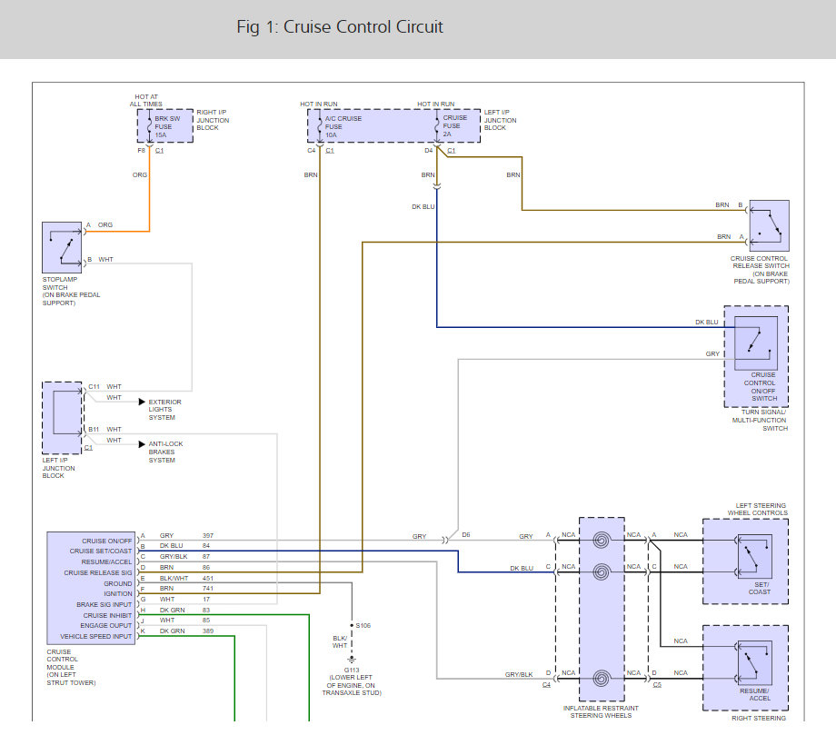

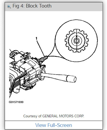

As far as the cruise control it sounds like the clock spring behind the steering wheel is going bad which will cause issue you have. To be sure here is a guide to help you check the wiring with the wiring diagrams of the cruise control so you can see how it works and how to replace the clock-spring if confirmed:
https://www.2carpros.com/articles/steering-wheel-clock-spring-removal
and
Check out the diagrams (below). Please run this test and get back to us.
