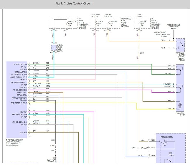

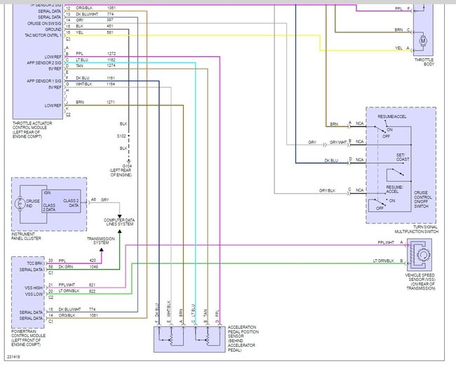

Hey Guys. The cruise control stopped working a year ago so I replaced the fuses, brake light switch and steering column wiper/turn signal/cruise lever. It did not fix the cruise. And there are no codes when I check with the code reader. This weekend I hooked up a U-Haul trailer to move some stuff and the cruise control worked again all day while the trailer lights were plugged in. I used a 7-pin adapter to plug the 4-pin U-Haul lights into. After I disconnected the U-Haul the cruise stopped working again. I plugged in the 7-pin adapter thinking that may have had something to do with the cruise coming alive, but no luck. Is there some type of load sensing switch that controls the cruise control under a load? I am stumped! Thanks
