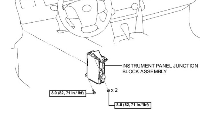

You may have corrosion on the electrical connector @ the BCM as well, I have seen that cause the issue as well FYI, disconnect the 12 volt battery first. Here is the location of the main body ECU. Check out the images (below). Please upload an image or a short video in your response.
