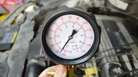

So, upon key on, prime pressure was about 40, but steadily lowered as it sat in on position. pump came on and shut off as expected/normal. Then I started car. Video shows pressure while running. about 1:24 I rev engine and let go back to idle. Then shut down occurs. I did hear the fuel pump slightly before engine began to have issues and heard it approximately three seconds after shut down.

Check to see if you are also losing spark. If you are, the better suspects are the crankshaft position sensor and the camshaft position sensor.

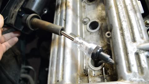

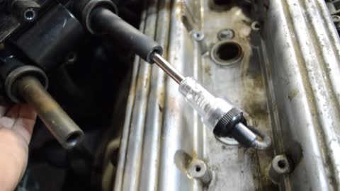

Okay, so did a spark test, well what I think is one. I put an inline tester on and cranked. I did not start it. Tester light up. Also did a test light on ignition module. Light was faint but there upon crank. Do I need to run the spark test while idling to see if I lose spark? That will work for about one plug as it does not run for more than three seconds after first stall.

You need to test for what is missing when the no -start is occurring. If the engine runs, spark, fuel, compression, and proper timing of all those events has to be okay at that time.

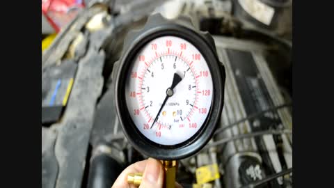

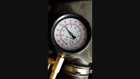

Okay, so below is the pressure gauge test with priming of fuel, then start, run, shut off. and attempts to restart. Tested spark after it shut off. Had positive spark. May not be able to tell in video, but I saw light pulsing. I tested all the relays and fuses. I took relays out and tested with battery and resistance. All tested good. Note 1: The key in the ignition seemed to be quite difficult to get to turn to on/start positions. Does not always happen, but seems more so today because I wanted to film it. Note 2: The cooling fans have not seemed to ever turn on. When I was checking fuses not those specific to cooling, as most are relays, they suddenly turned on with koeo. but engine had not been running recently (within last forty minutes).

I am not able to get videos to run. Can you just tell me what fuel pressures you find and what changes when the stalling occurs?
May 26, 2018 at 8:32 PM
IRISJAJ
  • 10 POSTS
Fuel pressure when priming is at 40, but drops rapidly. we keyed on three times, same pressure and same steady drop. crank and fuel pressure goes up and runs at approximately 50. ran for approximately three minutes. Fuel pump sounds like it turns on, and then fuel pressure suddenly drops, engine hesitates and shuts off. Then fuel pump turns off. Can restart but shuts off after a few seconds. Fuel pressure primes to 40, shoots to around 50 when cranks, but does not hold. repeated same. We had rpm needle movement when cranking to restart. We also had spark during restart attempts. About ten minutes later, it would run for approximately thirty seconds and shut off. Always hear fuel pump before it begins to shut off. Hear pump, then immediate engine shudder/sputter and shuts off. I am rethinking the fuel pump sock, fuel filter clog issue. Like the pump is trying to continue but works extra hard when a block somewhere happens. Causes the lean code, pump attempts to correct and cannot.
