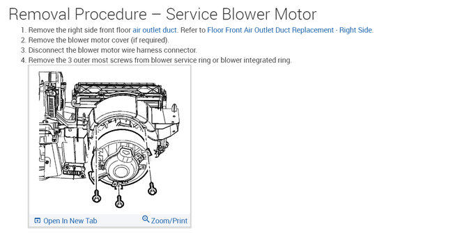

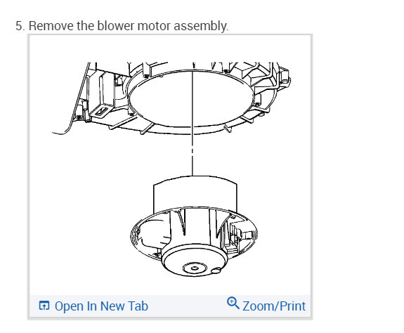

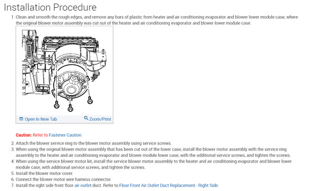

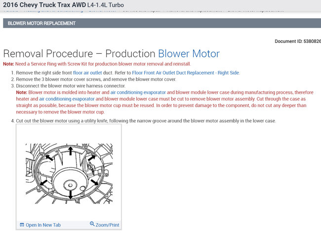

If the new connector is heated it is no good, you should change the blower motor as well and check the blower motor ground. This is what is causing the connection to overheat. Here are guides to help you and the location of the ground so you can check it out and repair the problem.
https://www.2carpros.com/articles/blower-fan-motor-works-on-high-speed-only
Check out the images (below). Let us know what happens and please upload pictures or videos of the problem so we can see what's going on.

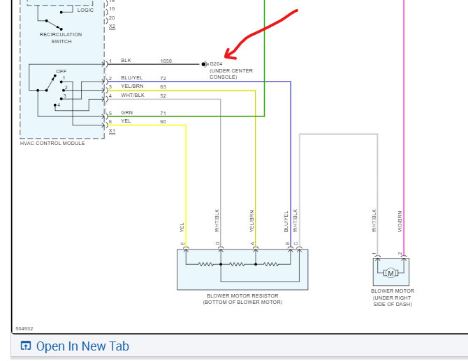

On the last picture where the arrow is pointing to the black under center console is that the ground? I just want to double check.
Jul 16, 2023 at 11:00 AM
That is correct. Also I added the guide a forgot please double check it.
