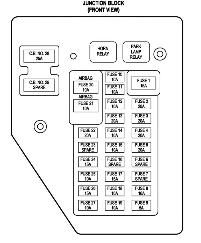

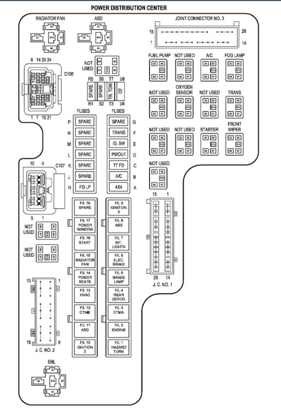

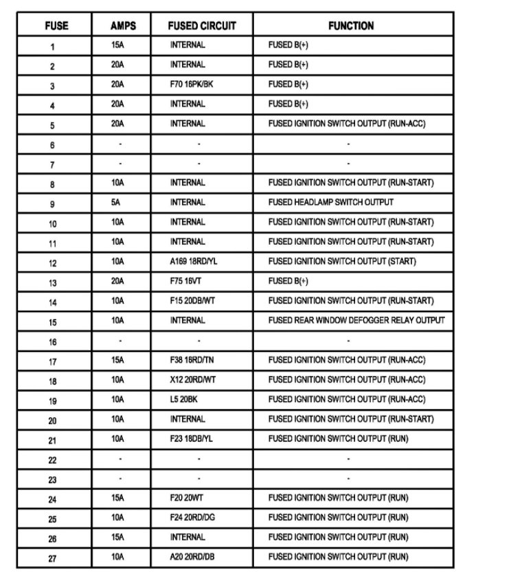

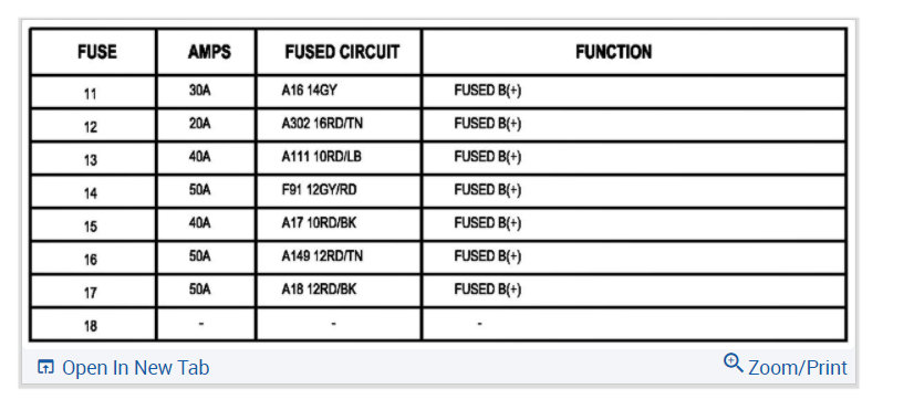

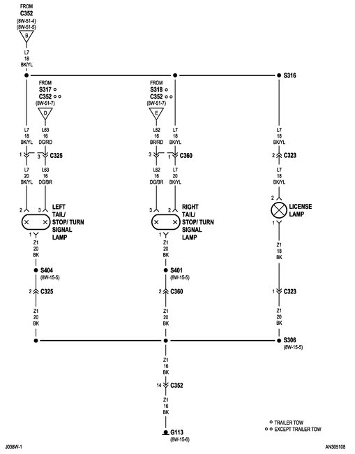

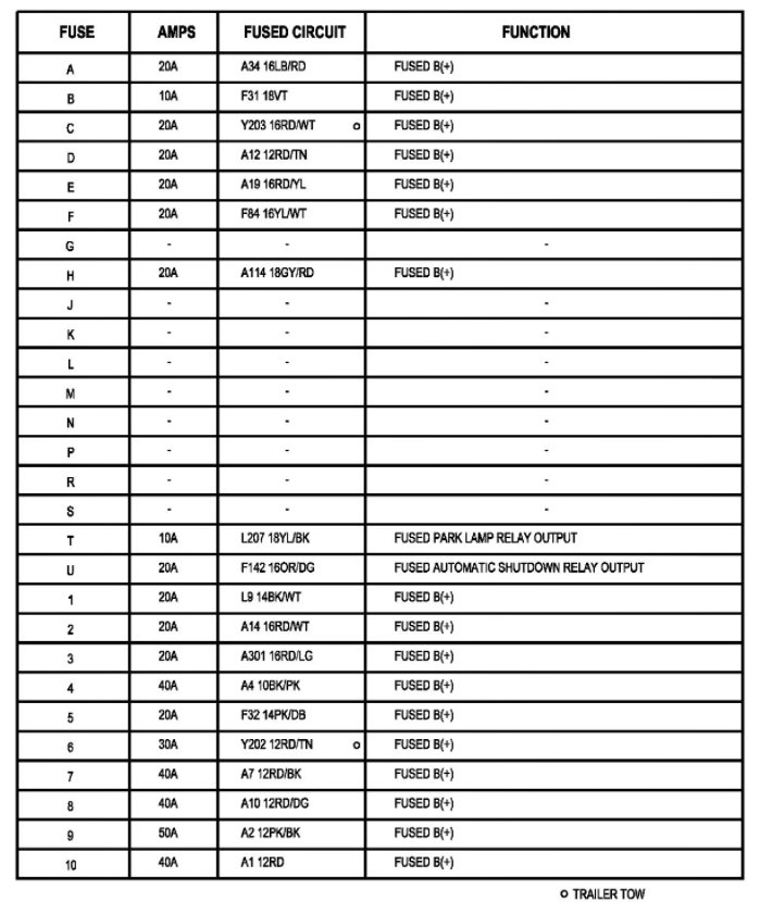

I would check the fuses first though here is a guide with the fuse location in the diagrams below.
Check out the diagrams (Below). Please let us know what you find.

What exactly did you replace and is it just the marker section of the light or are the brake and reverse lights also out? If the entire light is out the first thing I would check would be that the ground (black wire) is grounded, Chrysler seems to have a lot of issues with bad grounds. Especially in the cases like this where they run multiple wires into one splice and crimp them. To test that the easiest way would be to simply bare a small section of the black wire, then use a short jumper wire to a clean metal ground and see if the light works. If it does you have two options. One, trace the black wire back to the splice and repair it, or simply solder and seal the connection you made with the wire and crimp a ring terminal on the end and ground it to a handy spot of steel behind the taillight housing.
If the only part that is out is the tail marker and the rest of the light works then you may have a broken feed wire (black with yellow trace) to the light. That goes into a multi-splice as well. For that the easiest solution is to run a new wire to the splice or trace the wire to find the broken area.

STEVEW661
Well, I have found the answer to my problem. The owner's manual talks about the fuse board located on the side of the dash board. The manual does not mention the "other fuse panel" located under the hood. I removed the lid from the fuse block under the hood and found that I did indeed have two blown 20 amp fuses. I replaced the fuses and presto, the tail lights, blinkers and emergency flashers are again working. Figured I just saved myself a couple hundred bucks, by not having to take it to the dealer and have them replace the 2 $5.00 fuses and charge me an arm and a leg!!!
