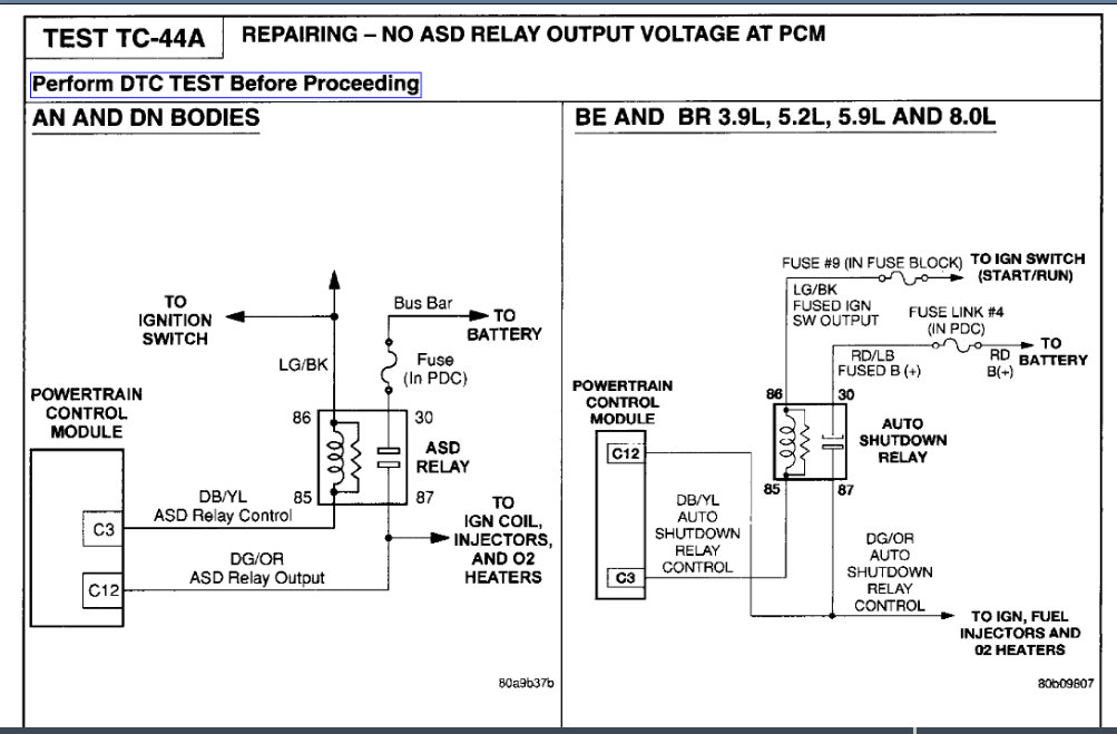

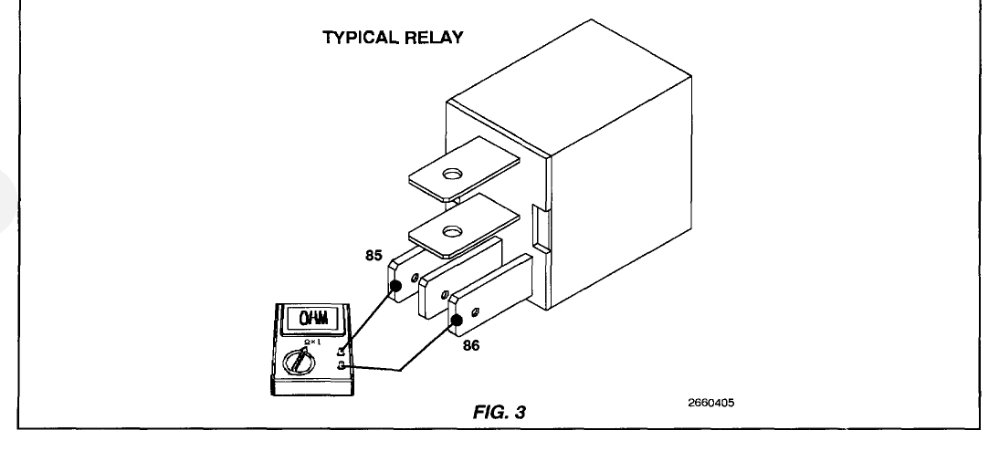

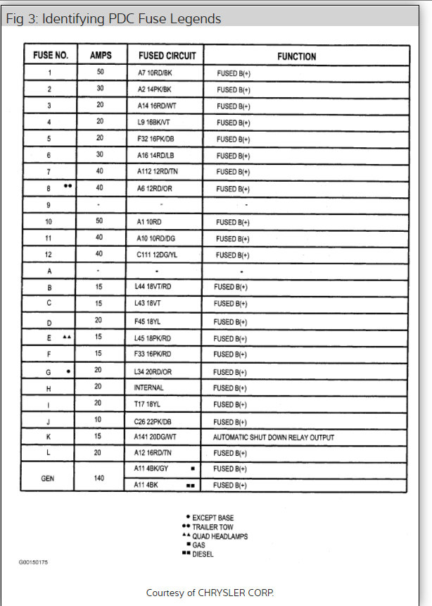

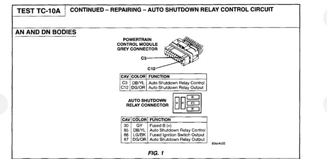

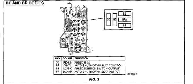

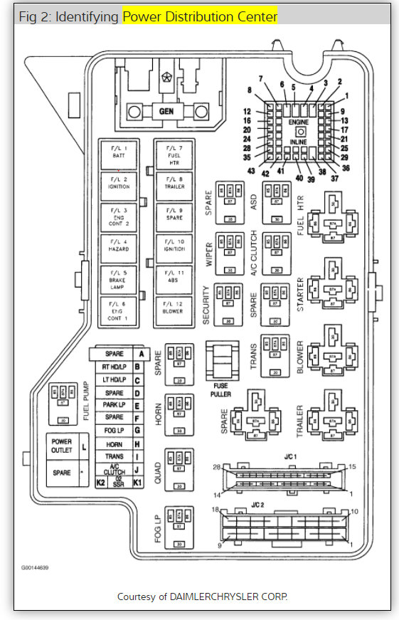

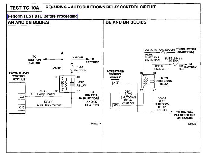

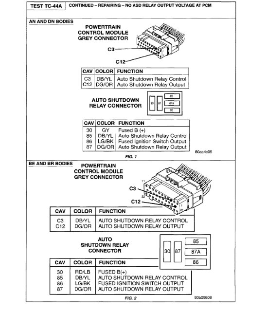

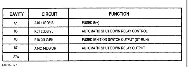

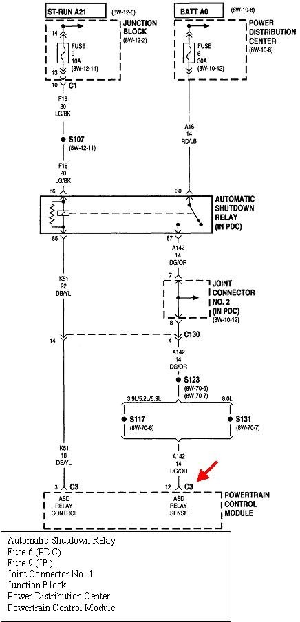

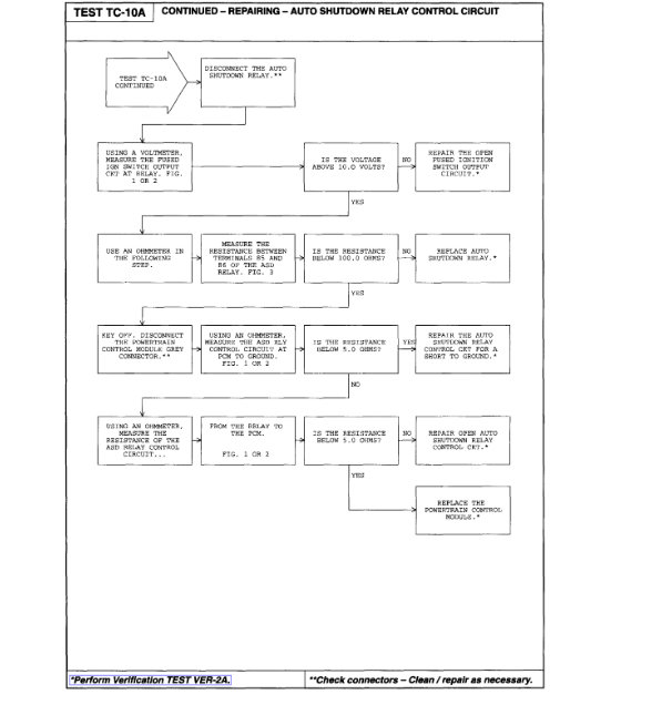

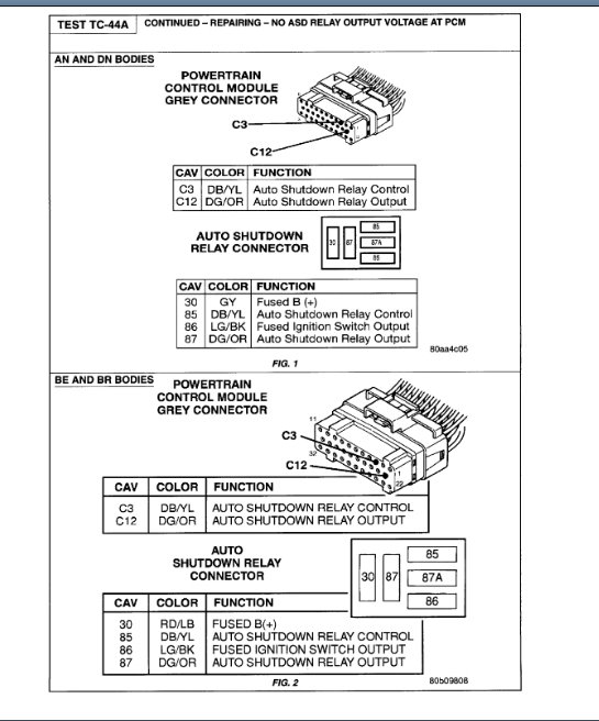

What I think is happening is the ground to relay is cycling on and off. What controls relay is Power Control Module right side fire wall. When it is buzzing pull relay hook volt meter to term # 85 Dark blue/yellow. Neg to term pos to power. If meter fluxuates the PCM faulty. here is a guide to help you test the ASD relay with the location in the diagrams below.
Check out the diagrams (Below). Please let us know what happens.

The wire you checked term 85 on ASD Drk blue/yellow. Remove that wire replace with a wire you run to ground ie. body, block ect.

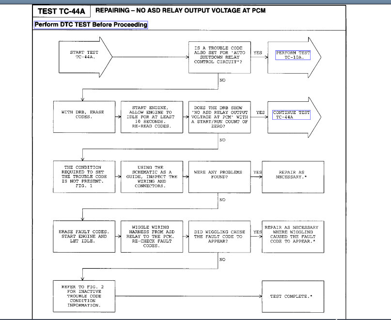

Started with a bad fuel relay board, so i ran the relay wires to the fuse with extended wiring. then i burned up pump, change fuel pump, then lost spark. put in new crank sensor, cam sensor, distributor cap, plugs and wires relays, fuses redid grounds. changed ECM, inspected the wiring harness. i have lots of fuel pressure from pump to fuel rail. also changed coil to new with diagnostic code po 1389 comes up. what is the fix to get this truck running? help!

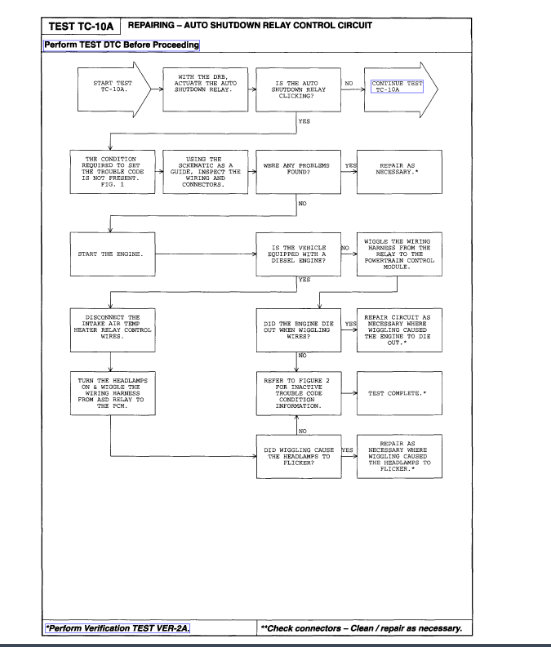

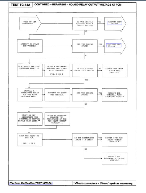

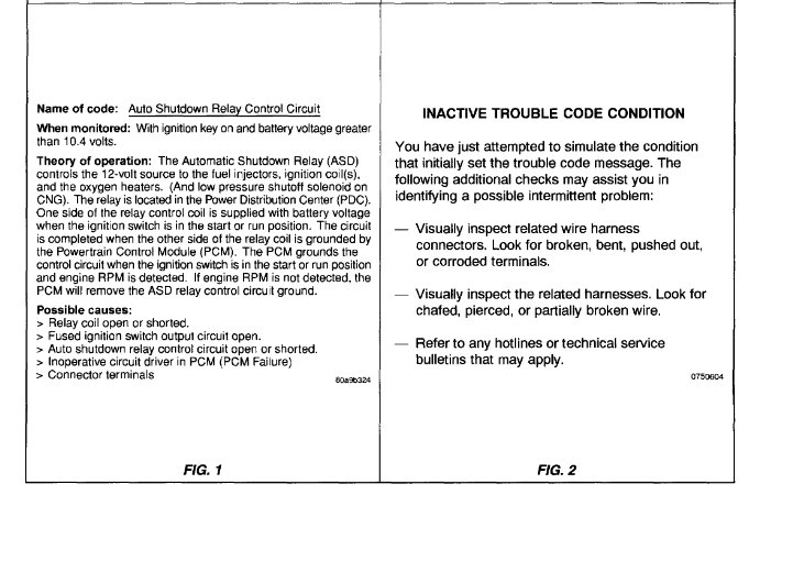

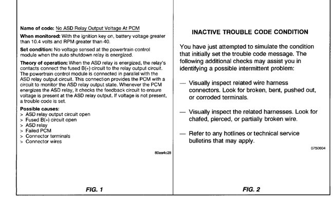

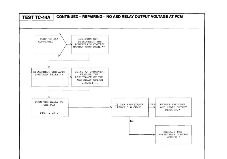

This Direct Trouble Code[DTC] is for No ASD Relay Output Voltage at PCM. In the diagrams down below I have included the diagnostic troubleshooting flowchart for DTC P1389 in the diagrams down below. It will require the use of a code reader and a Digital Multi-meter [DMM], so here is a link below explaining how to use one, if needed:
Please go through these guides and get back to us with how everything turns out.

P1389 - No ASD Relay Output Voltage At PCM
The sensors account for about 95 percent of crank / no-start problems. If the ASD relay is turning on during cranking, the two sensors are working, then we have strictly a fuel supply problem or an ignition system problem.
Let me know what you find up to this point.
