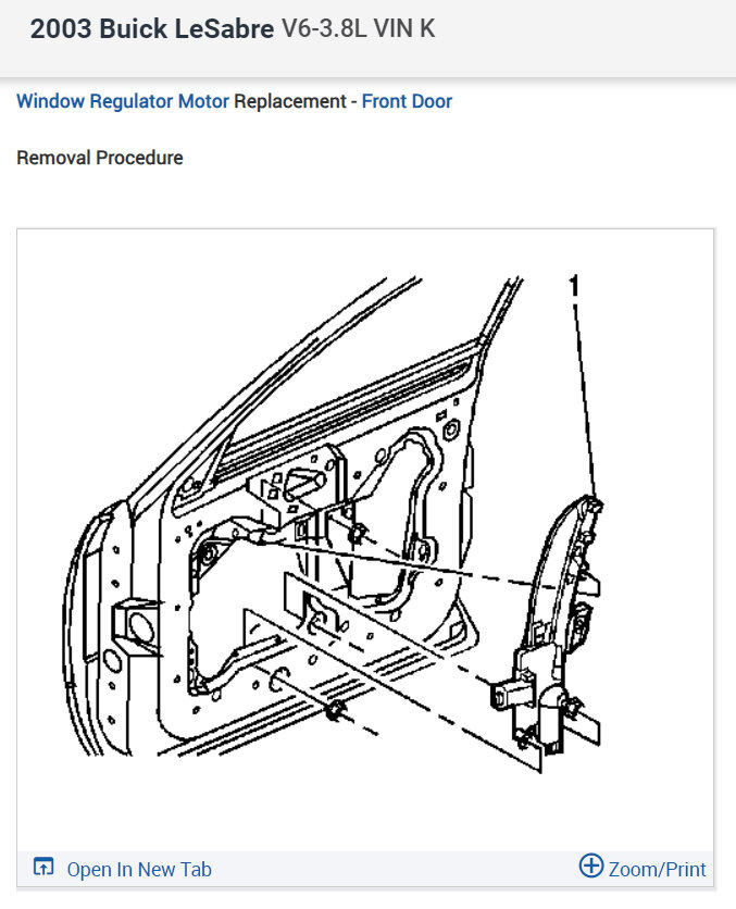

Got the replacement part for the driver side actuator. If there’s any torque specs and process on taking out the old and replacing it?
Aug 3, 2024 at 1:37 PM
CERTIFIED EXPERT
53,855 POSTS

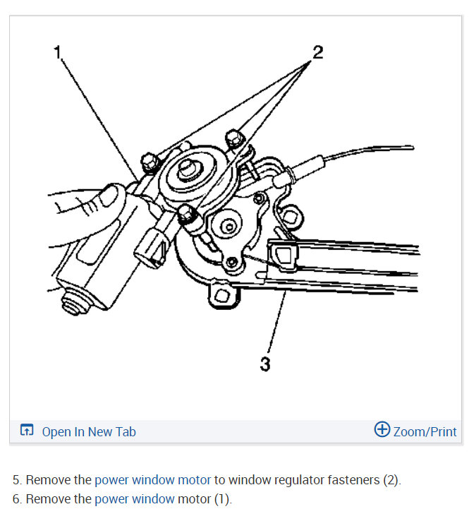

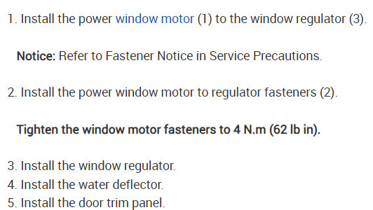

Yes, there is a torque spec for the window motor with the instructions in the images below on how to change the window motor and regulator out.
Tighten the window motor fasteners to 4 N.m (62 lb in).
