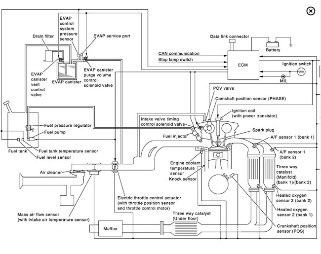

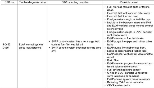

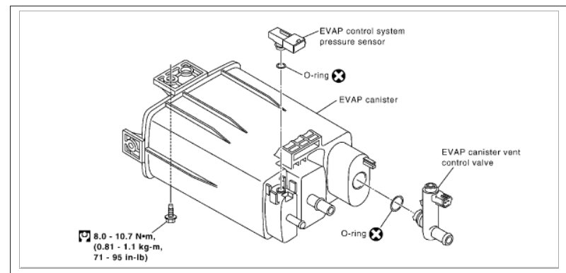

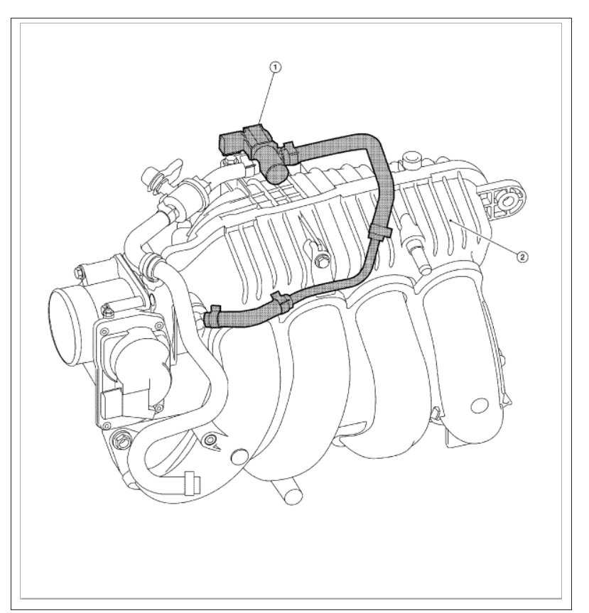

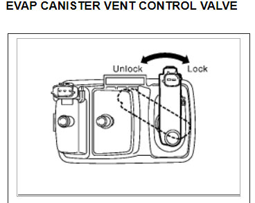

Here is the system lay out so you can start inspecting hoses and checking the EVAP valve. Check the gas cap like PATENTED_REPAIR_PRO suggested and then all hoses, if everything looks good I would suspect the charcoal canister. Check out the diagrams (below). Please let us know what you find. We are interested to see what it is.
