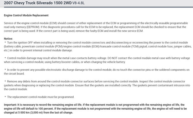

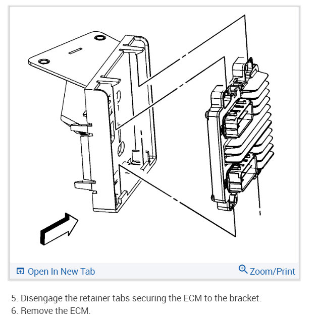

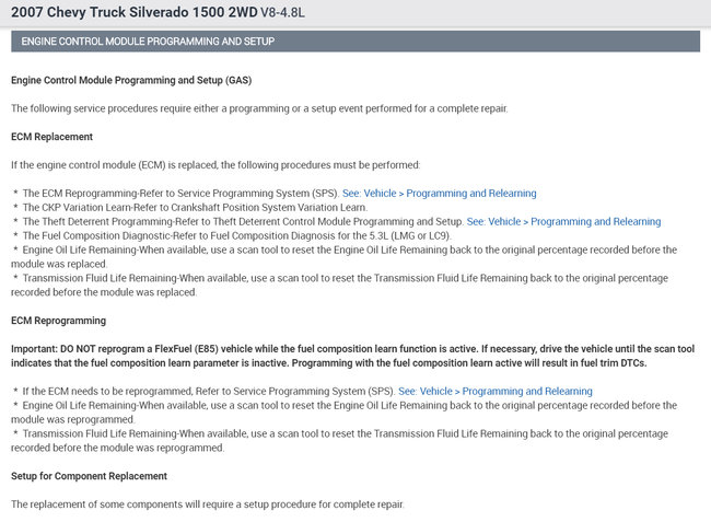

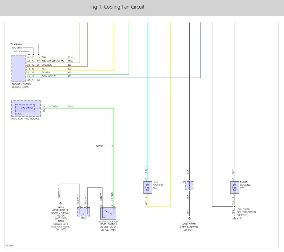

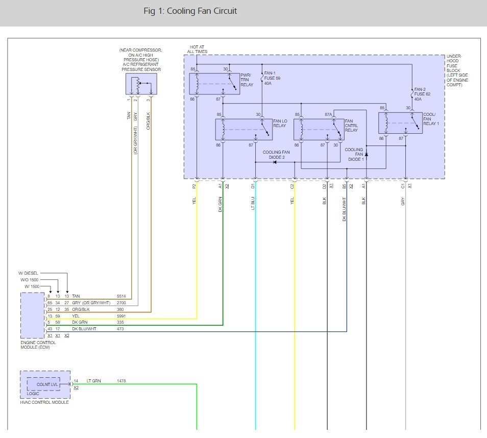

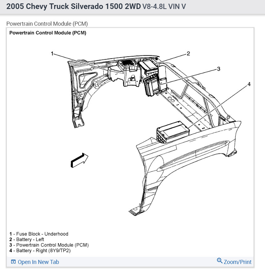

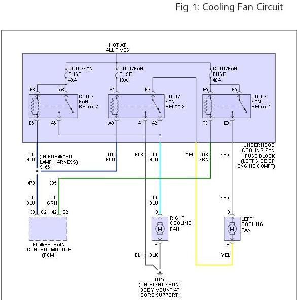

It sounds like the PCM fan control driver has gone bad not triggering the relay when hot. I would plug in a used/rebuilt PCM to see what happens here is the location of the PCM in the diagrams below. Check out the diagrams (Below). Please let us know what happens. Also I have included the fan wiring diagrams so you can see how thehyetems works.
Apr 10, 2016 at 8:34 AM
BOOPERIII
Same problem and had to replace the PCM with a rebuilt unit cost me $175.00

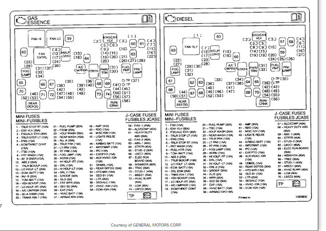

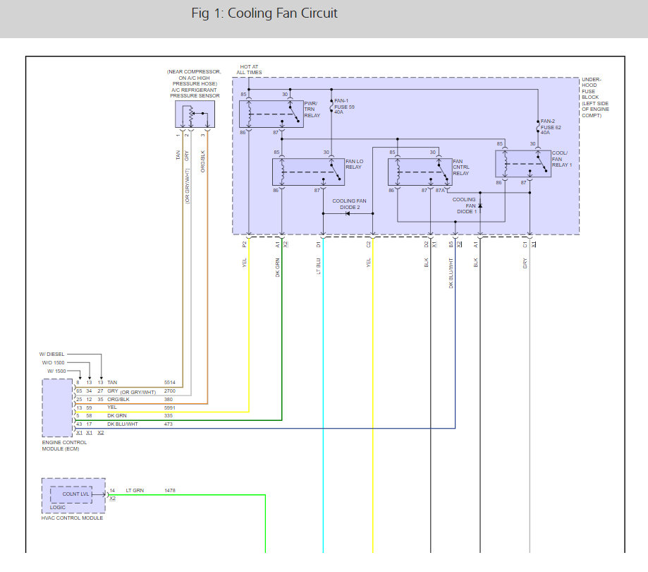

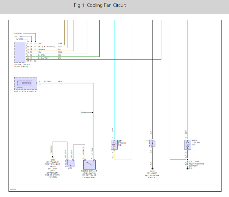

i grabbed you a diagram of the cooling fan system from "prodemand"
it shows all of the components and locations
surely, you can get 'er done now!

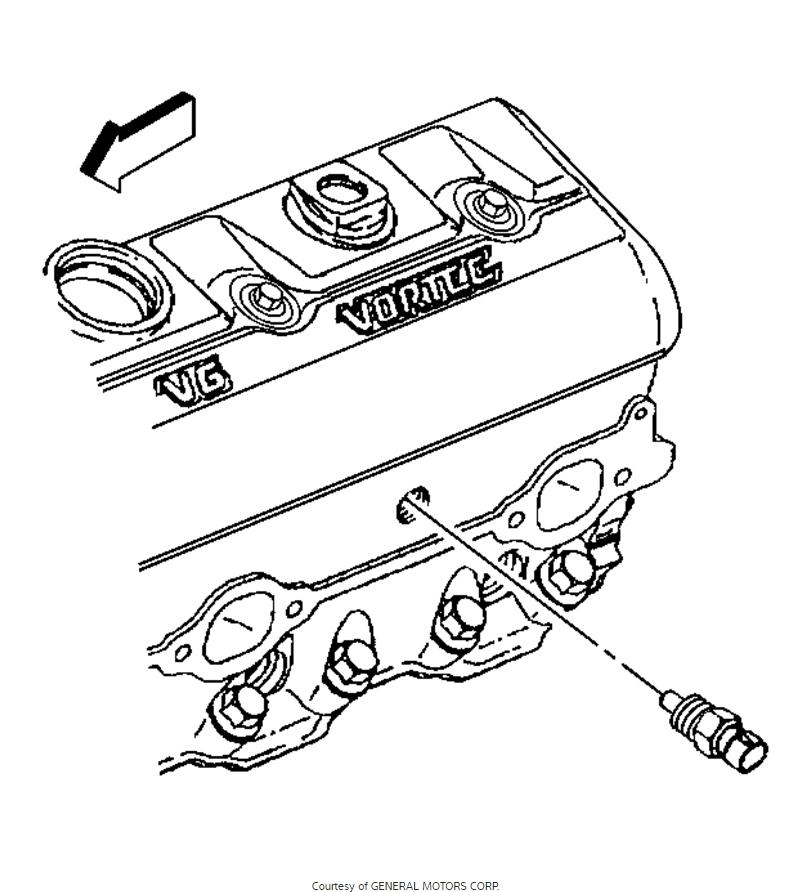

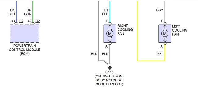

The cooling fans are controlled by the engine computer and are driven from the coolant temperature sensor which is located in the diagram below.

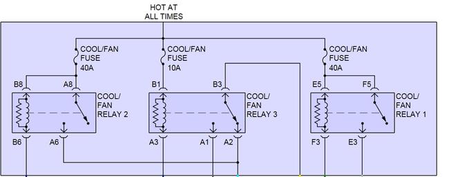

My coolant fan are not working I was going to change the relay for it but it has three relays.what relay do you replace or should you replace all three?
Jan 7, 2019 at 5:45 PM (Merged)
SATURNTECH9
  • 30,869 POSTS
I would check the coolant temp sensor before the relay or the fan motor itself.

the only other thing I can suggest is did you scan for any dtc's,there could also be a trouble code. coolant fan problems might not turn on the SES light but there could be a dtc. also looking at the scematic there could also be a problem in the pcm because there are 2 drivers in the pcm which are relay control grounds. the pcm controls the relays. (this is just a suggestion) but there could even be a problem in the pcm.you need to use a scan tool that is able to command the fans on and off. this might help to diagnose it. post back with other questions/answers.

only other thing I could think of,is the coolant low or does the coolant sys have air in it,that could cause the fans to run on high.I looked at the scematic and the diagnostic it's preety straight forward,it just says to check all relays and check for a short to voltage on the motor supply voltage circuit. I also found this info on the operation of the fans,this might help.The engine cooling fan system consists of 2 electrical cooling fans and 3 fan relays. The relays are arranged in a series/parallel configuration that allows the powertrain control module (PCM) to operate both fans together at low or high speeds. The cooling fans and fan relays receive battery positive voltage from the underhood fuse block.
During low speed operation, the PCM supplies the ground path for the low speed fan relay through the low speed cooling fan relay control circuit. This energizes the low speed fan relay coil, closes the relay contacts, and supplies battery positive voltage from the low fan fuse through the cooling fan motor supply voltage circuit to the left cooling fan. The ground path for the left cooling fan is through the cooling fan s/p relay and the right cooling fan. The result is a series circuit with both fans running at low speed.
During high speed operation the PCM supplies the ground path for the low speed fan relay through the low speed cooling fan relay control circuit. After a 3 second delay, the PCM supplies a ground path for the high speed fan relay and the cooling fan s/p relay through the high speed cooling fan relay control circuit. This energizes the cooling fan s/p relay coil, closes the relay contacts, and provides a ground path for the left cooling fan. At the same time the high speed fan relay coil is energized closing the relay contacts and provides battery positive voltage from the high fan fuse on the cooling fan motor supply voltage circuit to the right cooling fan. During high speed fan operation, both engine cooling fans have there own ground path. The result is a parallel circuit with both fans running at high speed.
Important: The right and left cooling fan connectors are interchangeable. When servicing the fans be sure that the connectors are plugged into the correct fan.

Next step is to change coolant temp sensor? Anyone know where it's located?

I have found that if the ac system has too much Freon in it the computer thinks the system is overheating and runs the fans on high to try and cool the condenser. Please check the state of charge and get back to me.
and
https://www.2carpros.com/articles/air-conditioner-how-to-add-freon
Here is the air conditioner wiring diagrams (below) so you can see what I'm talking about.
Please let us know what happens, we are interested to see what it is.

If the PCM is not sending a signal it is bad and needs to be replaced. Here is the location of the PCM. I would try a used/rebuilt unit.
Jun 28, 2021 at 5:50 PM (Merged)
GRIT03
Thanks Ken. I even tried cutting on the AC and it still doesnt power the fans. I feel confident that the PCM is bad. Thankyou for your advice and assistance!
