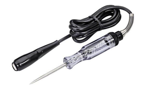

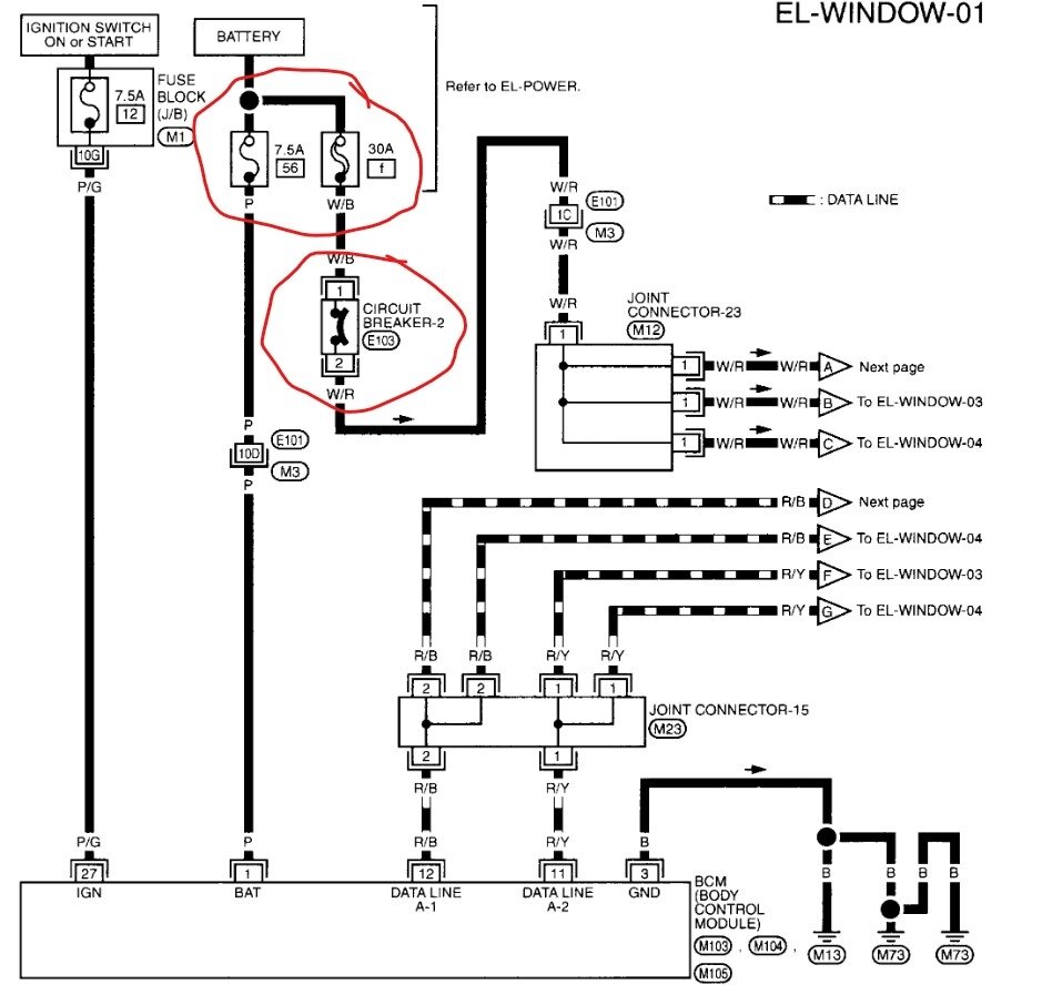

Okay, step one will be to test the fuses in the box under the hood and the left-hand fuse box. They can look fine but still be bad. There is also a circuit breaker (#2 under hood fuse box) that may have failed. Go through those and see if there is a bad fuse. To test the circuit breaker, you can use a meter or just replace it as they may test good but still be bad.
