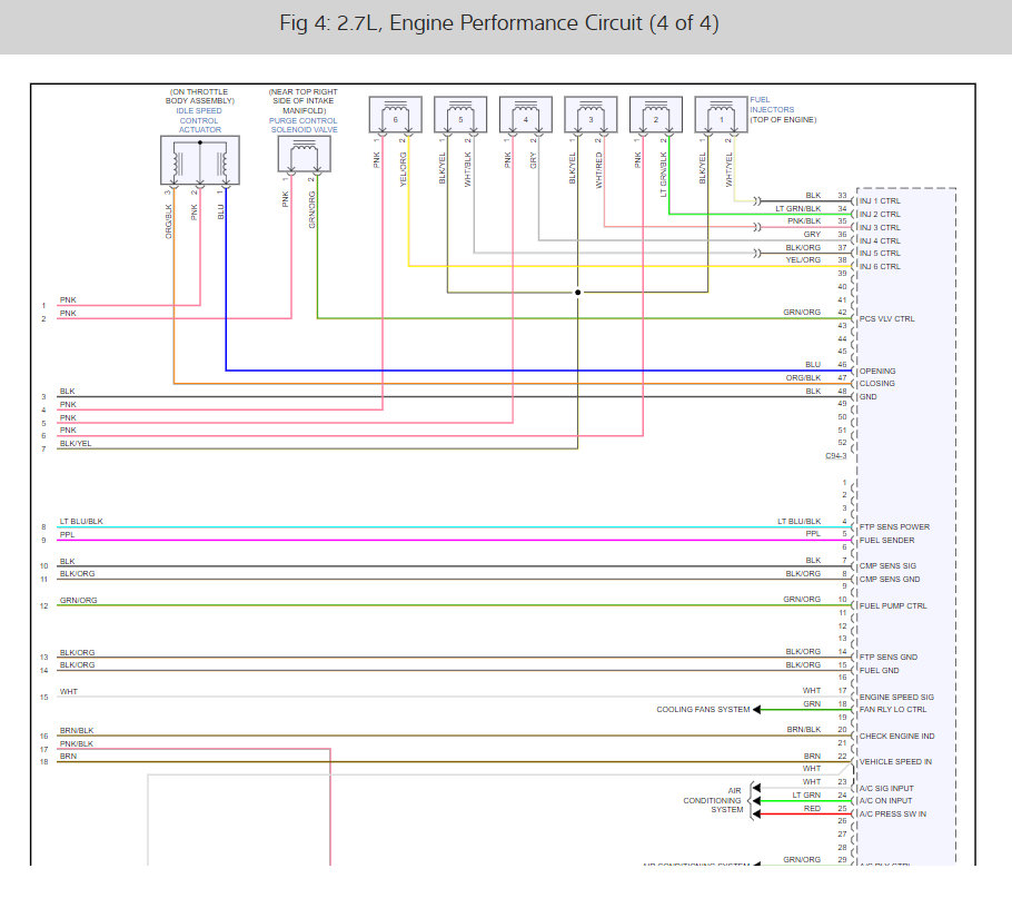

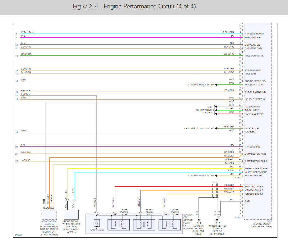

Need a diagram of coil pack. my connector crumbled to pieces. what wire goes where?

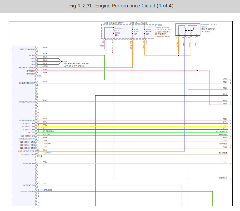

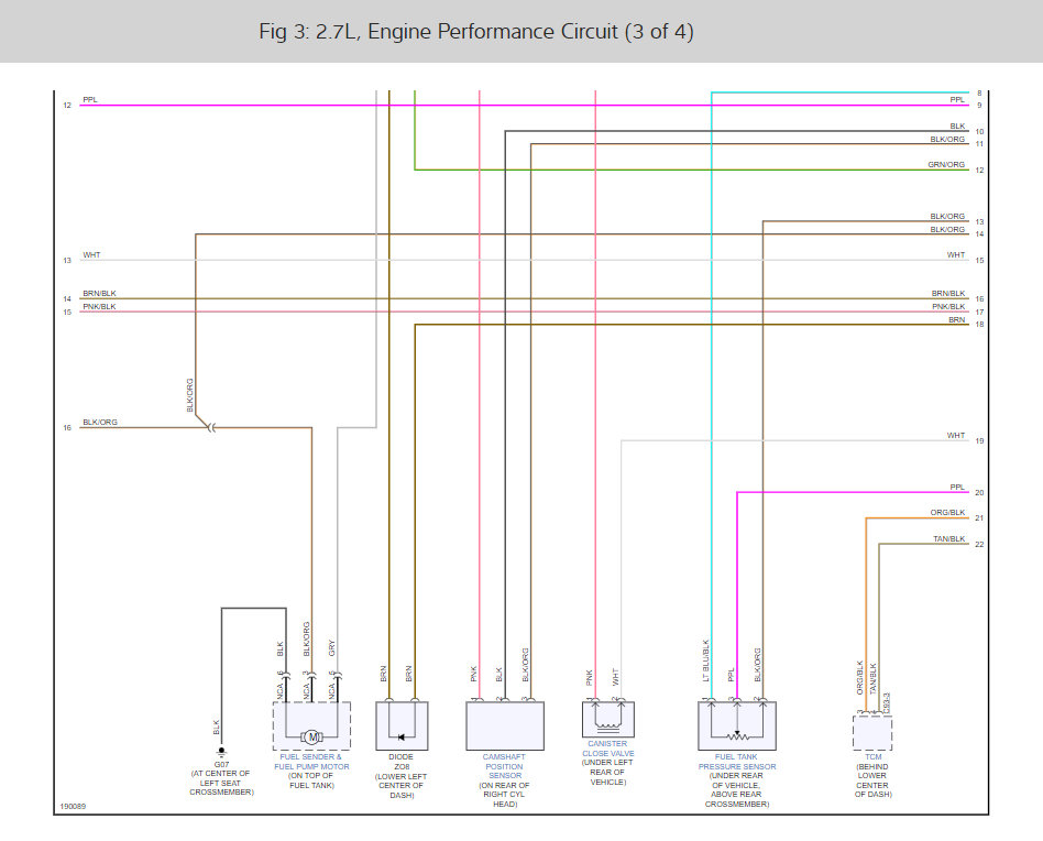

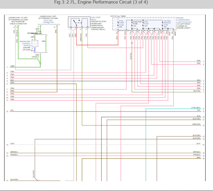

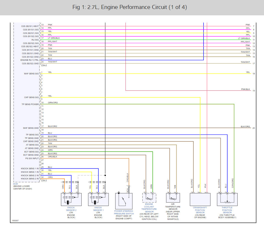

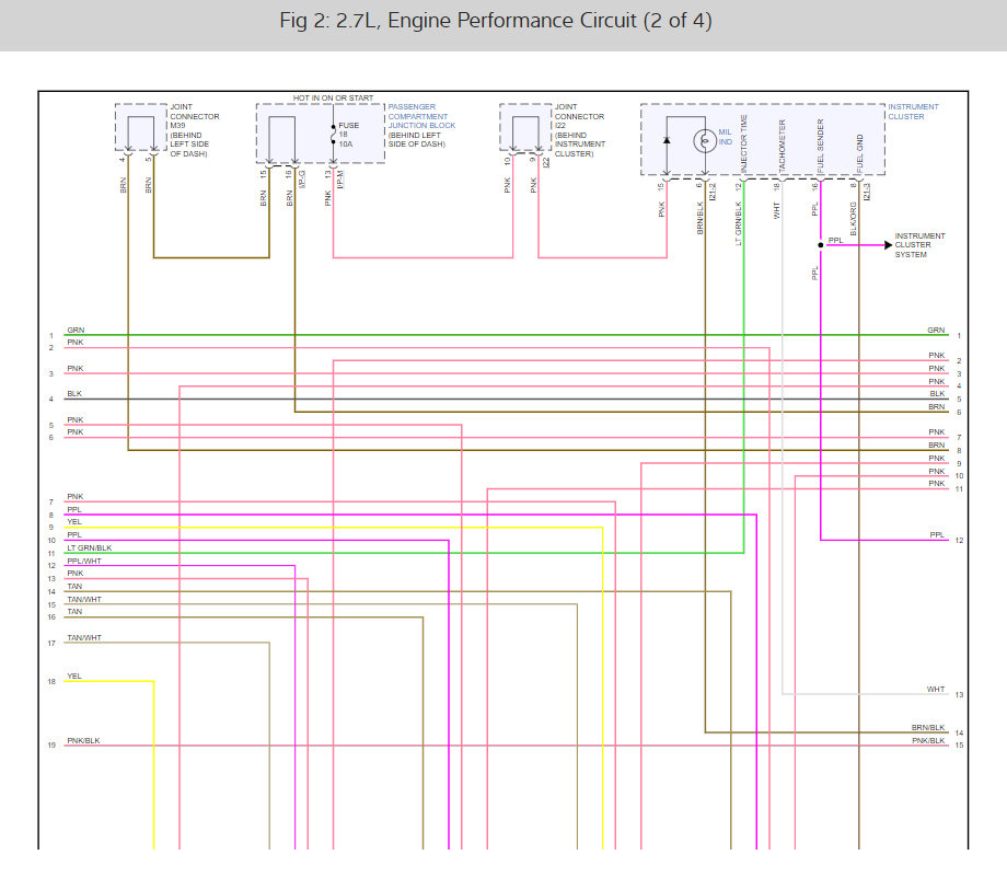

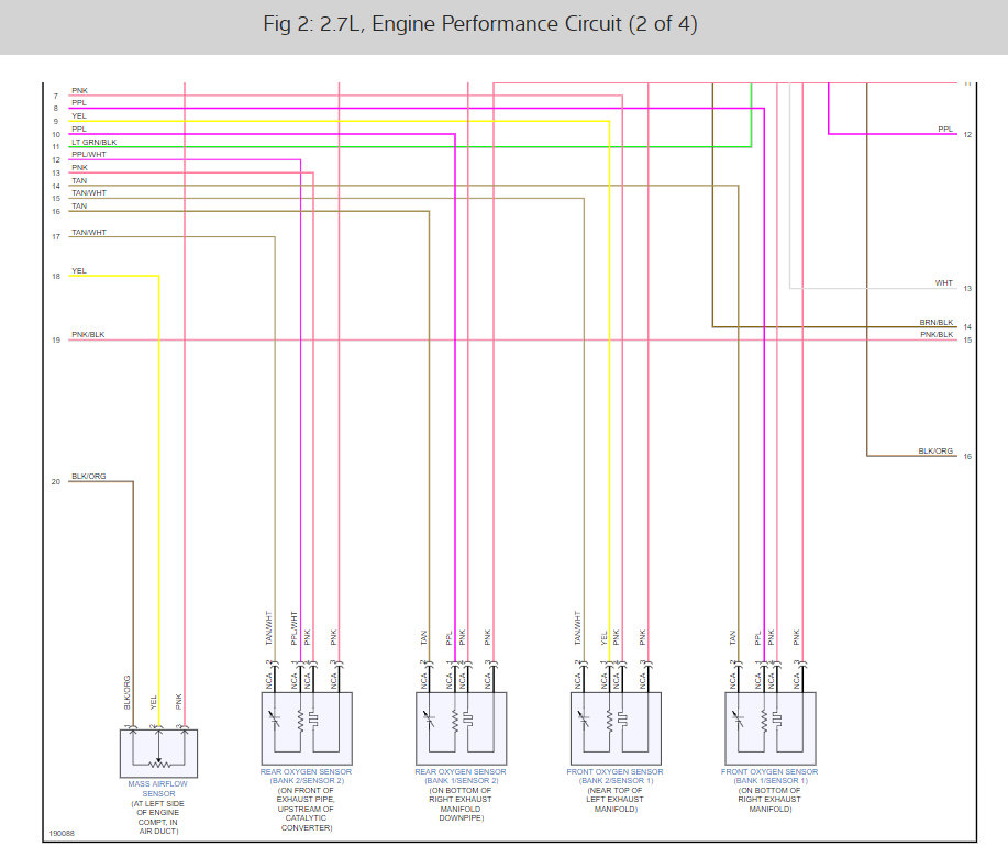

Here is a guide to help you check the wiring and the full engine wiring diagrams below:
Check out the diagrams (below). Please let us know if you need anything else to get the problem fixed.
