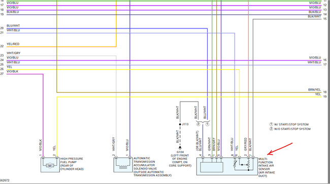

Sure, here are the wiring diagrams for the MAF sensor which they call a multi-function air intake sensor. Check out the images (below). Let us know if you need anything else.

Is there a difference if I have the 1.4 non diesel?

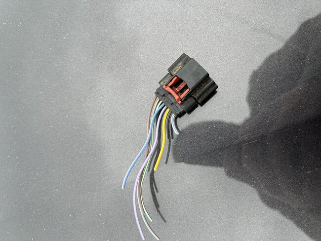

None of the wires are correctly colored to my factory plug. I need to know which wire on my mass airflow sensor goes to the IAT/ humidity sensor/ barometric pressure. Multi-function MAF.

NOAH ALBERTS
I recently replaced the connector that was broken, no codes or issues before that. After using wire connectors, the first time, and still after soldering the connector into the system. I’m now getting a plethora of codes.
P0097 repeats 3 times
Intake Air Temperature
Sensor 2 Circuit Low Bank 1
P00F4 repeats 3 times
Humidity sensor circuit Low
P0113 repeats 3 times
'sensor 1 Circuit High Bank 1
P2227 repeats 3 times
Barometric pressure sensor
A' Circuit Range/Performance
P2229 repeats 2 times
Barometric Pressure sensor
A' circuit High

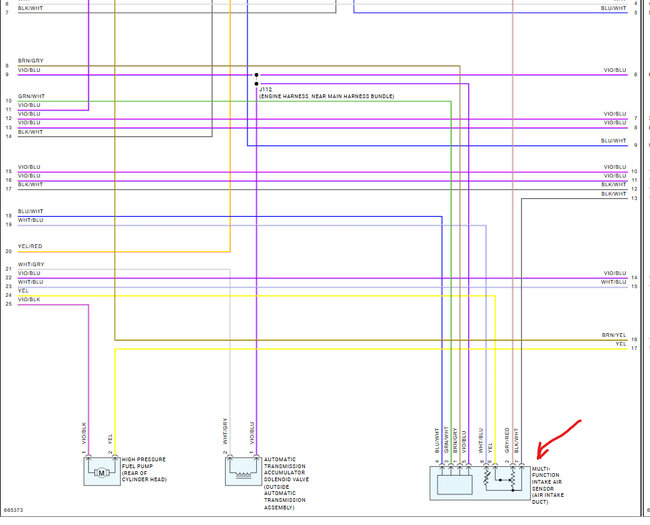

Yes this is for the non-diesel engine, I take tell how many wires your connector has? Here is the wiring for a 2019 which is different so it might be what you need. Check out the images (below). Let us know how it goes.
