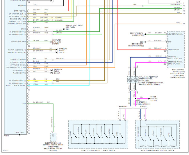

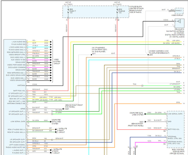

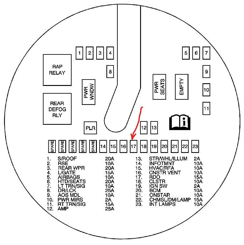

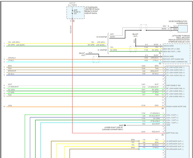

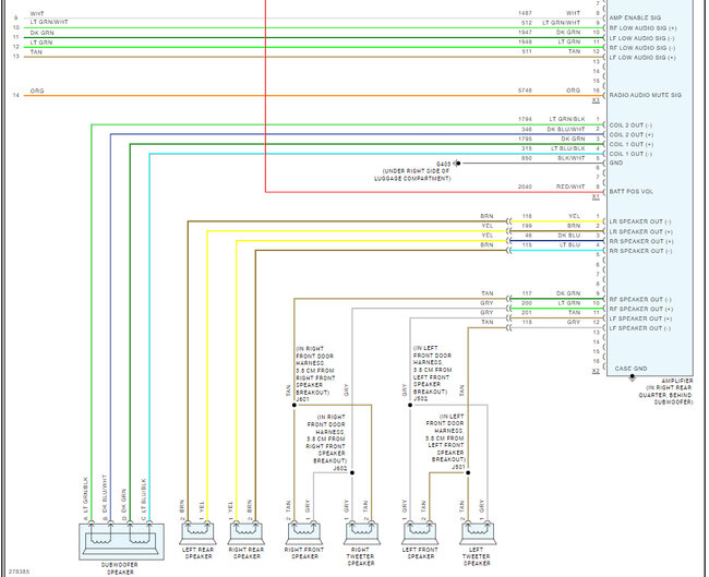

There is only one power wire to the radio which is red/wht which is fused by the RDO fuse #17 in the fuse panel in the center of the dash to the right side of the radio. Here are the radio wiring diagrams so you can see how the system works, and which wires go to where to help with the new radio installation. Check out the images (below). Let us know if you need anything else.

All the fuses relating to the radio are good. The radio fuse, the Amp fuse is also good. There is just no power coming from the constant 12 volts or the red switch wire going to the radio. I tried grounding a multimeter to the battery to check power inside the vehicle. Still no power. All fuses are good including fuse #17. That's for the radio.

and there is no power at the red/wht wire, correct? you can see by the wiring diagrams above the red/wht wire comes from the fuse panel right from the RDO fuse. Has the wiring been modified?

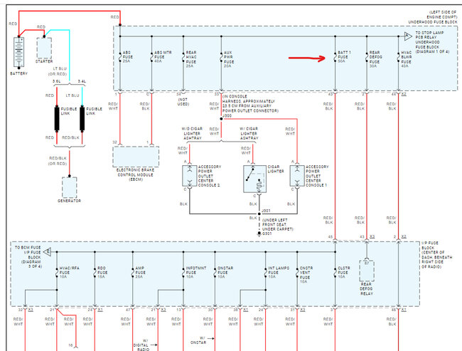

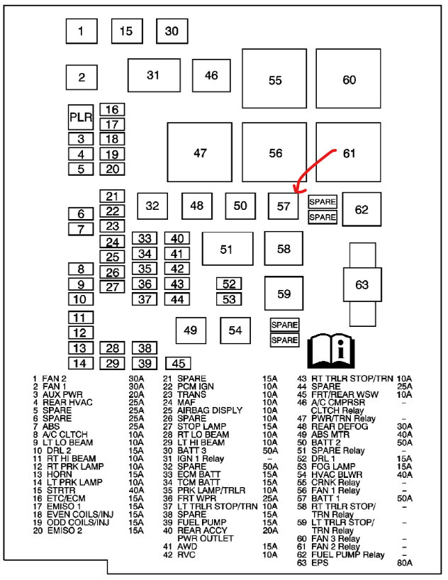

Okay, thanks for the clarification. Let's check the 50 AMP Batt1 fuse in the under-hood fuse panel here is the location. Check out the images (below). Let us know how it goes.
