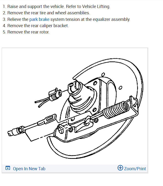

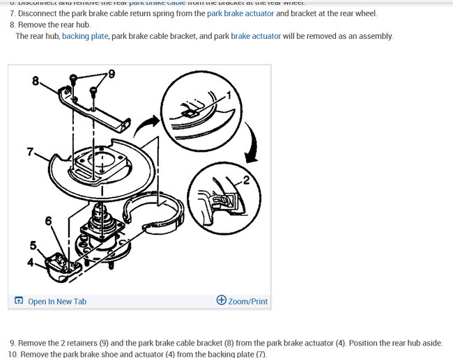

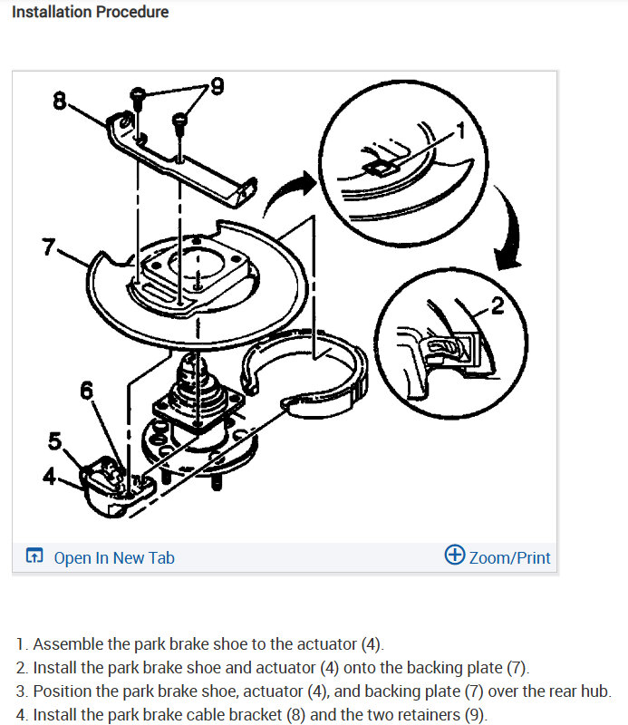

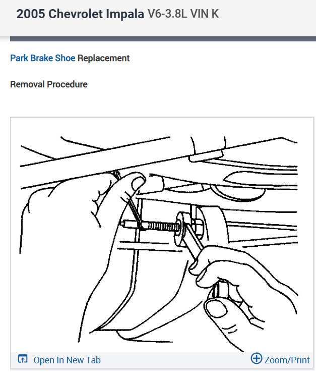

I would check the parking brake cables as well, here is how to replace the emergency brake shoes to get you started.
Please go over this guide as well which gives you a step by step, I also included how to do the job on your car as well in the images below.
https://www.2carpros.com/articles/parking-brake-shoe-replacement
Check out the images (below). Let us know how it goes.
