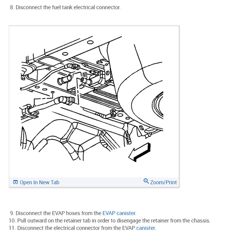

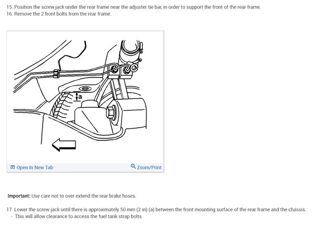

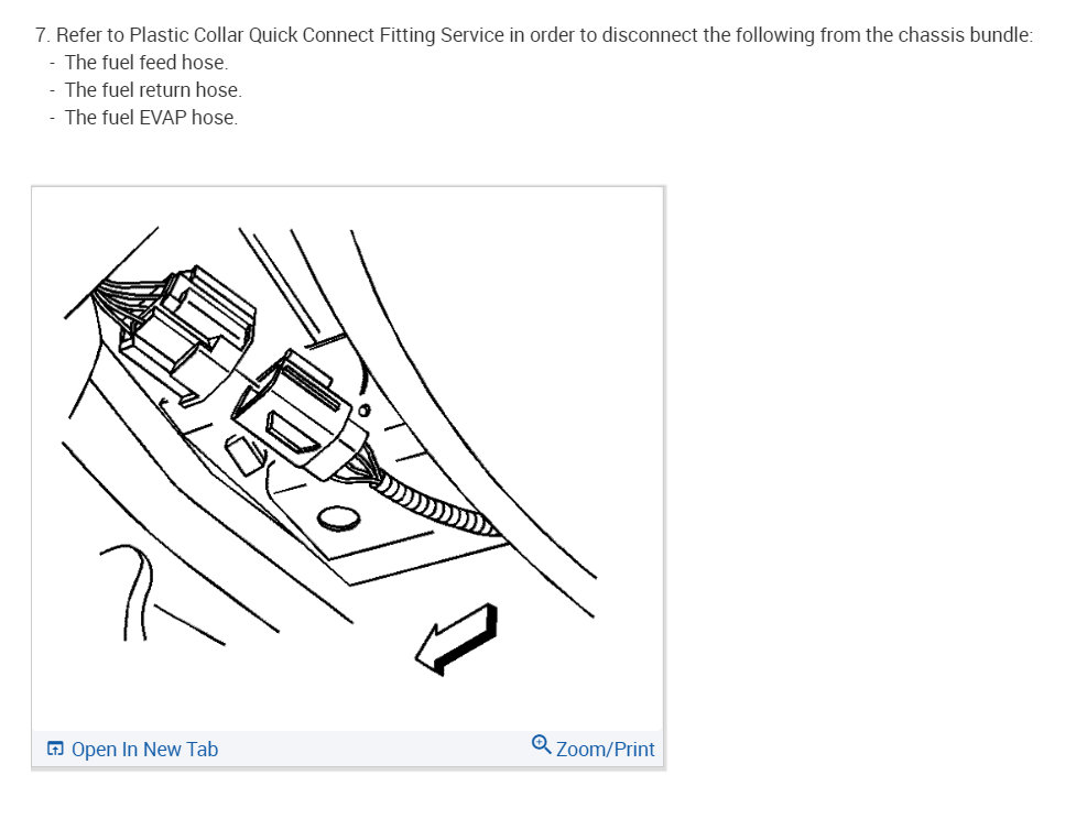

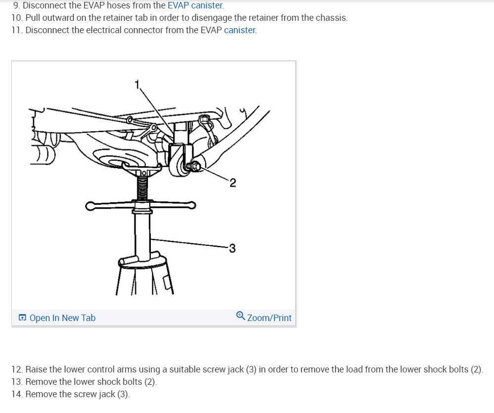

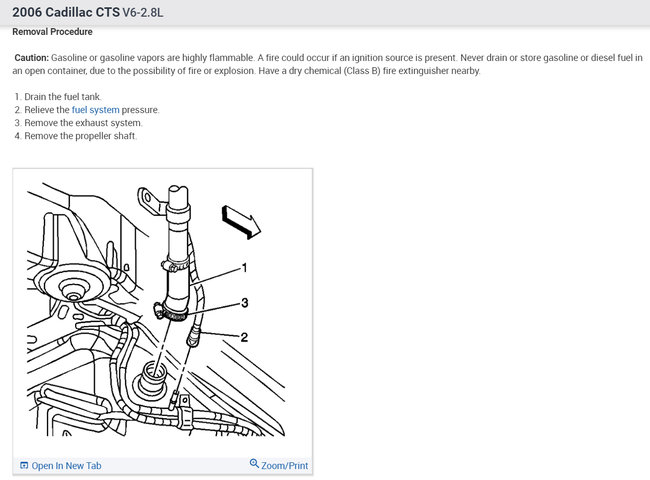

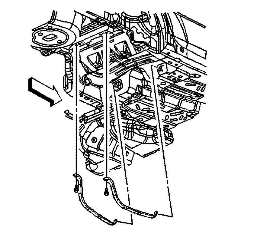

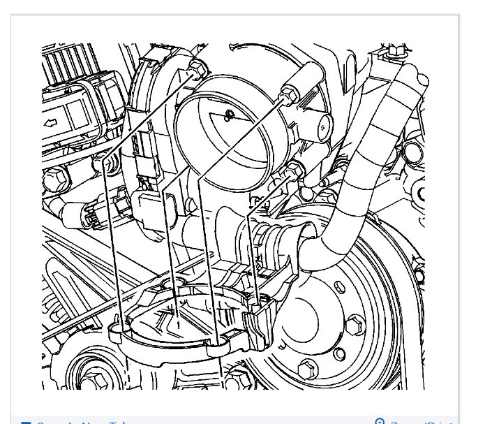

This happens when the fuel pump starts to go out, or you have a dirty throttle bore. Here is a guide to help you clean the throttle bore with diagrams below to show you how on your car:

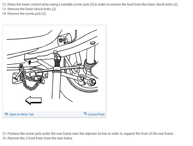

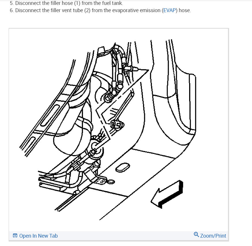

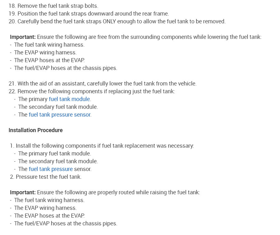

here is how to check the fuel pump pressure with instructions below on how to change the pump out. Also, we should run the codes to see what comes up.
and
This guide can help out as well:
https://www.2carpros.com/articles/engine-hesitates
