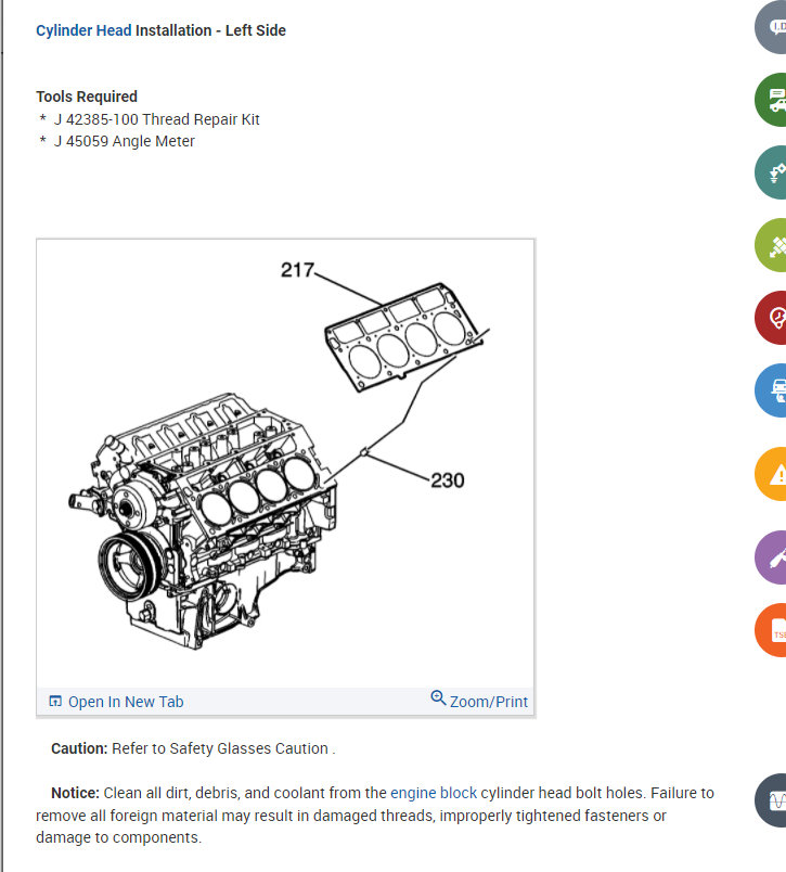

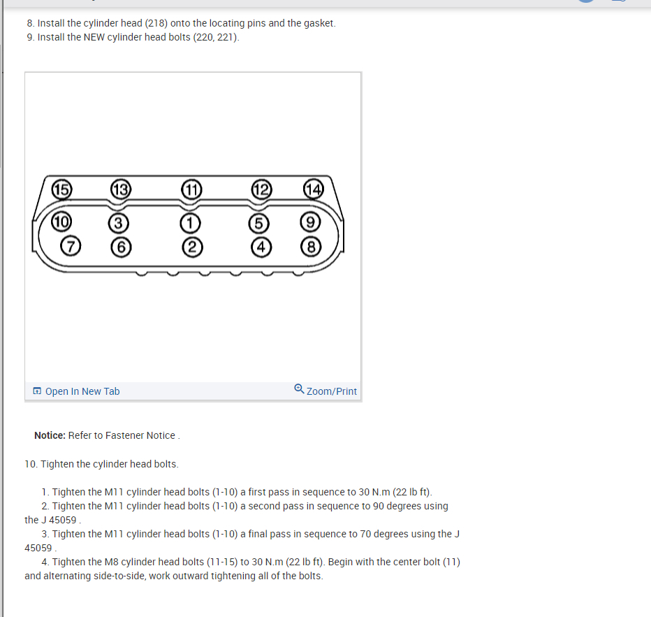

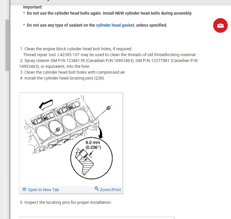

Once we confirm that the head gasket is leaking then we need to try and narrow it down to one bank so that you don't have to do both. This normally will show up in a compression check. Here is a guide that will help with this:

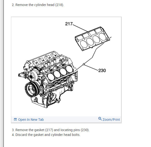

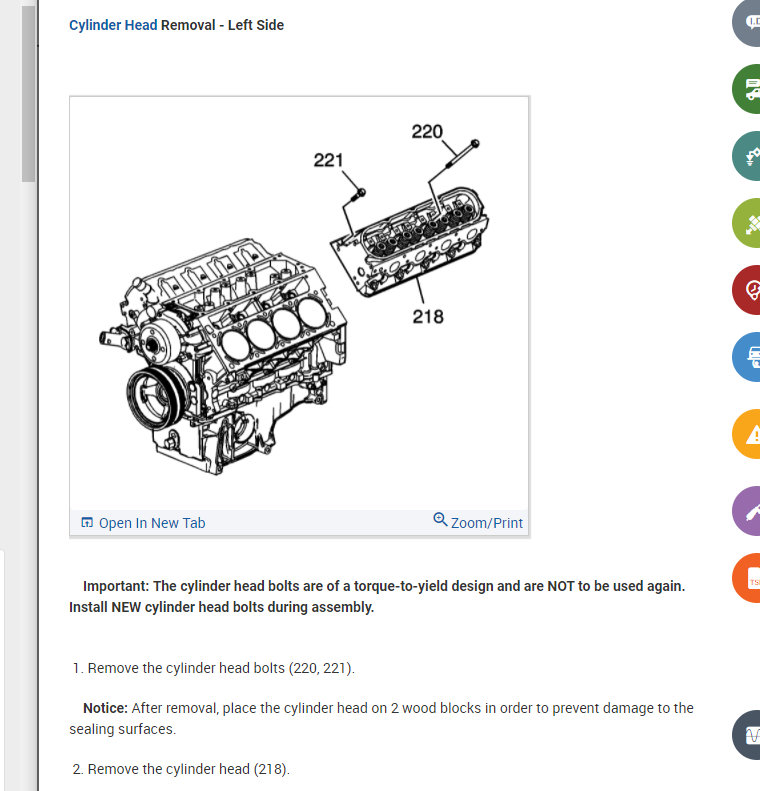

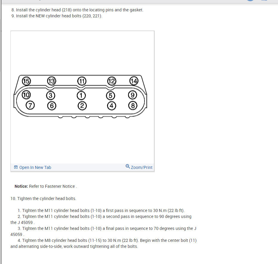

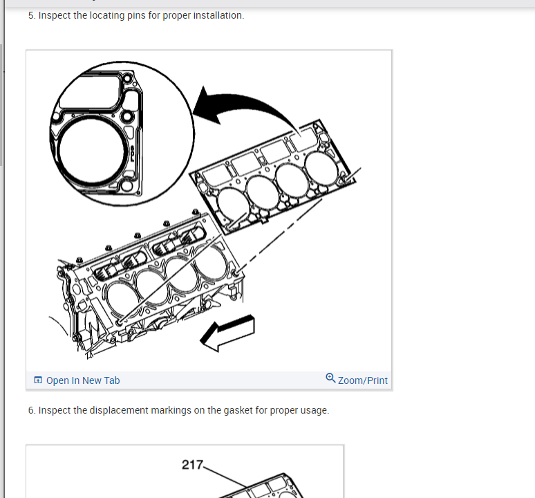

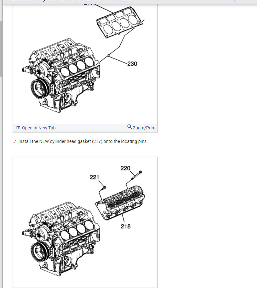

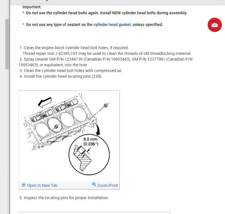

Below you will find the process on the left side head as the right is basically the same. Please run through this material and let us know if you have other questions. Thanks
