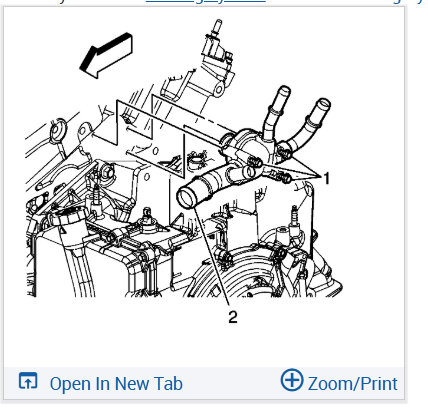

If the engine overheats in the first 15 minutes of driving, then I would suspect the thermostat. Here is the location so you can check it out. Check out the images (below). Please let us know what happens.
Apr 21, 2025 at 11:23 AM

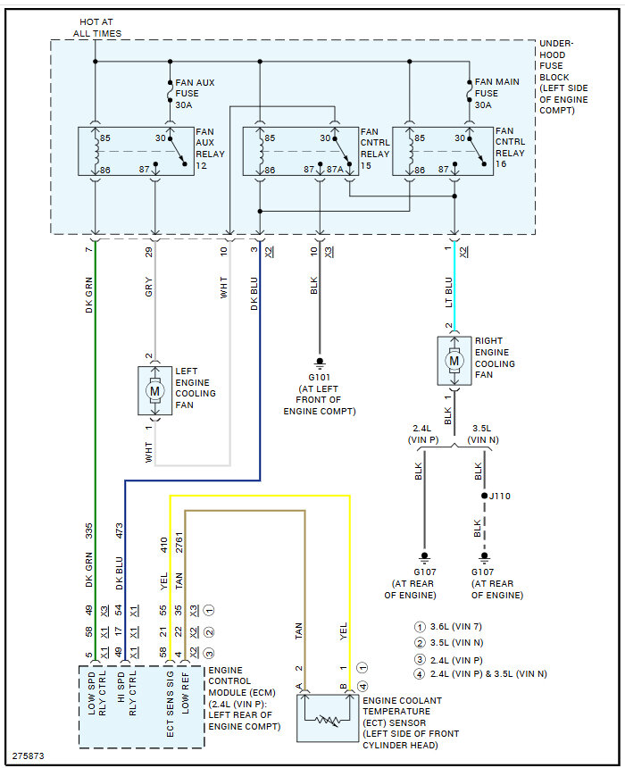

Here is the wiring diagrams for the radiator cooling fans, I would swap the relays out one at a time to see if that is the problem. Check out the images (below). Please let us know what happens.
Apr 27, 2025 at 11:47 AM
