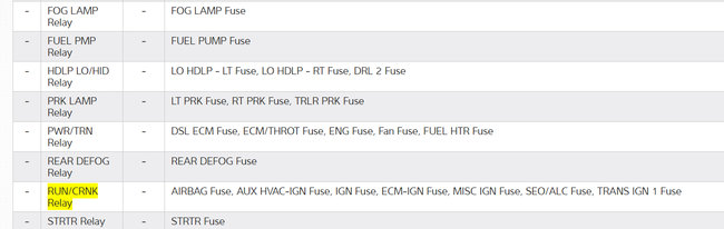

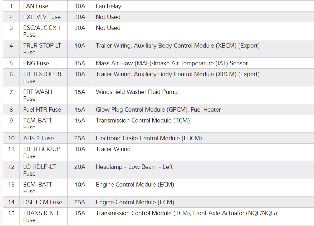

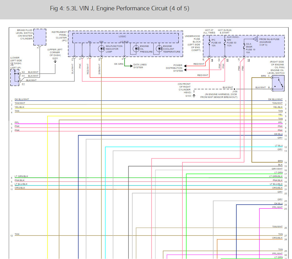

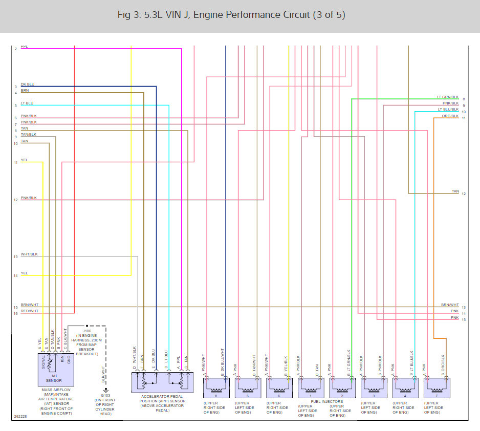

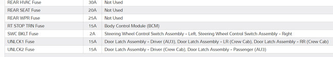

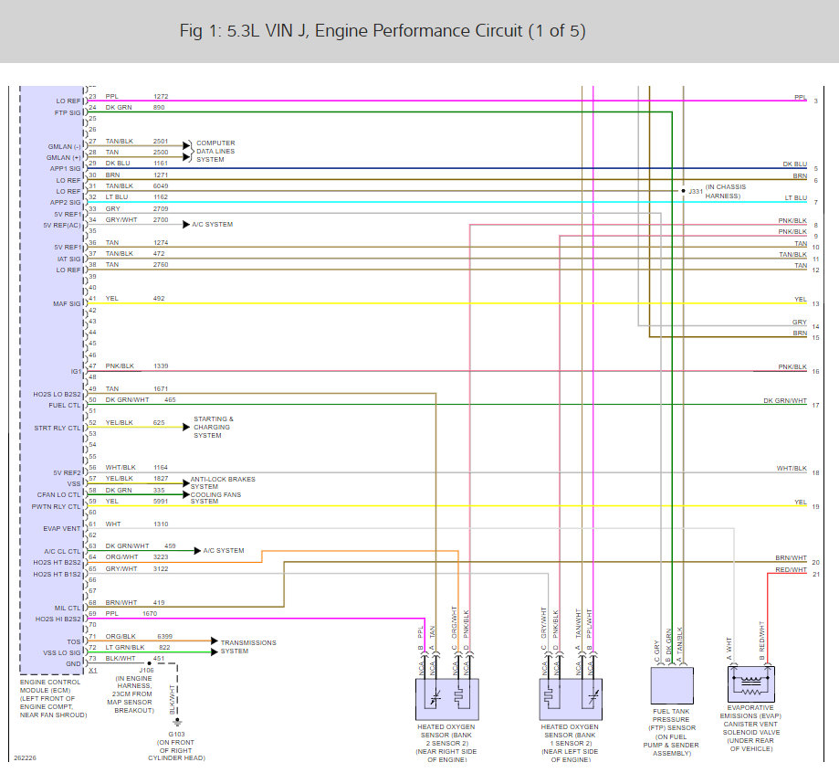

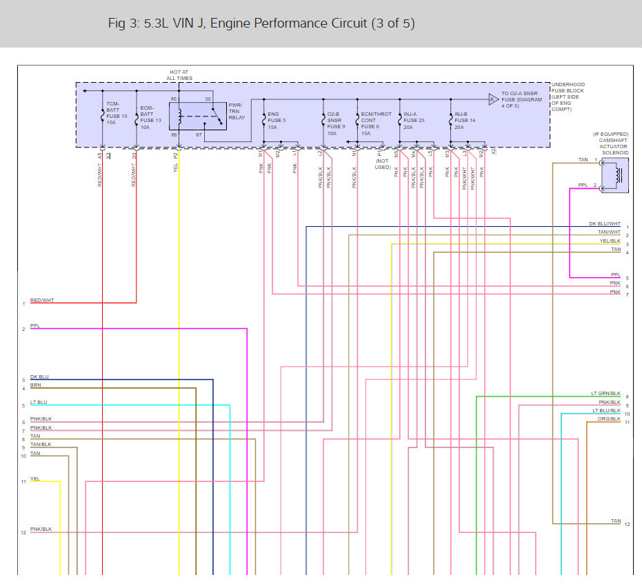

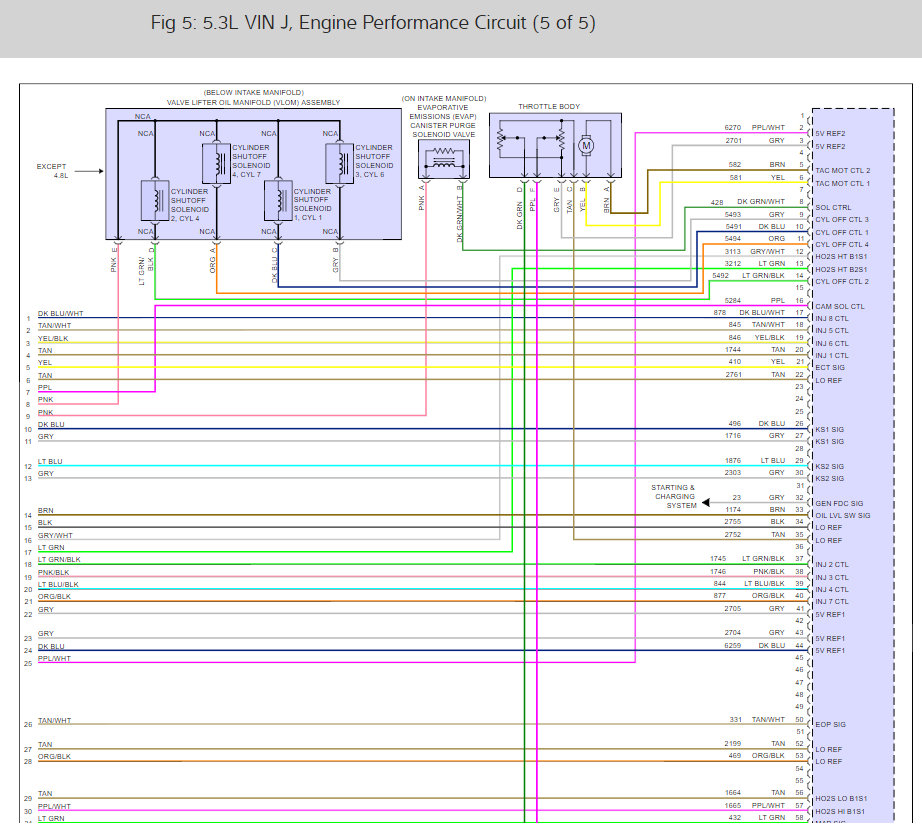

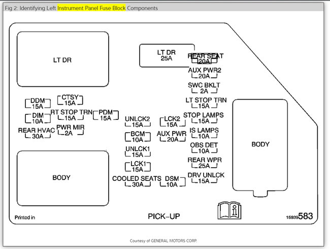

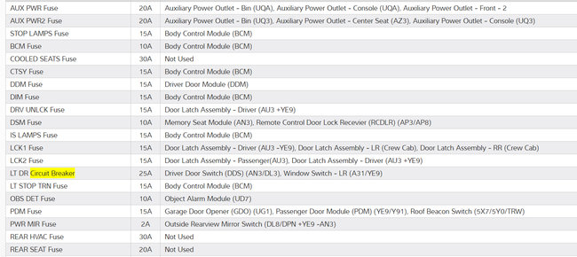

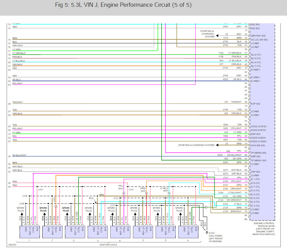

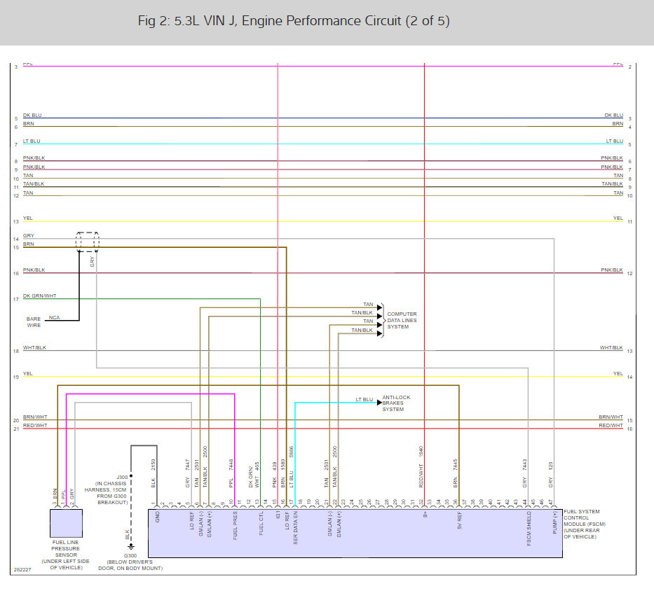

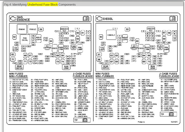

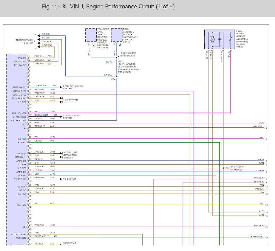

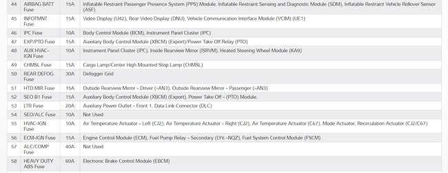

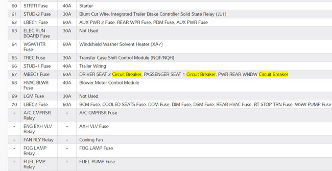

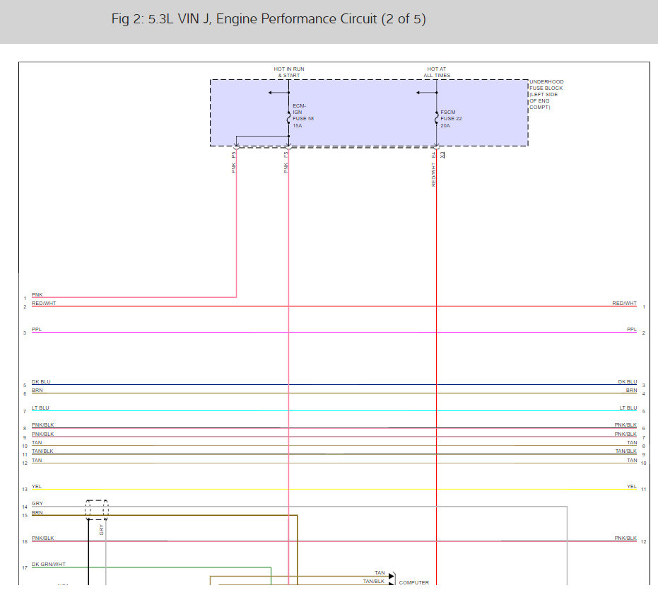

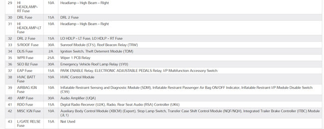

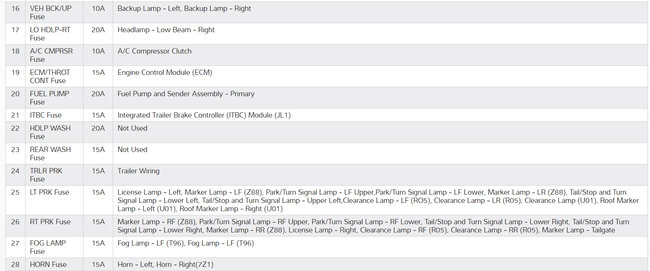

It sounds like you have lost a power feed into the PCM which there are 11 fuses and one PWR/TRN relay that need to have power when the car is on.
Here are two guides to help us do some simple testing:
and
(Check out the fuse panel engine wiring diagrams below)
Please run some tests and get back to us.
