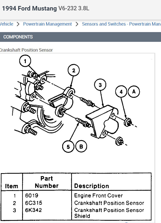

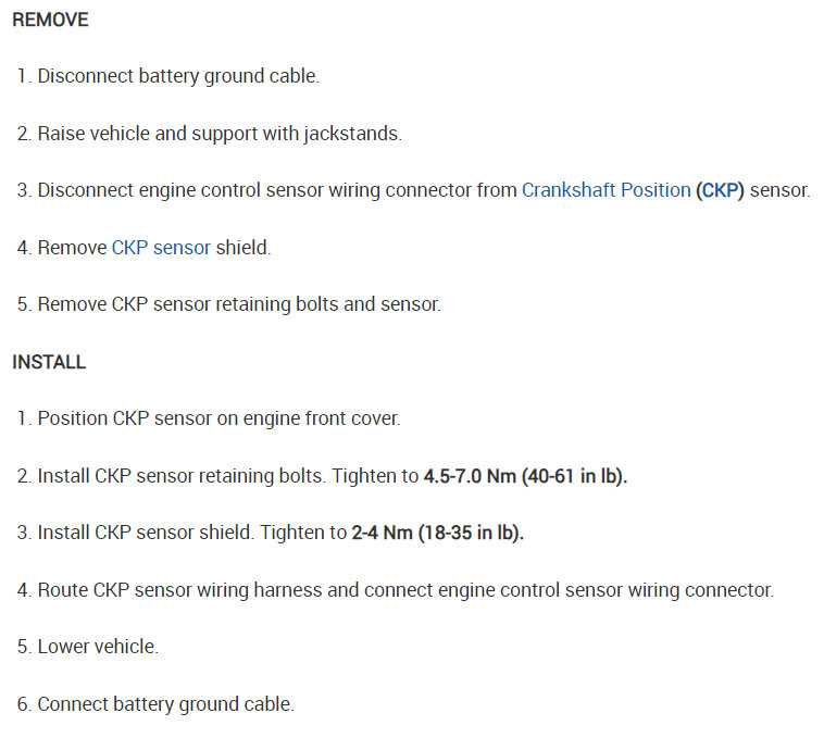

If no codes are present, I would replace the crankshaft angle sensor which will not leave a trouble code when bad. Here is the location of the sensor so you can swap it out.

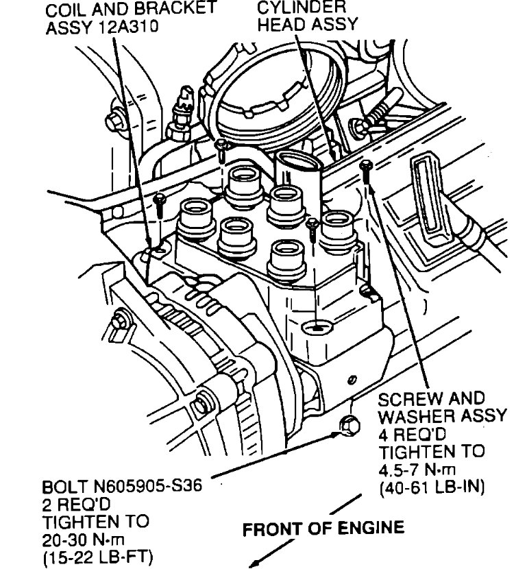

can a bad coil fluctuate?
Jul 19, 2024 at 6:47 PM
Yep, it sure can. These coils have a tendency to go out as well. Check out the images (below). Please let us know what happens.

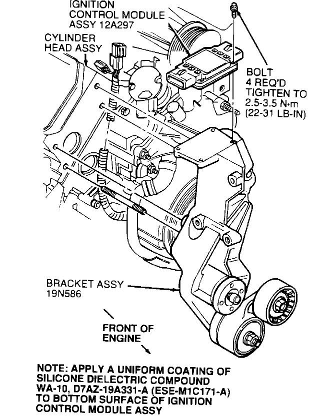

This must be a mid-year split, which can happen. the ignition module can go out and cause this problem, as well, did you run the codes? Here is the location of the ignition module, I would use starting fluid when the engine stalls to see if it starts up again. This will help us see if the problem is fuel or spark.
https://www.2carpros.com/articles/engine-stalls
