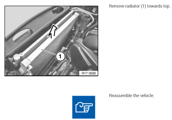

Would you be able to find instructions on removing this engine? I already gotten a bunch of stuff out but needing information on how to remove the fan and radiator than anything else, and if the radiator is needed to be removed

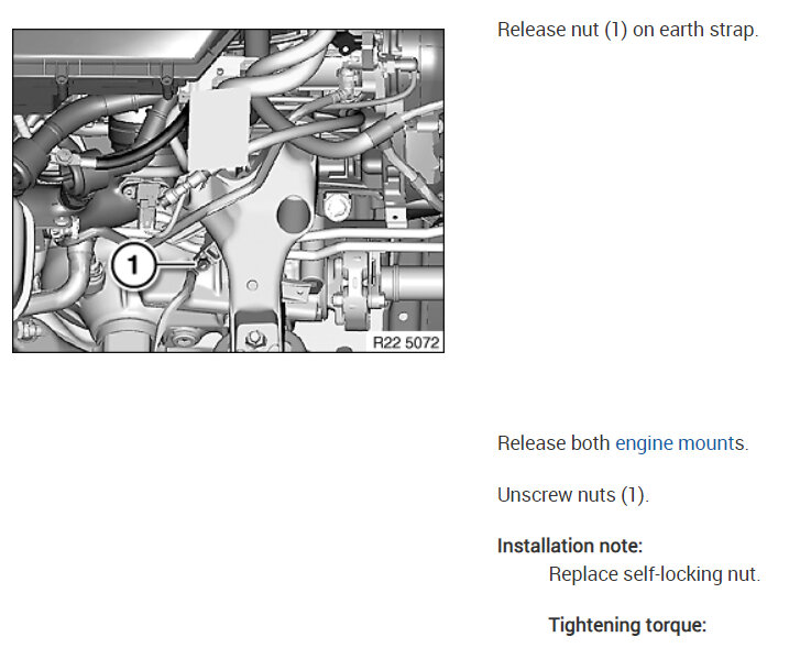

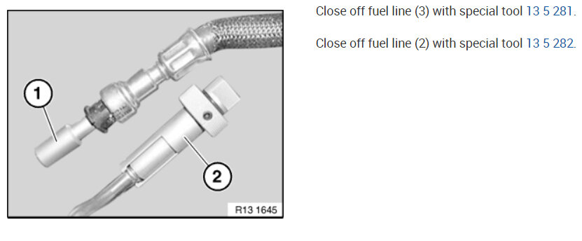

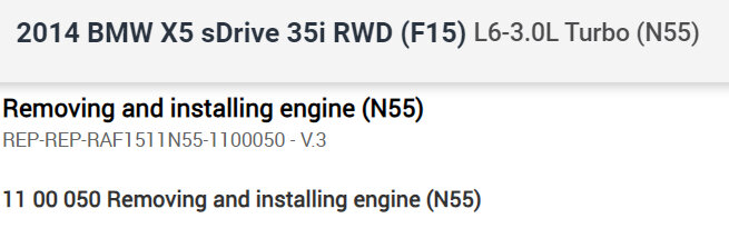

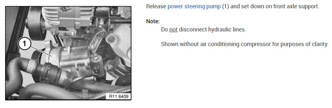

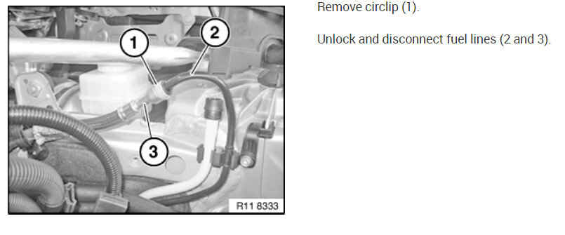

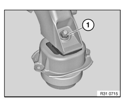

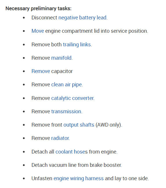

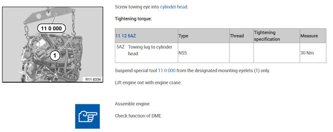

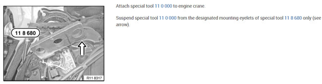

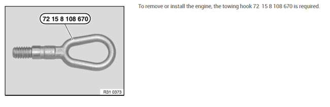

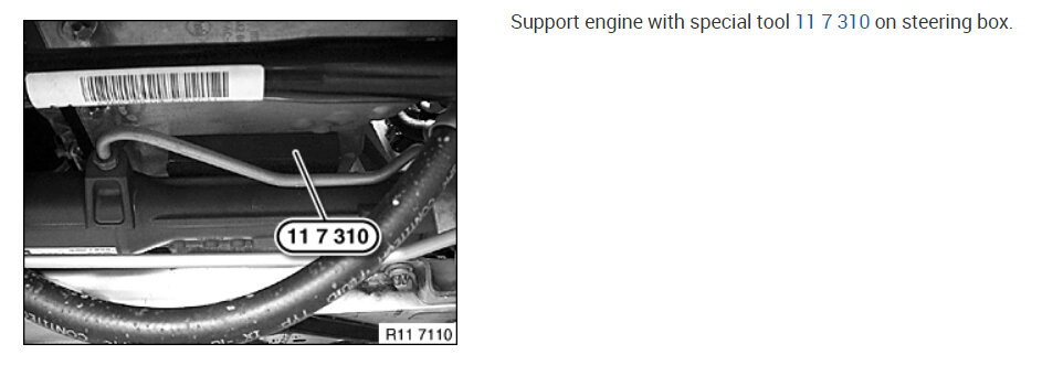

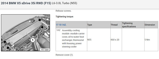

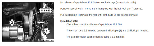

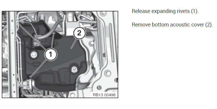

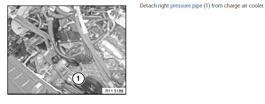

Yep, you will need to remove the hood, radiator and the transmission, here are the instructions to remove the engine and everything else that needs to be done to get the engine out of the car. Disconnect the battery before Check out the images (below). Let us know if you need anything else.

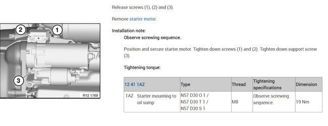

I removed torque converter bolts and all the above, can't find the starter, is it under the intake like most of these BMWs?

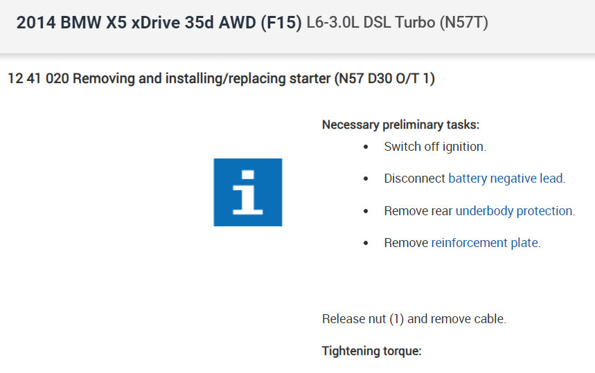

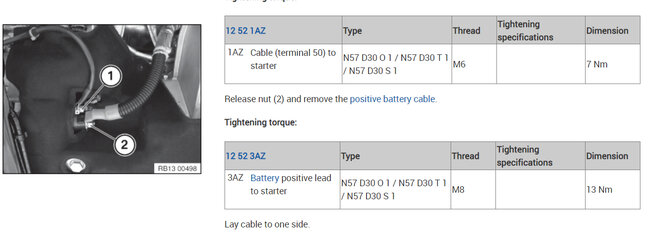

It looks like the starter motor is under a cover, check out the images (below). Please let us know what happens.

I found it under the intake. No, the one with the cover is for the n57 which is a diesel motor.
