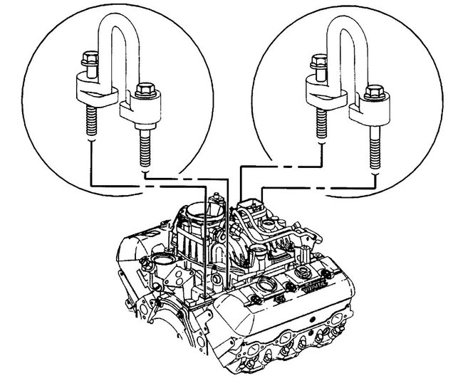

SPECIAL TOOLS REQUIRED (or equivalents)
^ J-41427, Universal lift bracket.
NOTE: This procedure must be performed on a side lift hoist. The engine and mounting frame will be removed out of the bottom of the vehicle, therefor, a single or twin post hoist can not be used to perform this procedure.

32. Install the engine lift brackets J-41427.
a. Remove the two right rear lower intake manifold bolts.
b. Install J-41427 engine lift bracket marked right rear.
c. Tighten the retaining bolts to 15 Nm (11 lbs ft).
d. Remove A/C compressor and accessory drive bracket.
e. Disconnect the EGR tube from the intake manifold.
f. Remove the two left front lower intake manifold bolts.
g. Install J-41427 engine lift bracket marked left front with the arrow pointing to the front of the engine.
h. Tighten the retaining bolts to 15 Nm (11 lbs ft).

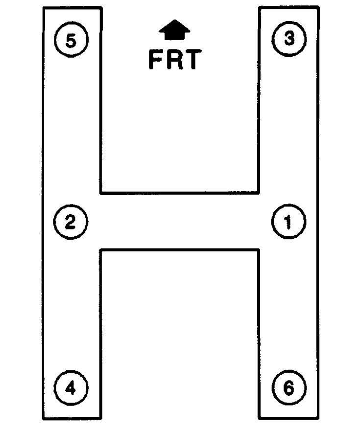

13. Frame mounting bolts. To ensure proper alignment of the frame to the chassis, the frame mounting bolts must be tightened in sequence to:
a. Center bolts to 155 Nm (114 lbs ft).
b. Remaining bolts to 90 Nm (66 lbs ft).
