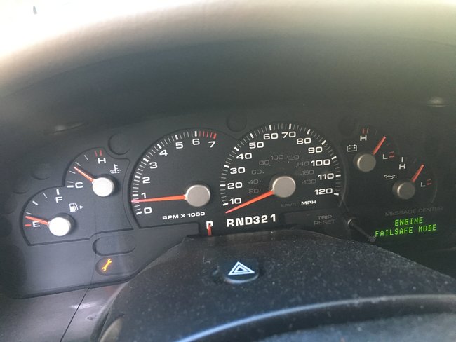

05EXPLODER94
  • 4 POSTS
Last Thursday I was driving home from work in a 35 mph speed limit zone, and I had to come to a stop because a truck thought he wasn’t going to make it under a railroad bridge. About thirty seconds later, he starts driving and I look down at my dash, and the “Engine Fail safe Mode” message displayed, and the car stalled. I was able to start it up and drive it home without further problems. Took it up the highway later that day, and no issues. Took it to a mechanic over the weekend and they couldn’t figure it out because it didn’t throw any codes. Drove it home from the mechanic with no issues, and to work this morning with no issues. Driving home today, down that same 35 mph speed limit road, “engine Fail safe Mode” displayed again, and the orange wrench light lit up like it did last week, but this time it didn’t stall, not even after coming to a complete stop in my driveway. Left the car running for a couple minutes and it still didn’t stall but the light was still on. I had a similar issue with it about five years ago where the message kept popping up very frequently and the truck would stall while slowing down to take a turn; it turned out to be the throttle sensor was bad, so we replaced it and all was fine until now. The only thing is the “check engine” light, or in my case, the “service engine soon” light didn’t come on, which explains why it didn’t throw a code. I can’t remember if that happened five years ago or not. Not sure what it is. Maybe I need a new sensor, maybe a new throttle body, not sure. The mechanic did say they cleaned a couple of the spark plugs, and said it could use a tuneup, but they said it wasn’t urgently needed. I don’t know if that’s causing this or what is. Hopefully I explained this well enough. Any help ASAP would be greatly appreciated, so I can either fix it myself or take it back to my mechanic to get it fixed. Thank you in advance for any assistance.
I included a picture of my dash with all the lights that came on. As you can see, no “check engine” or “service engine soon” light is on.
Jan 29, 2021 at 10:56 AM (Merged)
STEVE W.
  • 15,116 POSTS
Welcome back to 2CarPros. A common cause for this is the throttle position sensor on the throttle body. They start to act up but don't throw a code because the problem fixes itself so fast. First thing is to check the connector to it. They can get corroded inside and send odd readings. Next would be to watch the signal output on a scope and see if any drop out appear. Or just replace it and save the diagnostic work. A set of plugs wouldn't be a bad thing if they haven't been done in a while.
