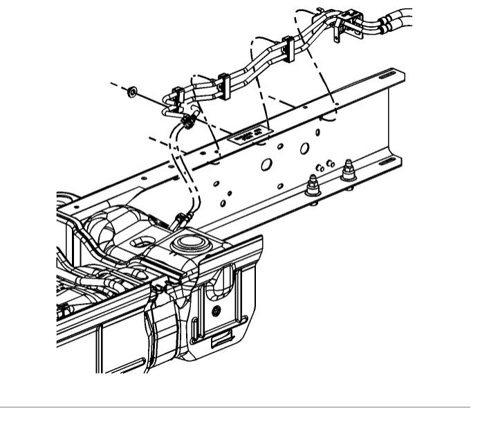

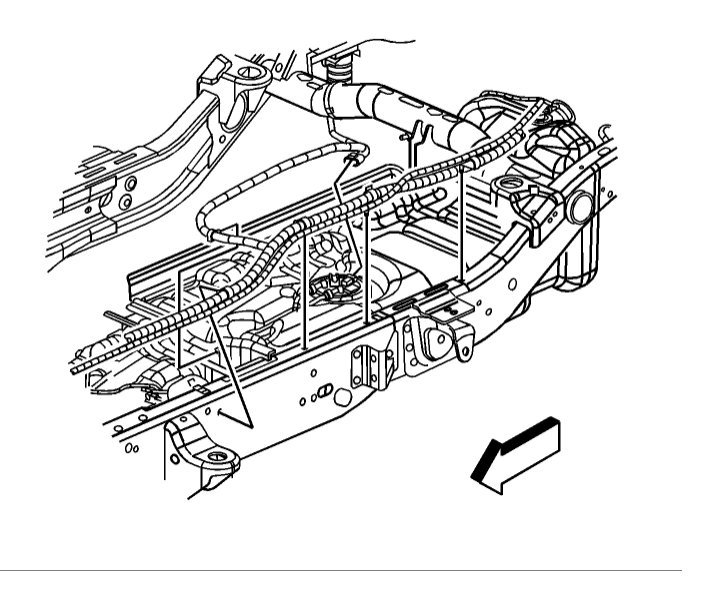

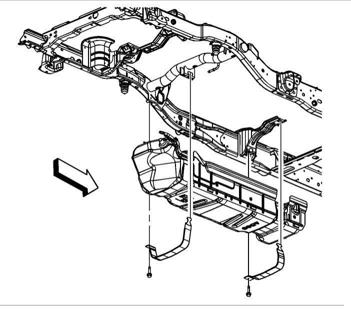

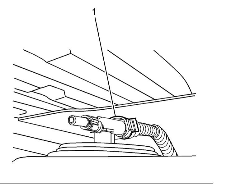

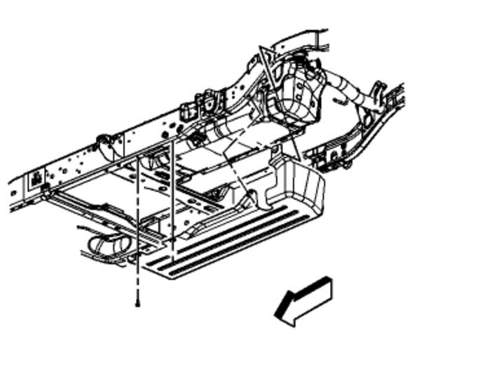

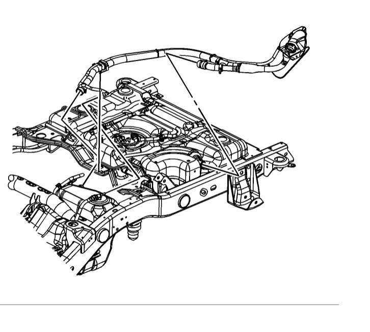

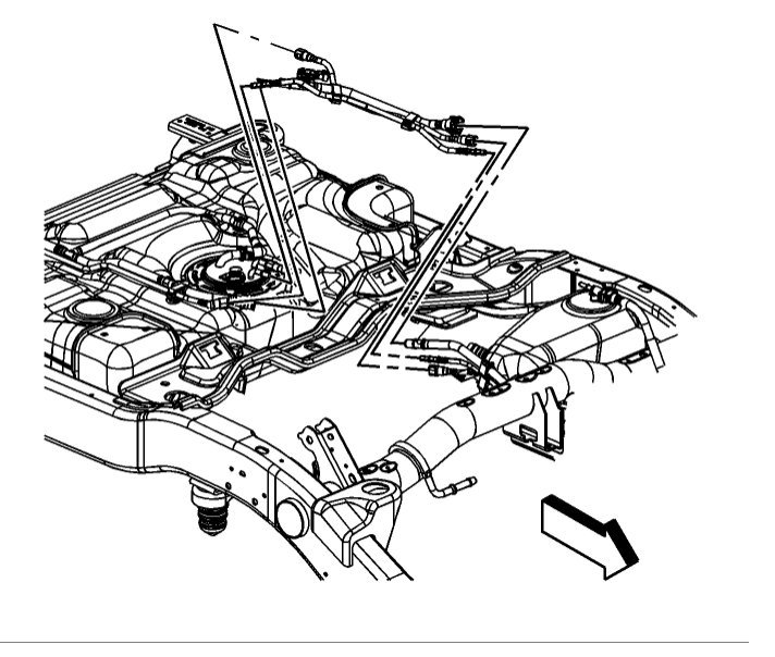

Yes the problem was the fuel pump, here is a guide that will show you what you are in for when doing the job and some diagrams (below) to help you.
You can get the pump from Amazon for about $215.00 AC Delco is the only pump I would install
https://www.amazon.com/gp/product/B0010GIDD4/ref=as_li_qf_sp_asin_il_tl?ie=UTF8&tag=2carprcom-20&camp=1789&creative=9325&linkCode=as2&creativeASIN=B0010GIDD4&linkId=d4a5b5ff36826f6571e1307245773115
Drain the tank first, watch this video.
https://youtu.be/Q5MH2gnyFH0
Jun 26, 2017 at 12:04 PM

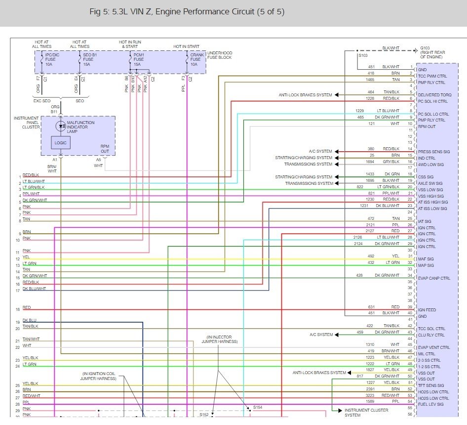

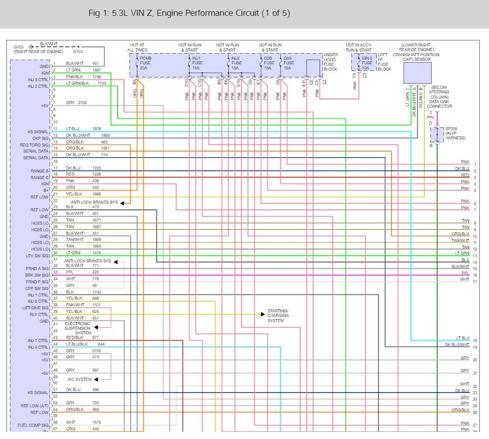

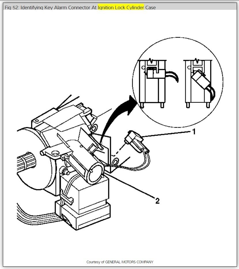

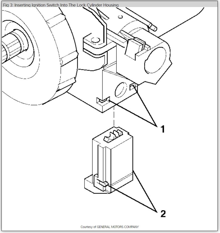

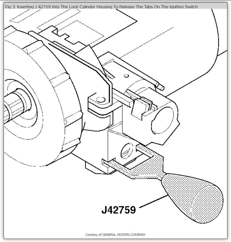

A couple things come to mind, first is the crankshaft angle sensor which will stop the injectors from working, here is a guide to help with that.

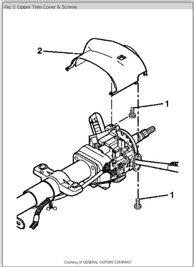

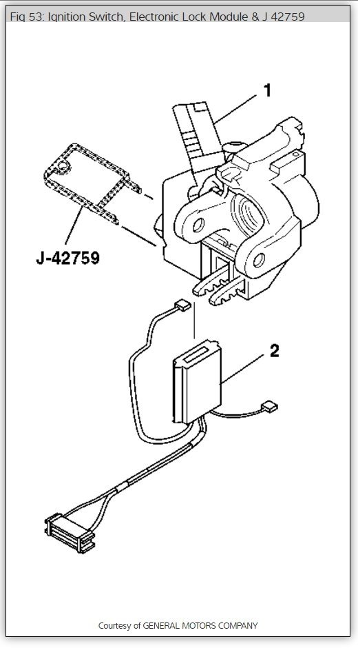

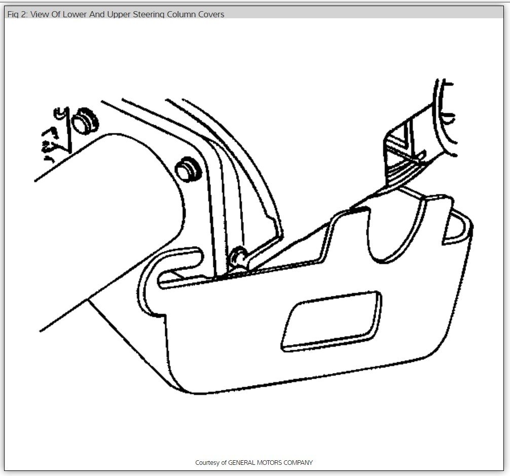

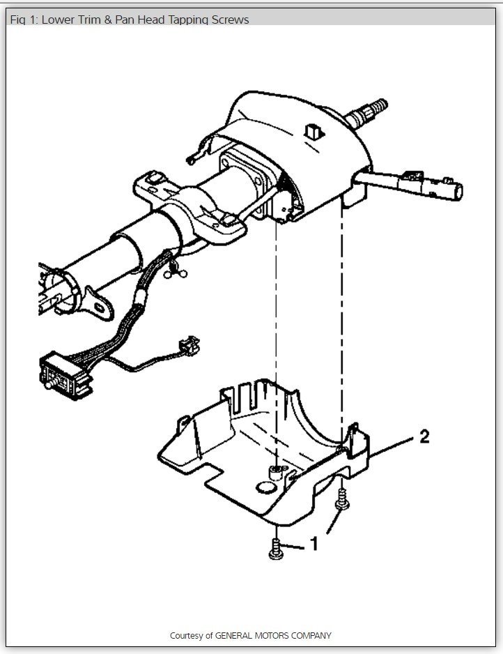

and it you may have an ignition switch going out as well.
Here are some diagrams (below) on how to change the switch out.
Please let us know what happens, we are interested to see what it is.
Jul 9, 2020 at 1:54 PM (Merged)

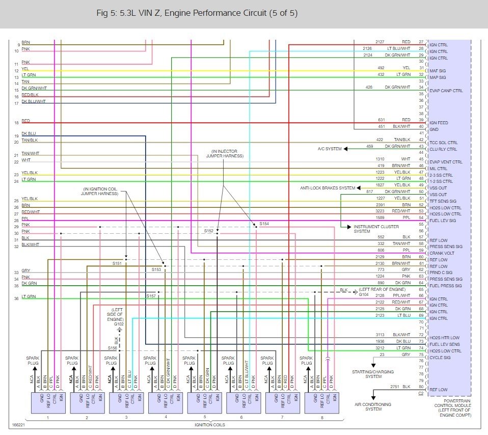

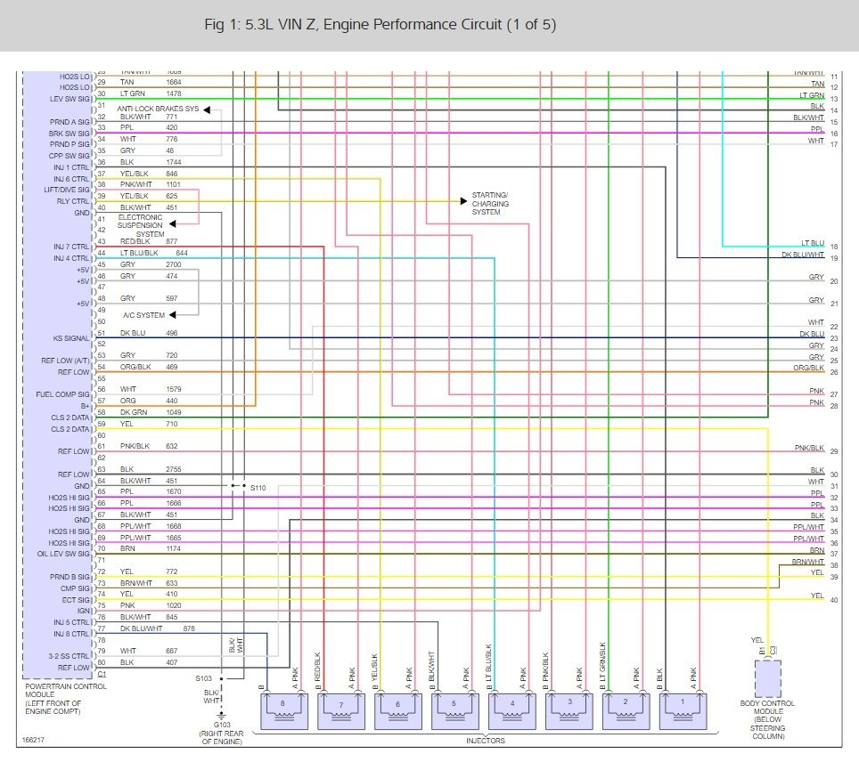

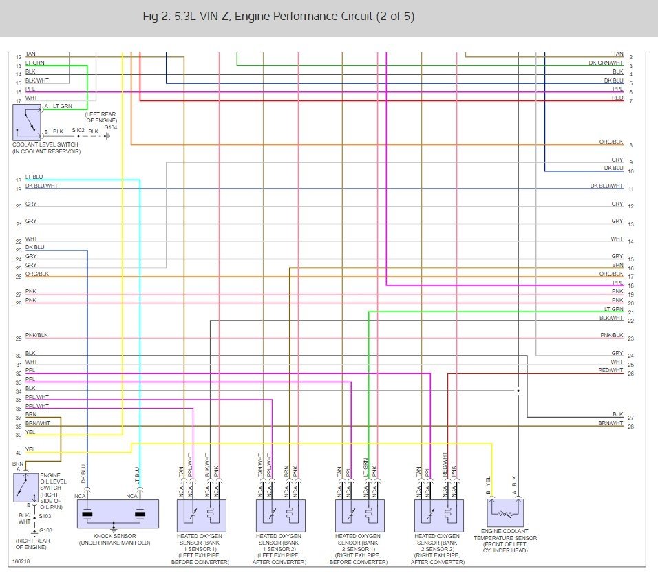

OK, it stalled after this sensor change and after a few days of it working great it sat for 24 hours and now it won't start at all. I am not getting any spark at all 8 plugs using a smart tester. Juice is getting to the coils tho ..... I also have 55psi fuel pressure and all inspectors are pulsating the noid testers. any other ideas?

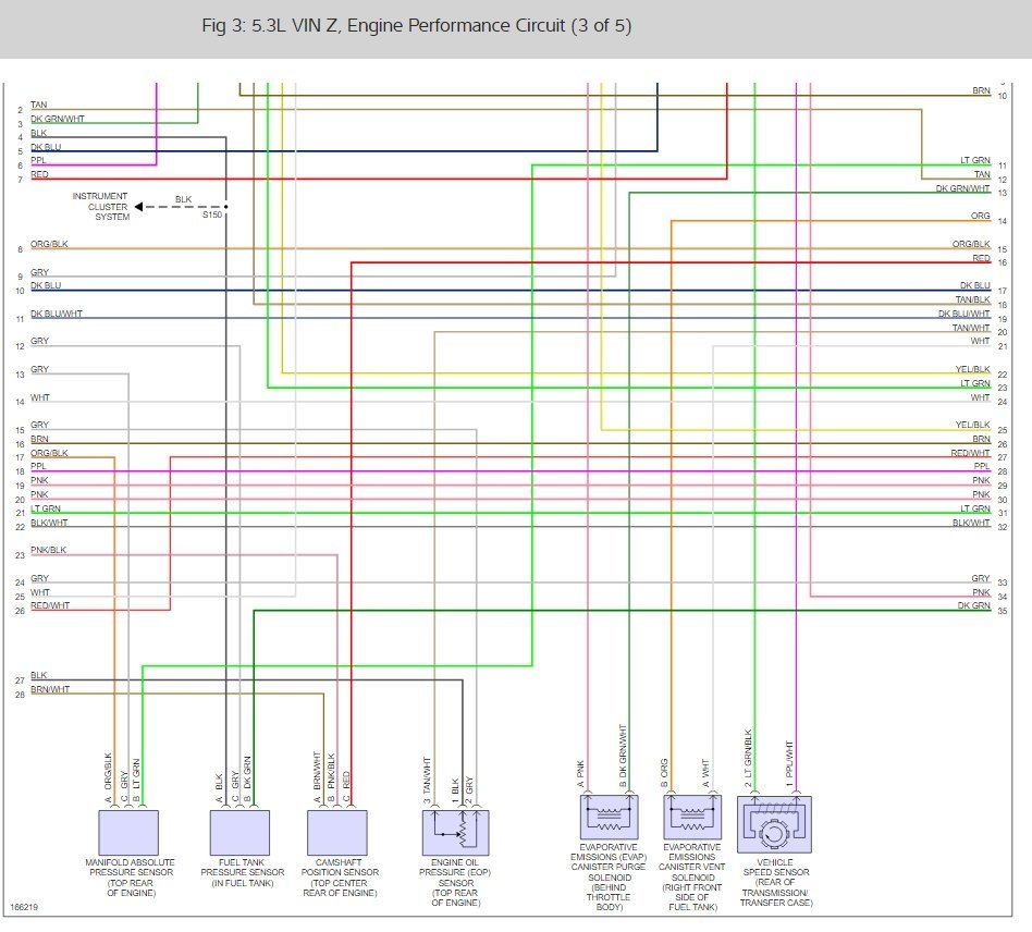

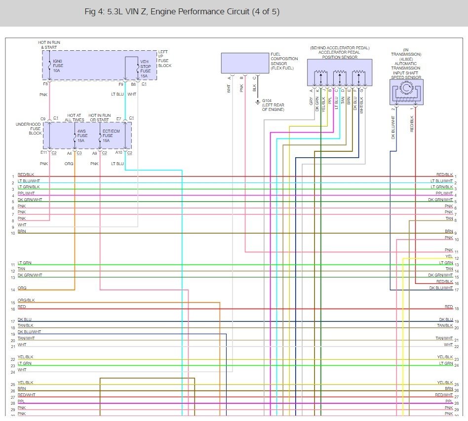

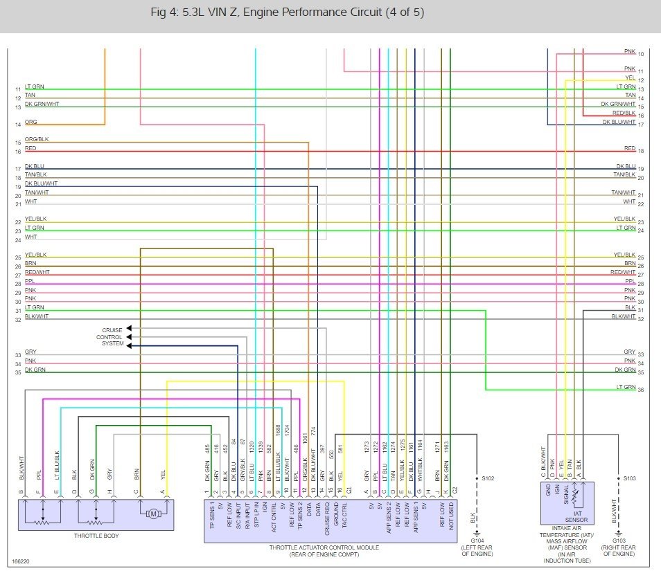

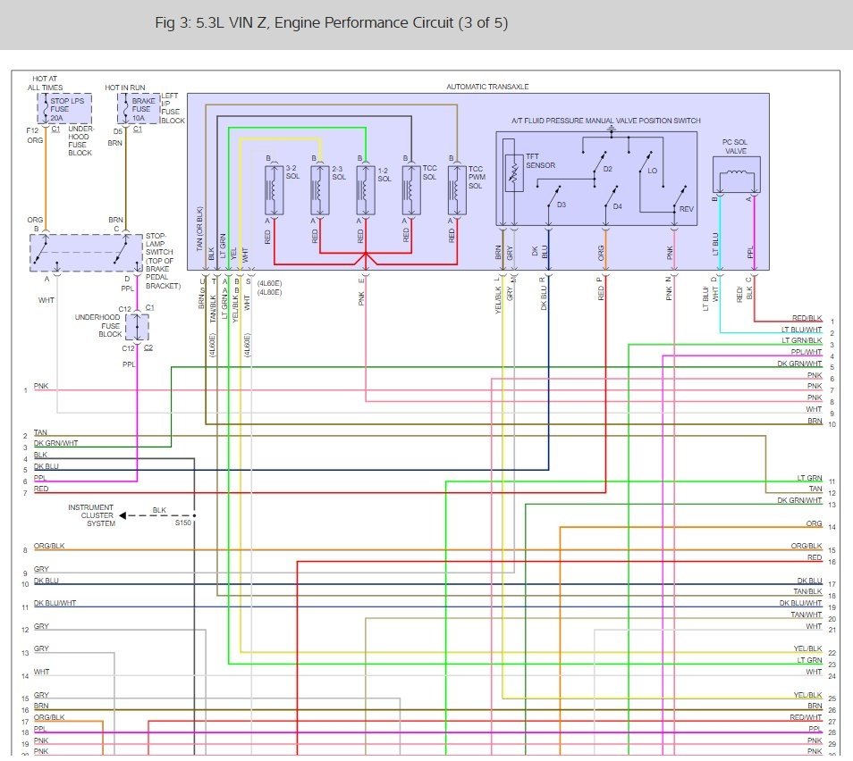

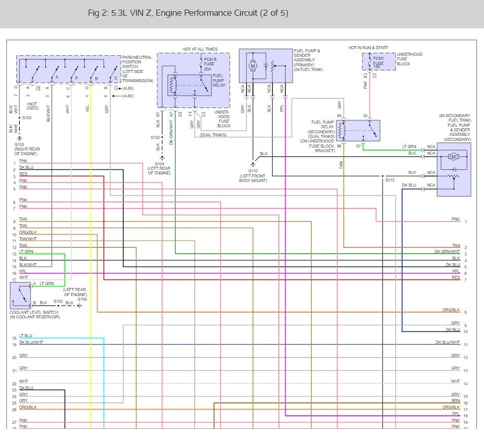

A couple things come to mind, first is an oxygen sensor that can be shorting out, please disconnect all of them and try to start it.
Here is the engine wiring diagrams (below) and some guides to help you test for power in the system
and
Please run some tests and get back to us we are interested to see what it is.
