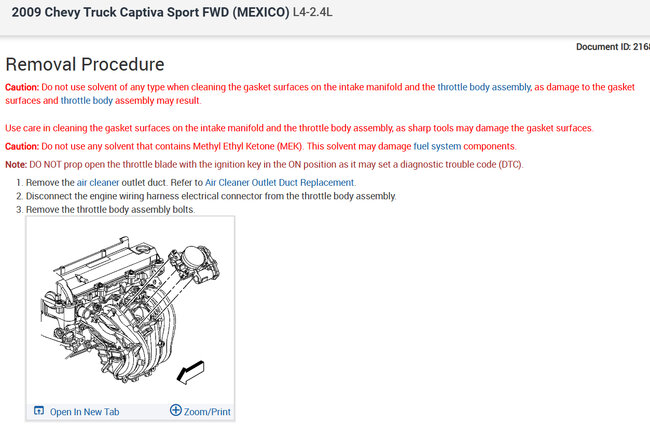

Here is how to service the throttle body which should be done as a normal service. This guide you can use as general instructions:
Check out the images (below). Let us know how it goes.
