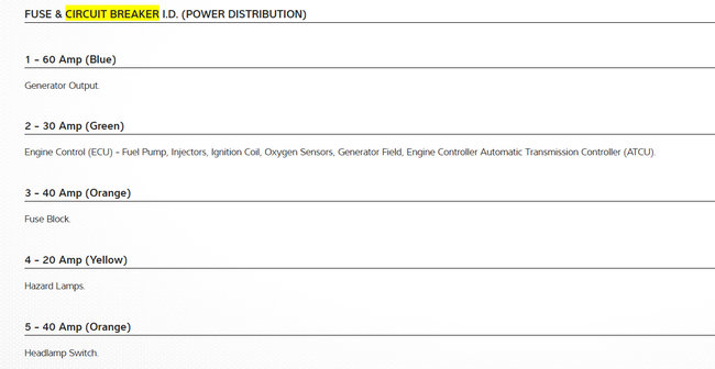

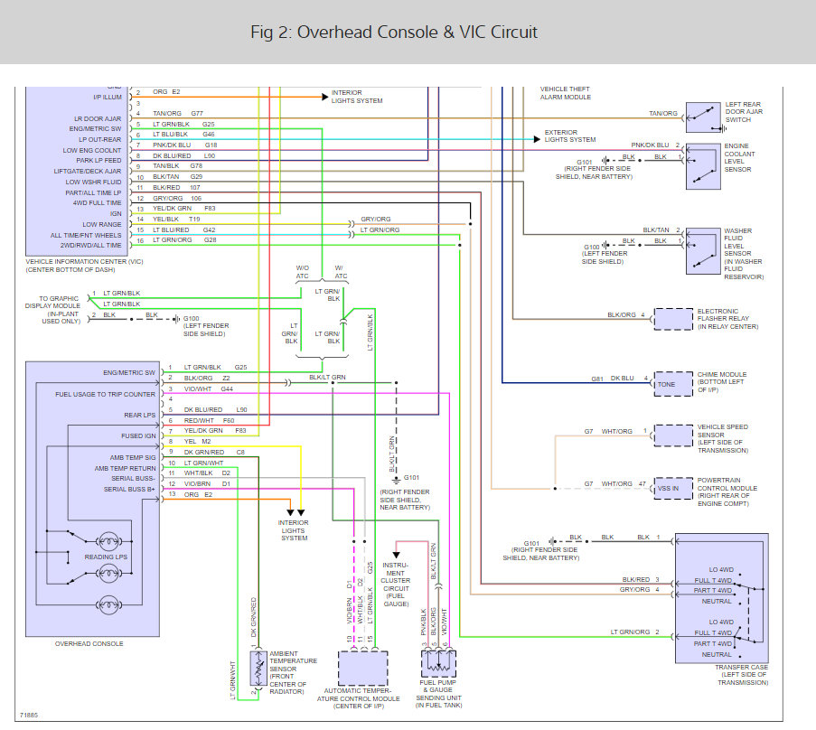

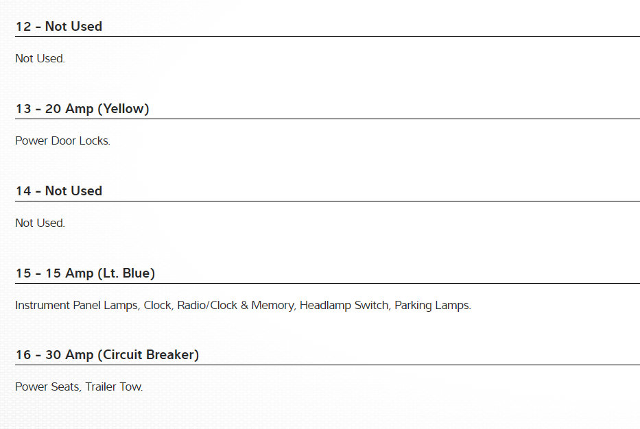

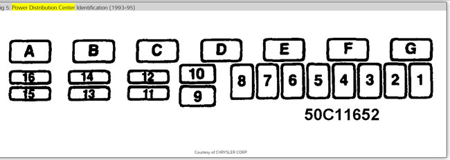

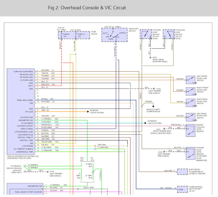

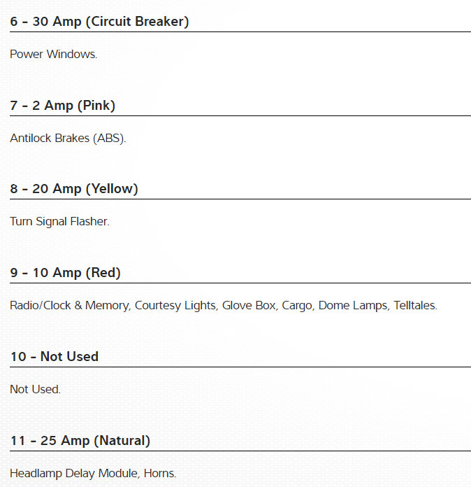

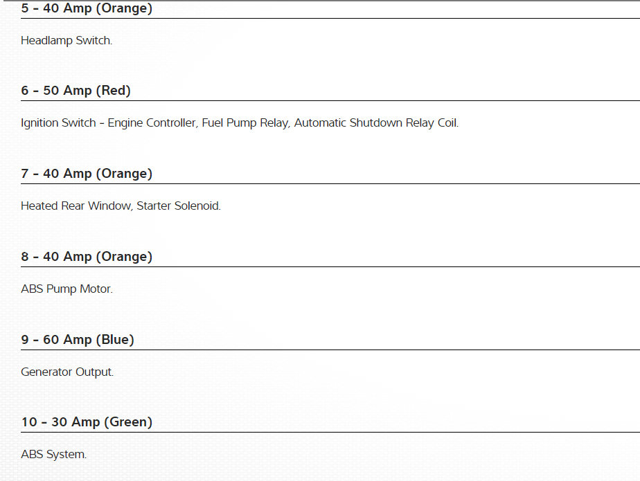

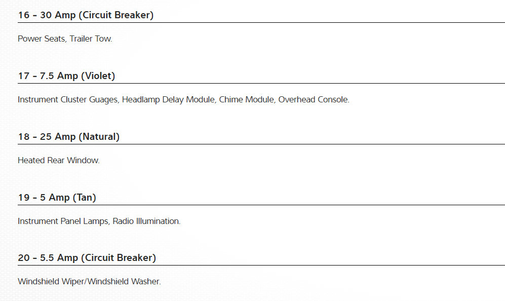

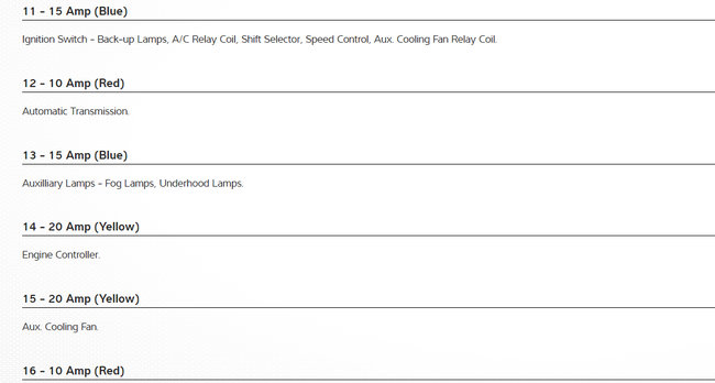

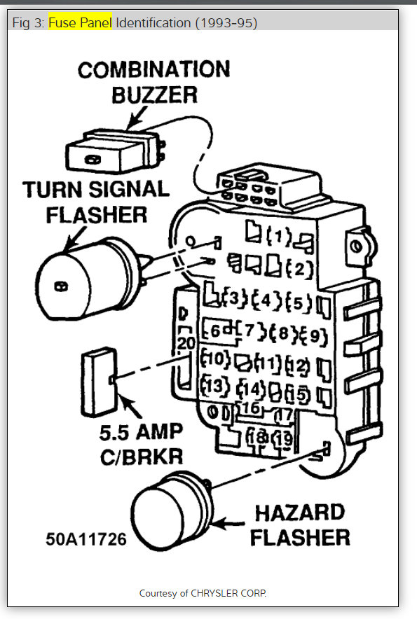

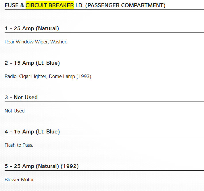

It sounds like you lost power or ground. Here is a guide to help you do testing and the wiring diagrams so you can see how the unit works. Check fuses # 8 and #19.
Test power and ground easy! Check out the diagrams (below). Please let us know what happens.

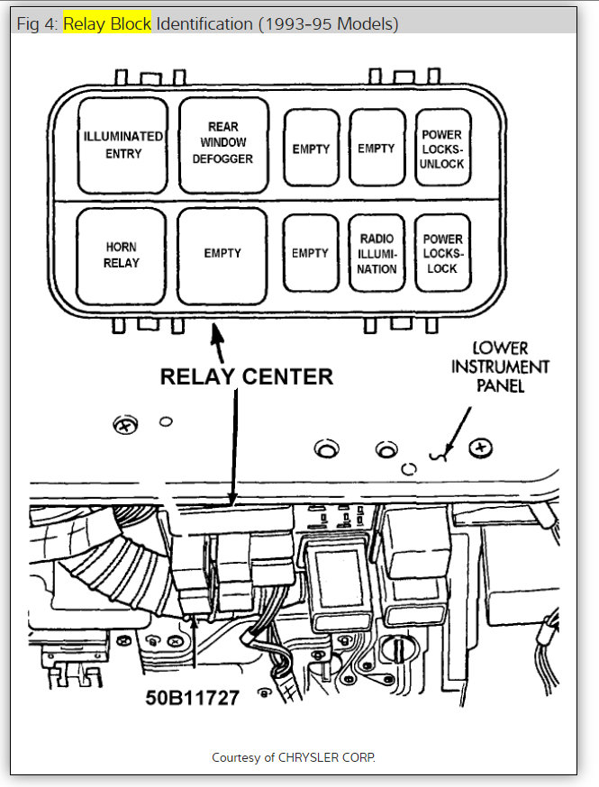

Is this module controlled by both a relay and a fuse? If so, where are these located (I.e. under the hood or in the car cabin)?
