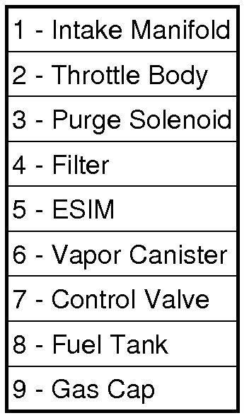

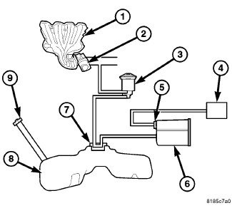

EVAP parts. Common leak points on these are the ESIM valves and the purge solenoids stick. Unless you live in a rust belt state, then the lines get pinholes, five minutes on a smoke machine and the leak should show up.

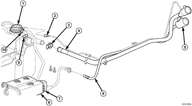

Finally got the smoke test performed on my Wrangler. The test revealed that the leak associated with code 0456 was at the rollover valve on top of the gas tank. I cannot find a replacement rollover valve, primarily because I don't know where to look (I'm old!) The mechanic told me that, when he touched the hose fitting, the valve broke off. I must assume he meant one of the three fitting arms of the molded roller valve where the hose attaches(?) He told me he does not know the name of the part nor where to find a diagram of it. He's not around to ask since this is elk hunting season in New Mexico! I went to the Jeep dealer in my home town, who is known for ripping off customers, and asked the Service Manager the name of the part. That is where I was told that it is the rollover valve. Where can I get a replacement for my 2010 Wrangler Unlimited Mountain?
Dec 2, 2017 at 10:22 AM
STEVE W.
  • 15,113 POSTS
I will guess he means the part number 1. It appears it is a part of the tank itself as I don't find anything to show a separate part number. 52059729AN is the part number for the complete tank, looks to be about $600.00 new. You might want to see if you can find a good used one. Or see if the stealership can get a replacement valve.

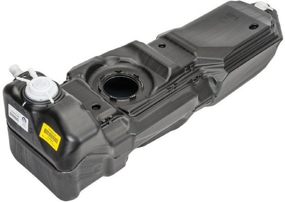

I like your term: "stealership"! I checked with a Jeep stealership and was told that the rollover valves are/were permanently glued in place at the manufacturer, hence, there is no part number for them. I was quoted over $800 without any mounting hardware or labor! I'm retired and am on a fixed budget. I cannot do that amount without severly hampering my household budget! I The Chilton Jeep Wrangler 1987-11 Repair Manual shows the gas tank with the two rollover valves. Does that mean that any model of the Jeep Wranger between (and including) 1987-2011 has the same gas tank? If so, I'll research if there are any used parts places in Albuquerque to try and locate one.
Dec 4, 2017 at 10:55 AM
STEVE W.
  • 15,113 POSTS
The tank you need fits a 2007- 2017 Wrangler 4 door with 4 wheel drive.
52059729AN is the Jeep part number.

I did some more research on the gas tank, and found a new one for $500+ at rockauto.com; however, I went to see the mechanic and suggested what you had in the above (previous) exchange. He actually like the idea and said (after the Holiday Season expenses) will drop the tank, drill into where the damaged nipple was, and epoxy-in a brass nipple for about half of what a new tank would cost me. Thanks. I'll let you know the result after the work is done.
Dec 9, 2017 at 10:38 AM
Be wary of epoxy repairs they tend to leak. Let me know how it goes. Happy Holidays!
Dec 9, 2017 at 2:58 PM
DUUGAN
  • 13 POSTS

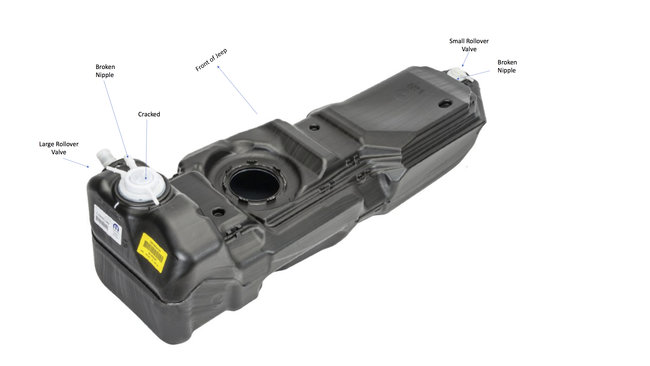

After reading your remarks, I decided to order a new fuel tank, although quite expensive. It arrived over the holidays so I didn't get to take it to the mechanic until 2 days ago. The tank has two rollover valves: a small one and a large one. When we unpacked the new tank, the large rollover valve was cracked and the largest nipple on it was broken!!!
Another look at the damaged (broken nipple) of the original tank revealed that the nipple was still inside the sensor hose. So, my mechanic put a metal schunt in and epoxied it. A $60 dollar fix that I hope lasts!
