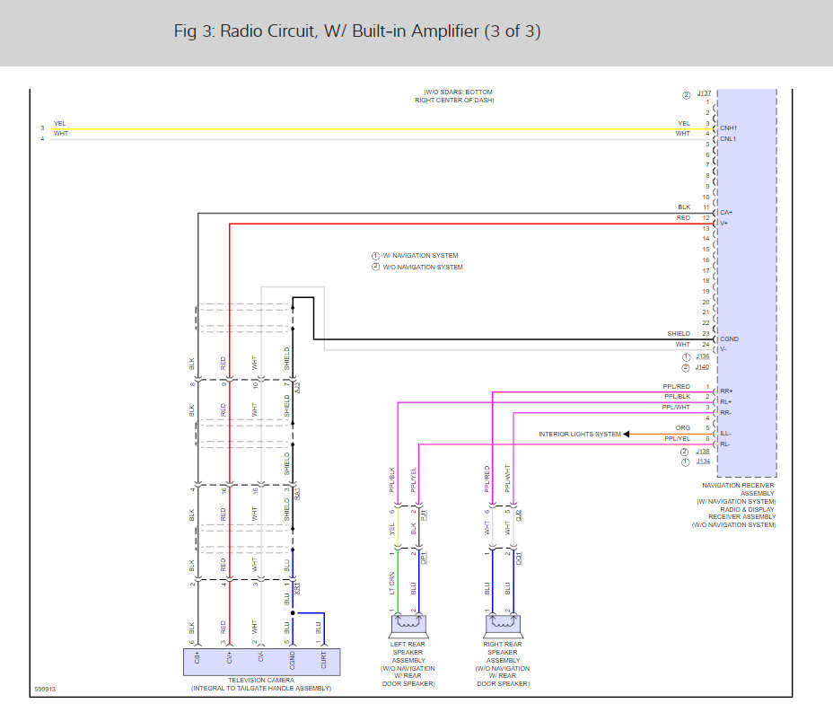

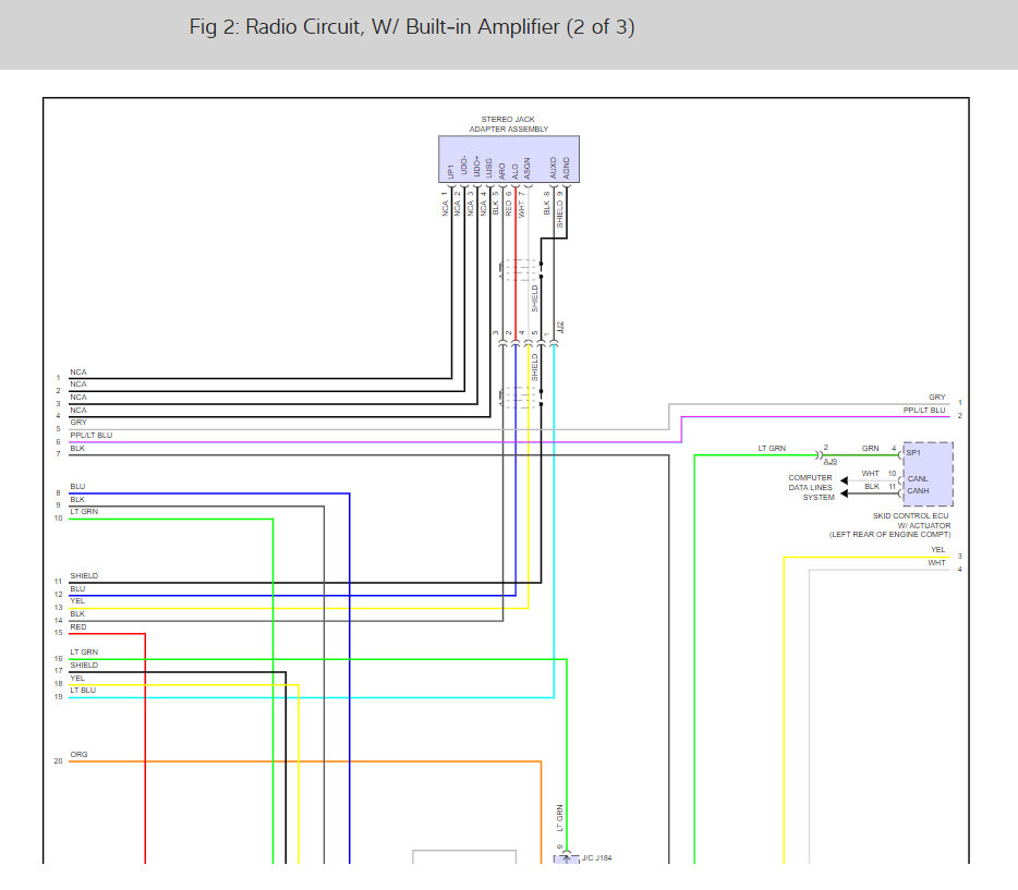

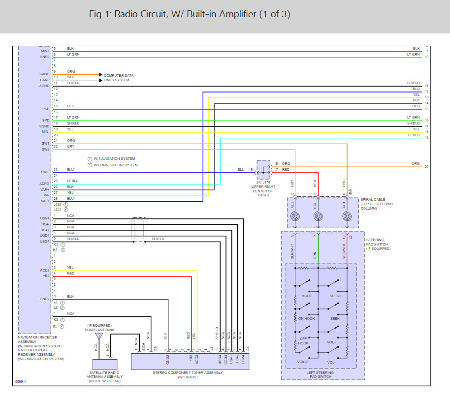

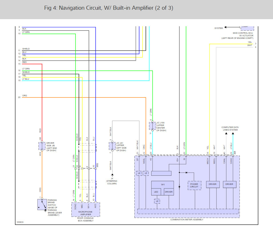

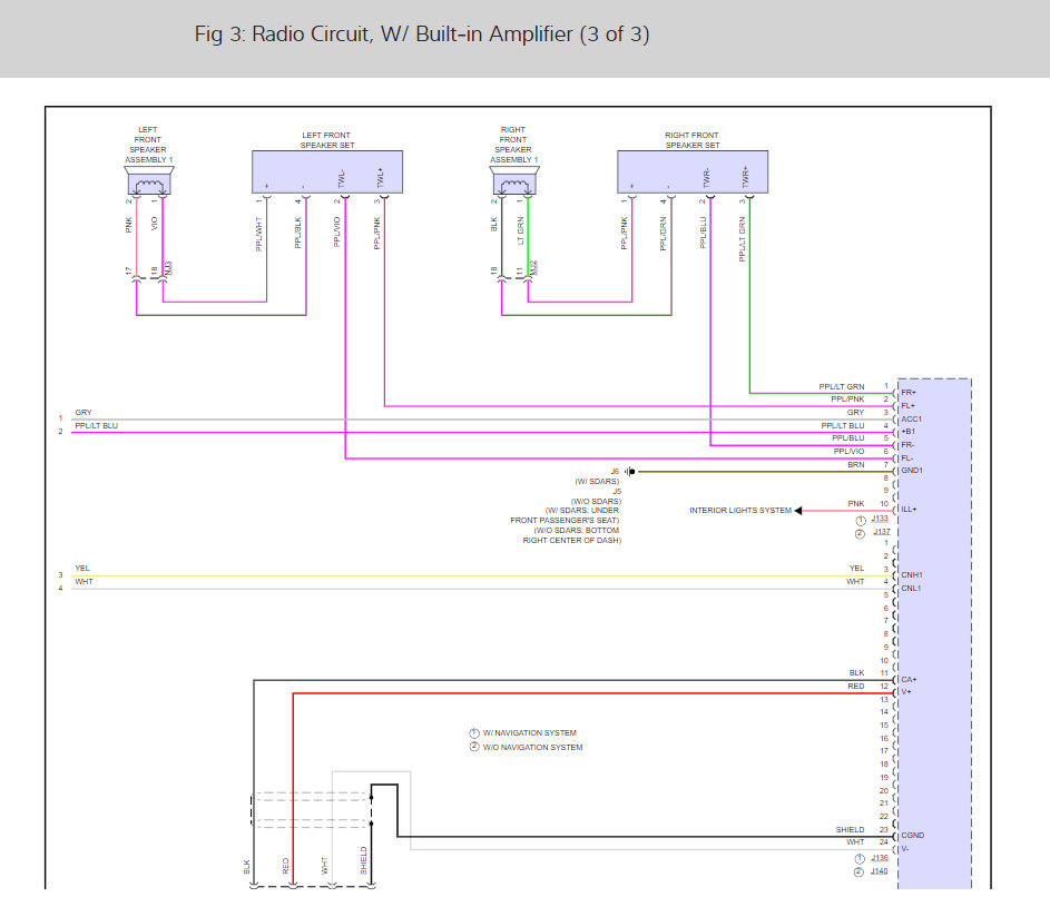

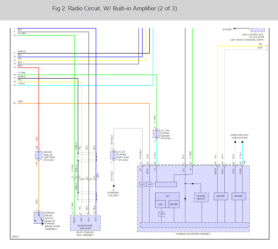

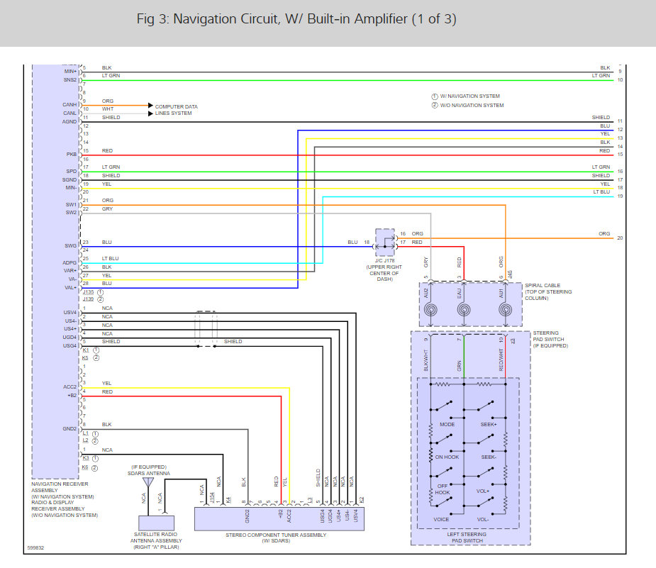

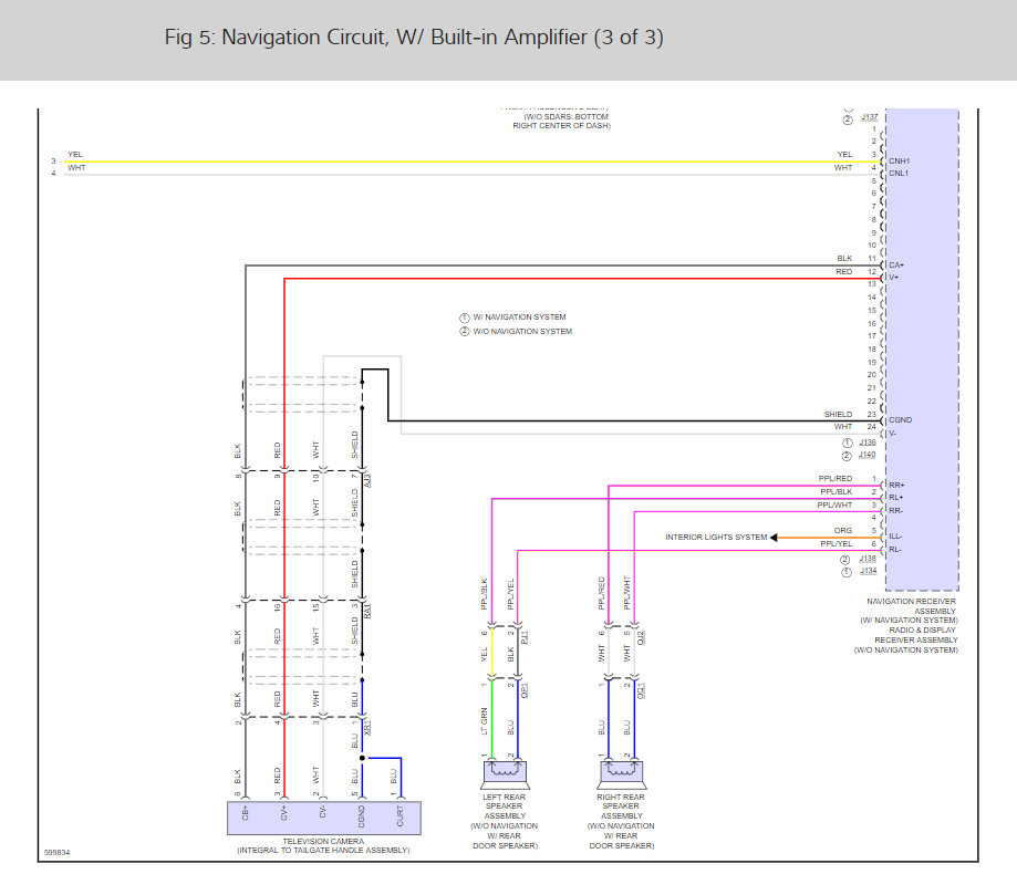

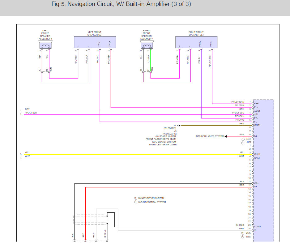

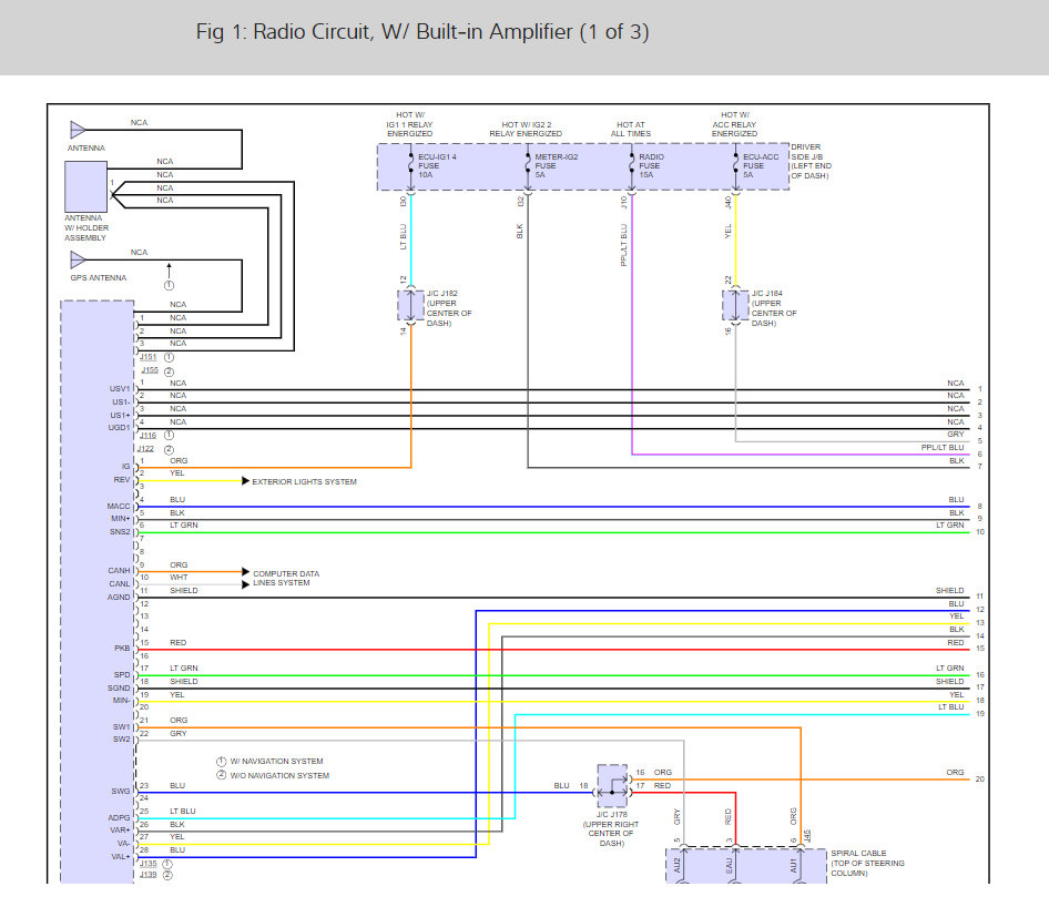

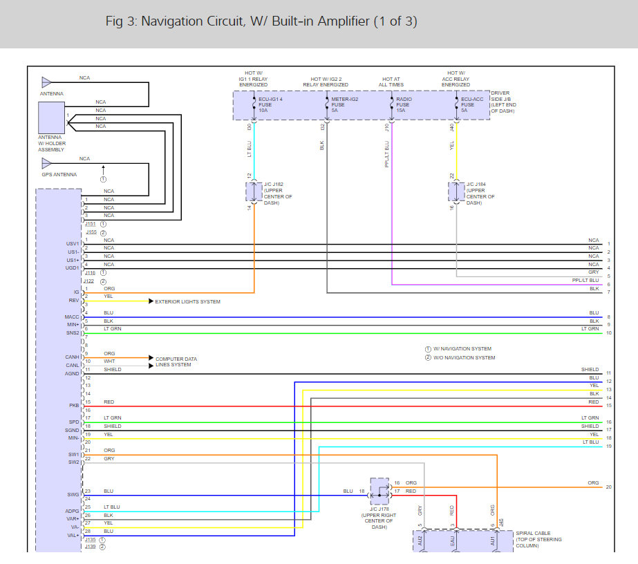

The back up camera is driven by the navigation system and is pretty straight forward. is there a chance you got a defective radio? I would check for a pulled pin in the aftermarket wiring harness. Here is a guide to help you test the connections and the radio/navigation and back up camera wiring diagrams to help with the testing and so you can see how the system works:
