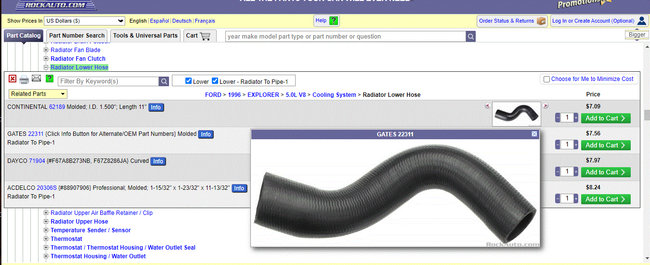

Okay, I attached a picture of the hose. Is this the hose you are using?
https://www.2carpros.com/articles/replace-radiator-hoses
Sep 8, 2020 at 4:54 AM

That picture looks pretty accurate. I'm using the hoses for a 1996 Explorer. I just ordered a new set that should arrive promptly.
