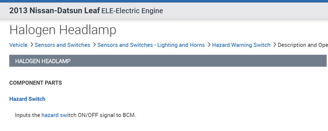

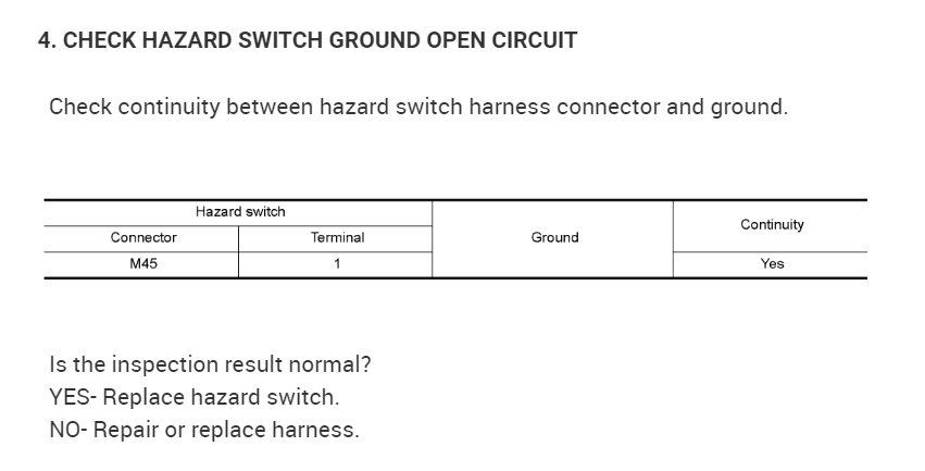

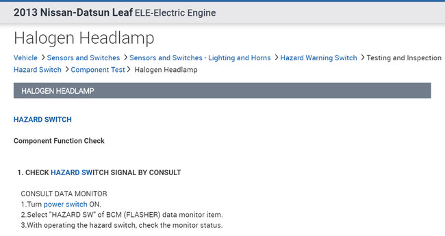

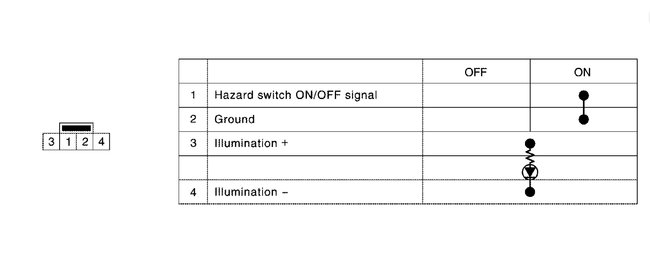

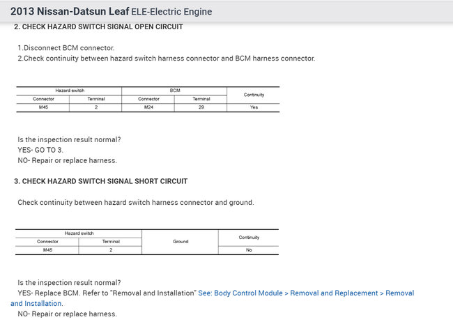

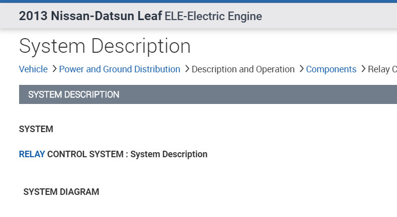

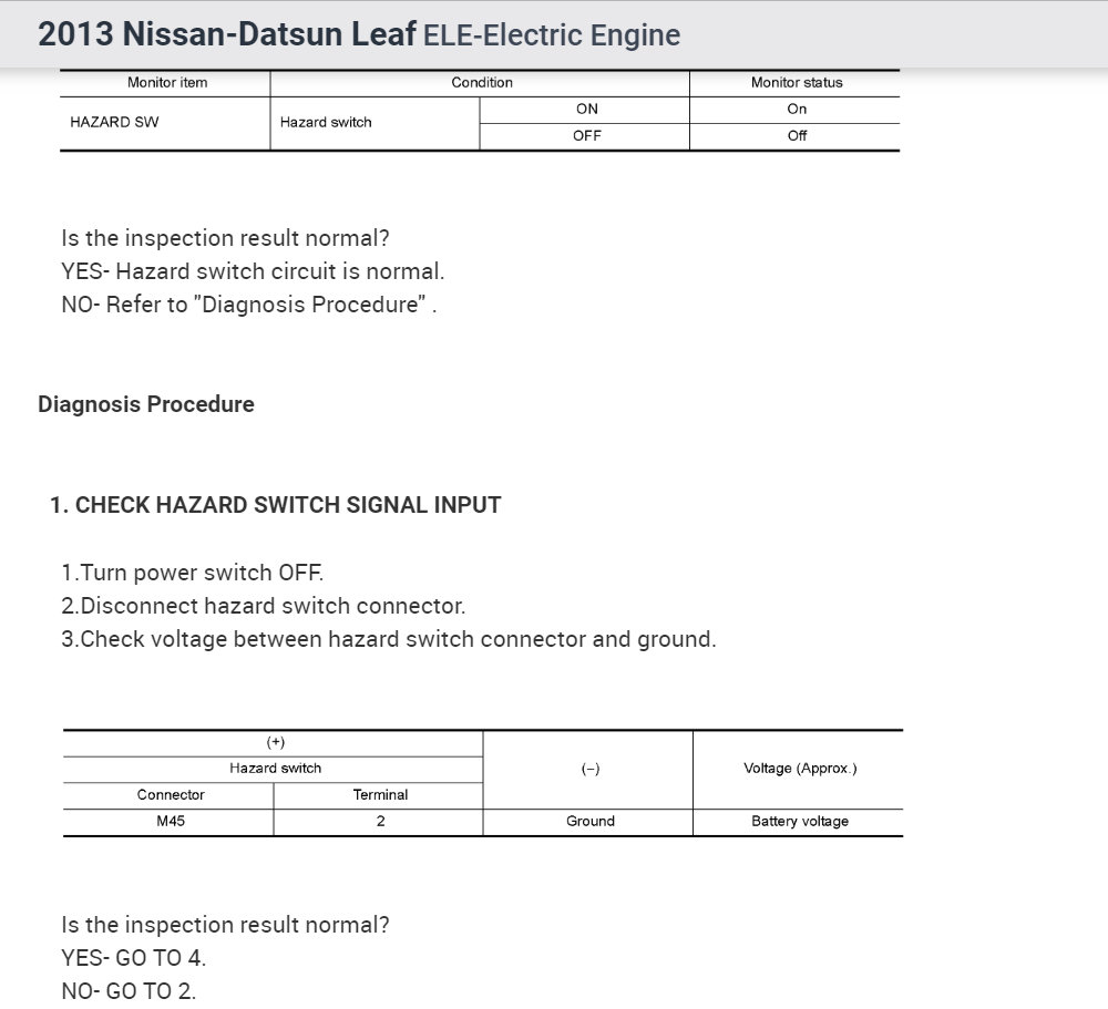

The hazard switch is the relay for your vehicle. I have included in the diagrams down below the operation and a factory diagnostic troubleshooting guide for the hazard switch in your vehicle. Please go through this guide and get back to us with what you are able to find out.

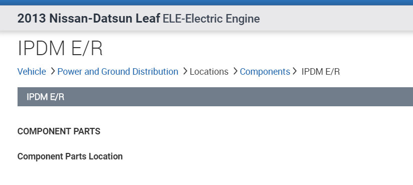

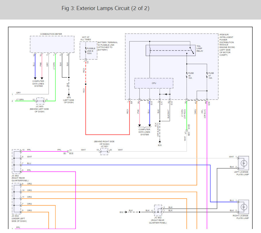

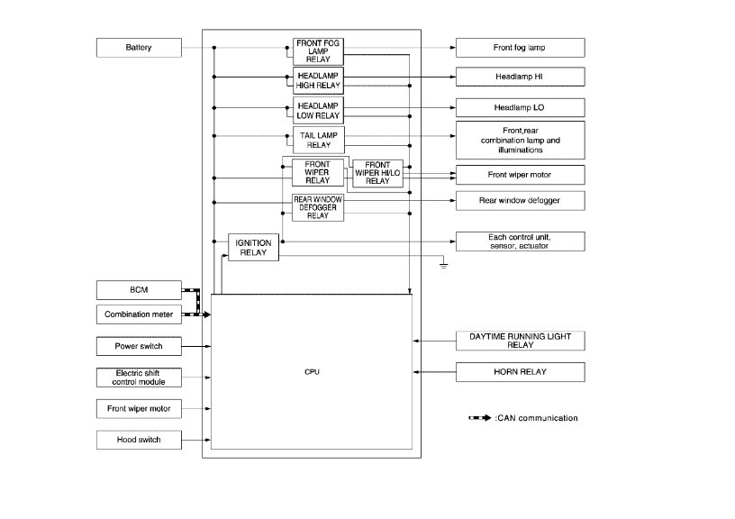

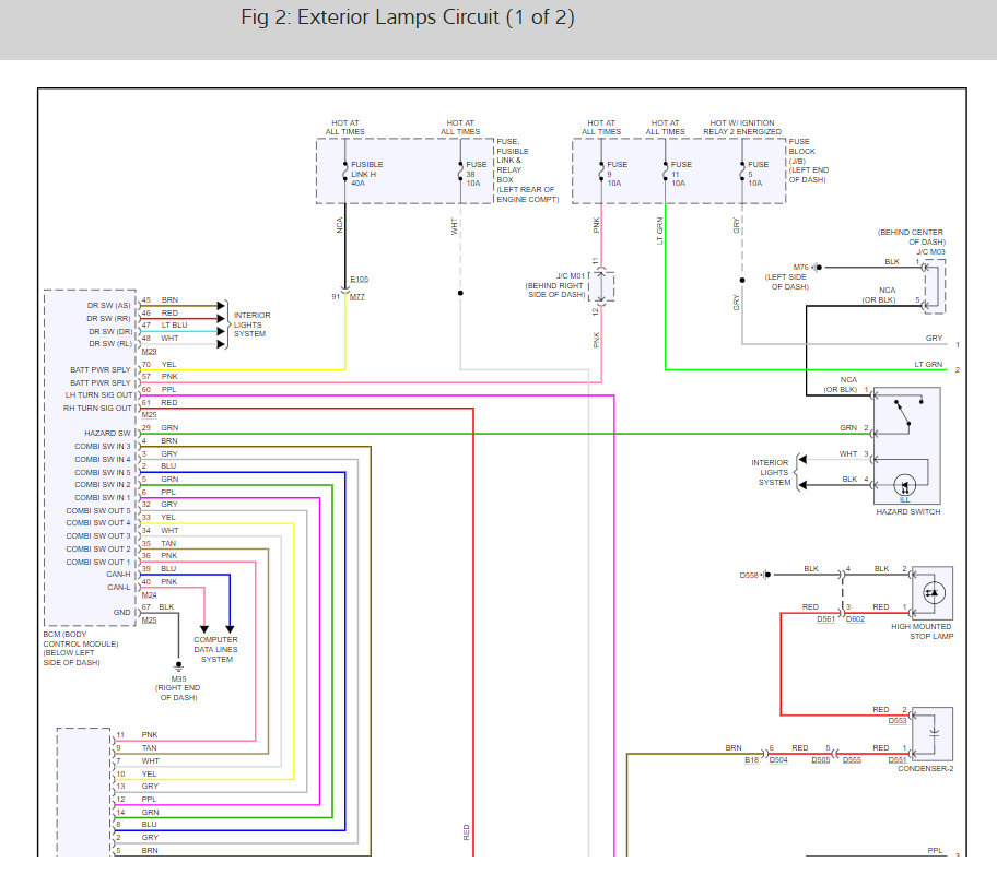

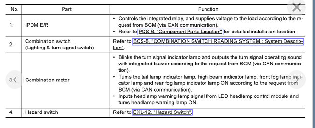

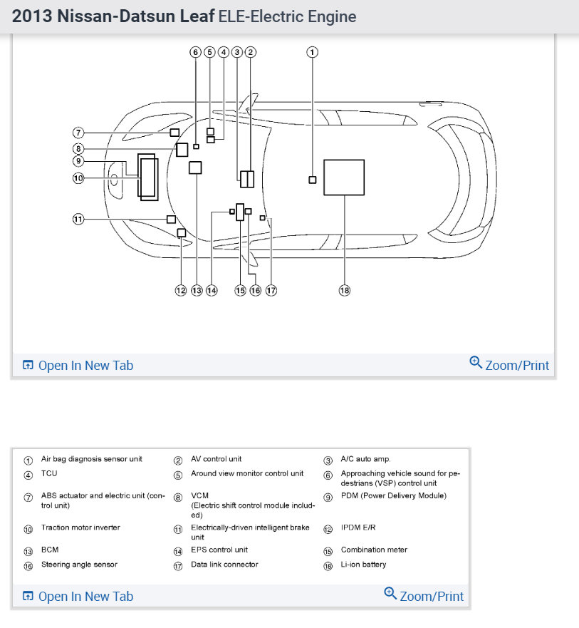

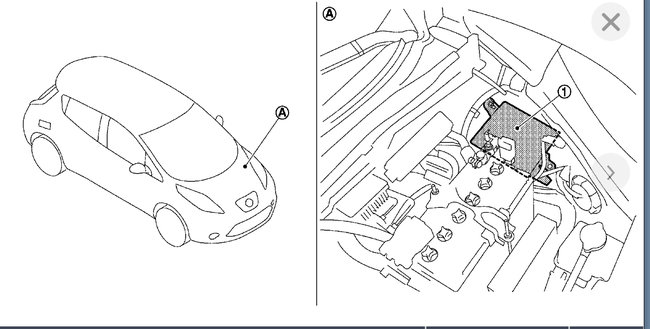

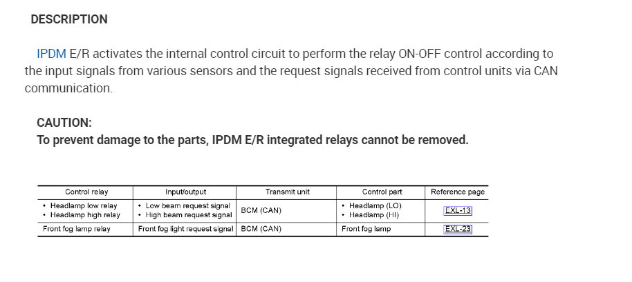

No, you asked the right question, it's the answer that is throwing you off. There is no hazard/turn signal relay. It is done through the hazard switch, combination switch, Integrated Power Distribution Module (IPDM), Body Control Module (BCM) and Computer Area Network(CAN) system. I have included the description of how everything works together in harmony in the diagrams down below. If you get lost, like I did, read it again. It kind of makes you wish they would have stuck with a relay. That's just my opinion. Anyway, there it is. Please keep us informed.

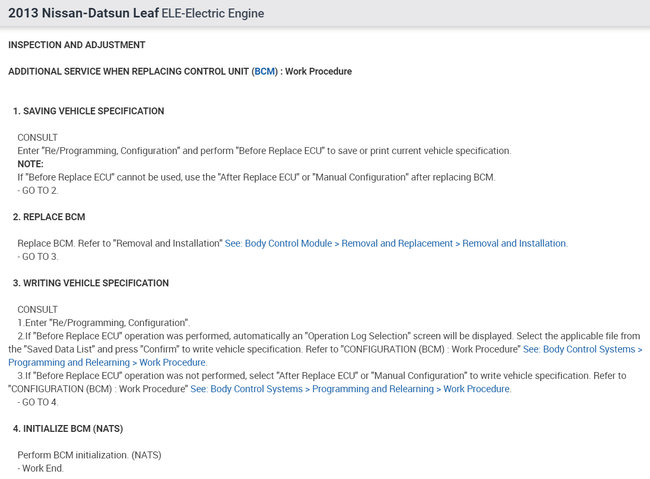

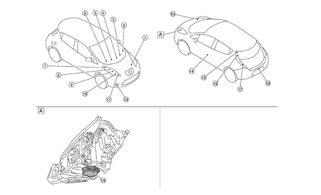

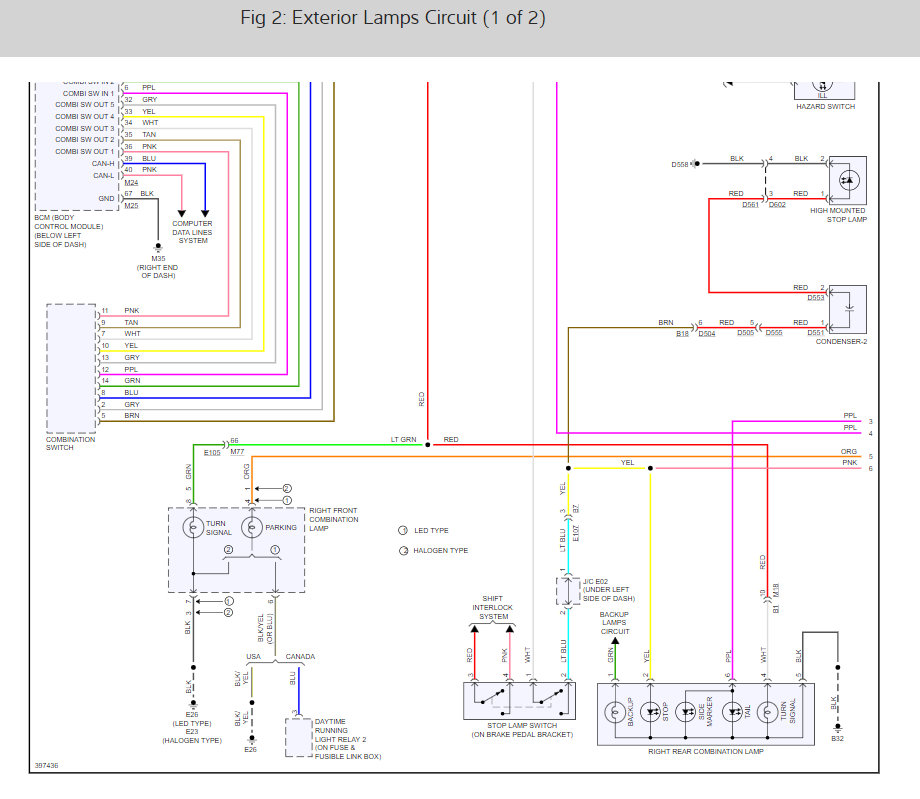

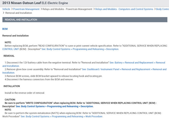

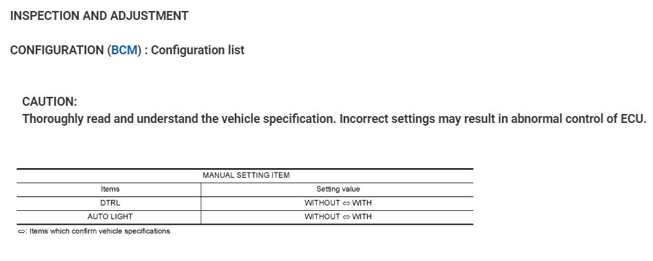

Please do not solider a flasher in you will create more problems. this car does not have a flasher. I looked into the problem a little more and it looks like the BCM control the flashing. here are the blinker wiring diagrams so you can see how the system works and instructions and diagrams below to show you how to change out the BCM. Check out the diagrams (below). Please let us know what happens. There is no shame here, we all get through it the best we can :)
