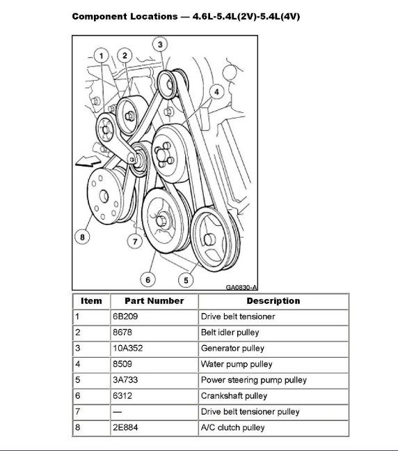

I need instructions on replacing the serpentine belt in my 2005 Expedition. I can't readily see the tensioner nor is there anything I need to remove as there isn't much room between the engine and the fan.
Jul 6, 2010 at 12:04 PM
Here is a guide to help you step by step with instructions in the diagrams below to show you how on your car.
https://www.2carpros.com/articles/replace-serpentine-belt
Jul 6, 2010 at 4:10 PM

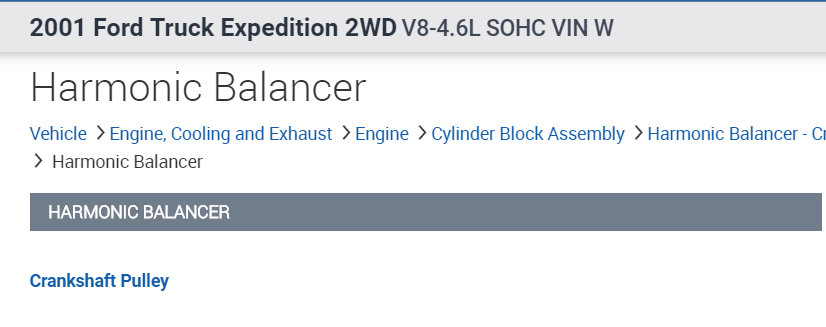

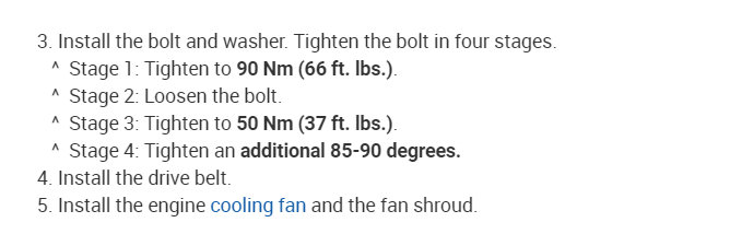

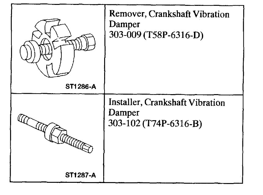

HROBB2133

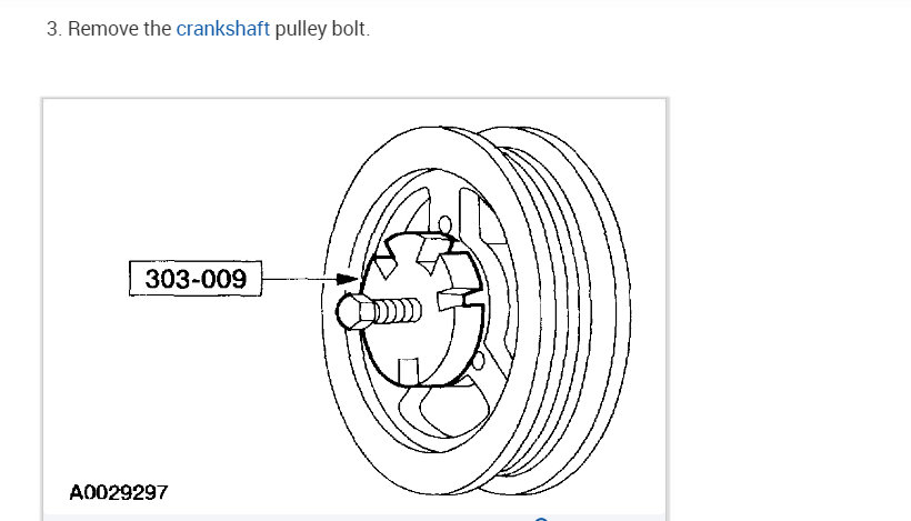

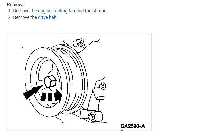

I've been doing some research, it seems that the harmonic balancer on these trucks might be two pieces with rubber inserted between them to absorb vibrations. I'm thinking that if the rubber has deteriorated it may be the source of the sqeal. I'm trying to come up with a way to test this theory without removing the harmonic balancer. Any ideas?
Dec 30, 2020 at 10:57 AM (Merged)

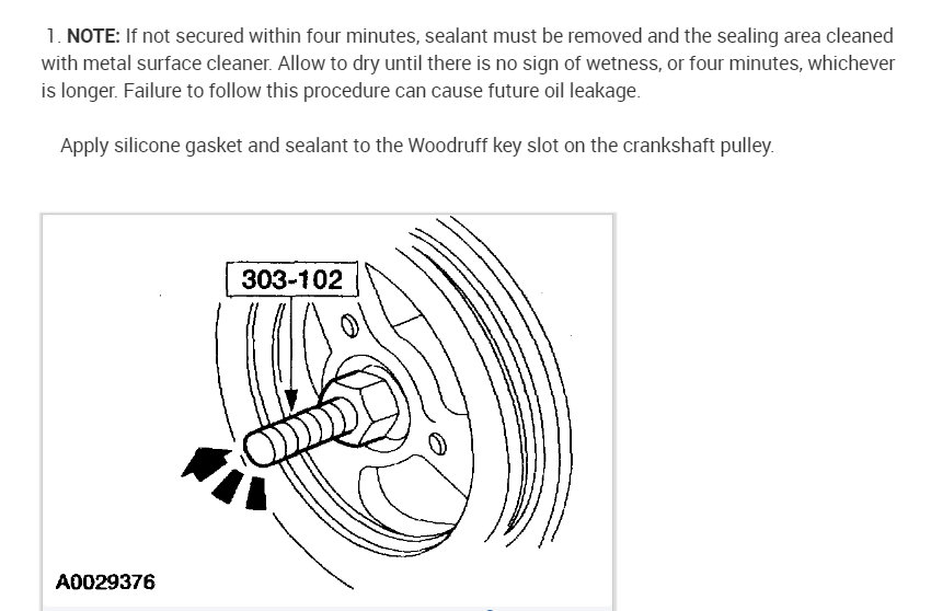

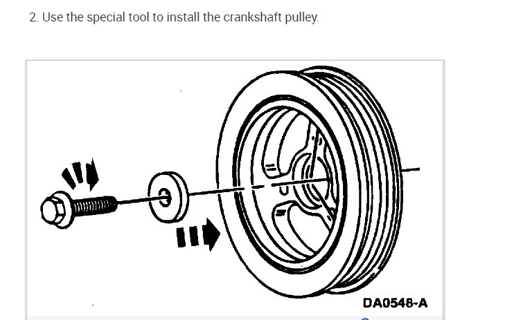

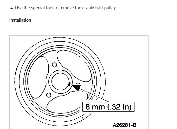

SCGRANTURISMO
  • 4,897 POSTS
Hello again.
If you suspect that the crankshaft pulley is bad, it needs to be replaced. In the diagrams down below I have included the removal and installation instructions from the factory on the removal and installation of the crankshaft pulley for your vehicle. Please let us know how it turns out.
Thanks,
Alex
2CarPros

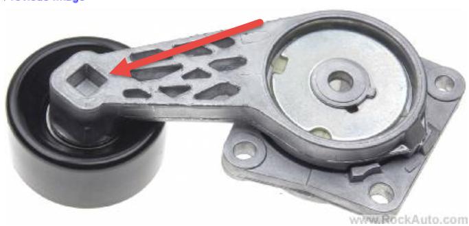

I have a 2001 Ford Expedition EB with 160,000 miles. The alternator finally gave up. No problem. $160 bucks and 1-1/2 hours later and I had a new one installed. However! I noticed, just before starting the engine to check the installation, that the belt was not quite in place on one of the pulleys. I brought out the 1/2" drive and a small cheater pipe and rotated the pulley arm to allow me to move the belt to its correct alignment. I guess in my haste I did not seat the drive properly and ended up breaking out the pulley socket pocket.
My question. Since this now missing material which was directly above where the pulley pivot is located, have I compromised the integrity of this area enough to have to worry about a failure (pulley pivot breaking off?) to have it replaced?
What does one grab onto, now that the socket is gone, to rotate the arm?
Dec 30, 2020 at 10:58 AM (Merged)

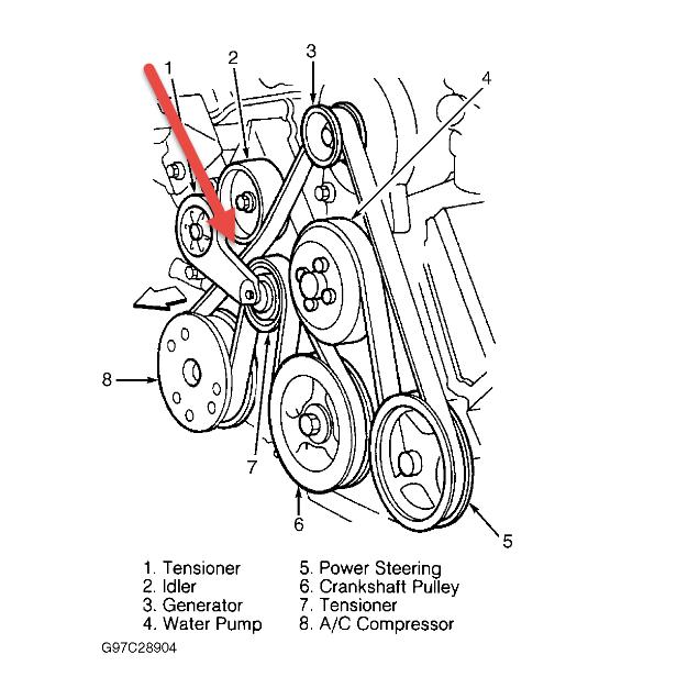

HMAC300
  • 48,601 POSTS
just replace the belt and tensioner they are recommended a t60k you can place a large screwdriver where pointed out and move it to get belt undone. make sure alignment is correct otherwise it will wear the new belt fast.

if you didn't replace the tensioner when you did the blet then it needs to be done so releivng tension to remove belt then removing the tensioner an dreplacing it won't matter if you damage the tensioner further. but it shouldn't take a lot to move it anyhow. if the area that you said is broken (pic) then it's not going to last very long anyhow
RHAUS
  • 4 POSTS
You have pointed to the area that is broken all right! Two sides of the square 'socket' are gone. Thus my concern. Since I am by myself, and most likely will need assistance, I will now take the Expedition to my trusted independent this coming week. It looks like it should be less than a 1/2 hour shop charge plus about $40 for the new arm. So my cost saving self repair will wind up costing me a bit of labor $'s after all. Oh well.

Hello richking12, # Rotate the drive belt tensioner clockwise and put the drive belt back.(see diagram for location of the tensioner.)

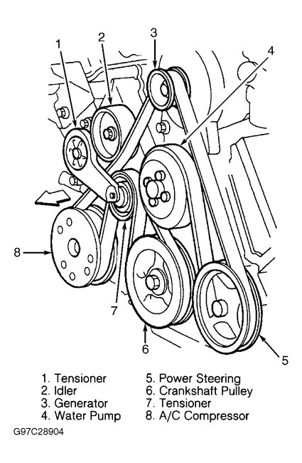

"My 1999 Ford Expedition (formerly a police vehicle) has a serpentine belt that is not installed according to the diagram under the hood. The belt isn't connected to the water pump and crankshaft pulleys. Why is this?"
It should follow the diagram provided. Take a look at these diagrams and see if they are the same or different than the one on the car. The belt needs to turn the water pump If it isn't, the engine will overheat. Also, if it isn't connected to the crank pulley, it won't turn.
https://www.2carpros.com/diagrams/ford/expedition/1999

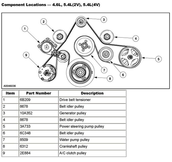

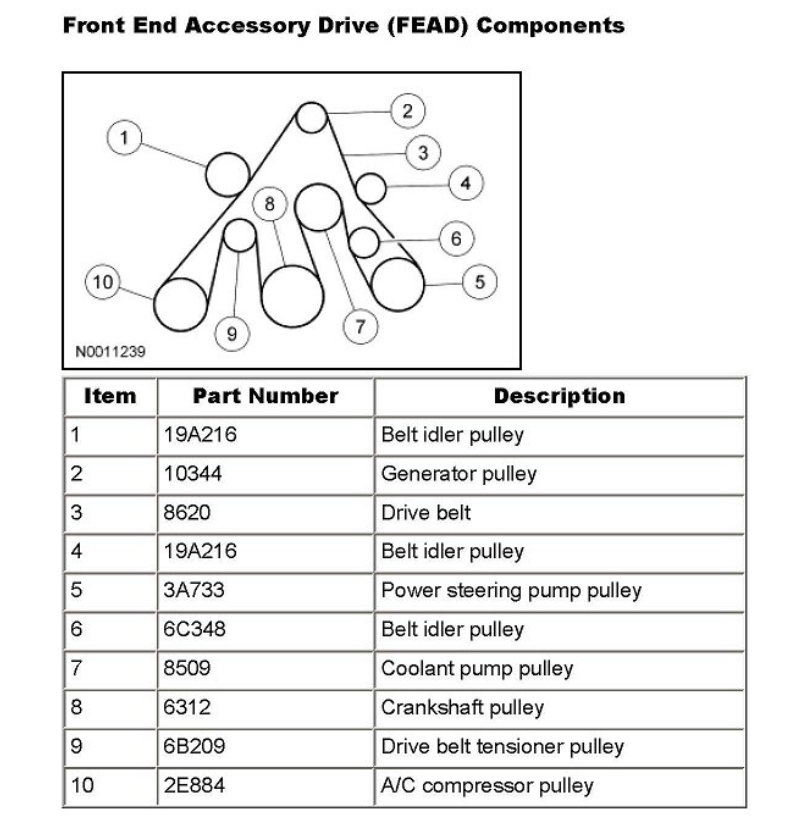

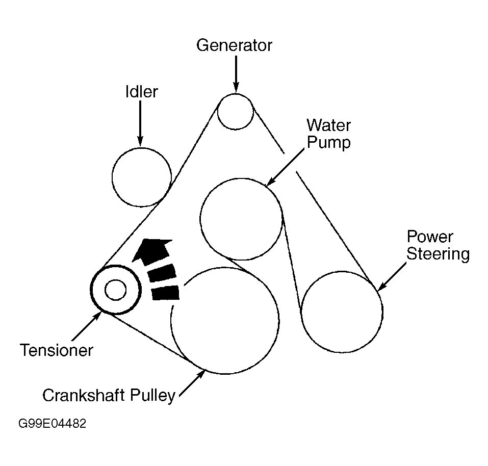

BRBR_TAPIA
diagram for serpentine belt?
DAVE H
  • 13,384 POSTS
this routing diagram is for 5.4L expedition Check out the diagrams (Below). Please let us know if you need anything else to get the problem fixed.
https://www.2carpros.com/forum/automotive_pictures/266999_exp_1.jpg
