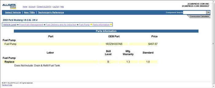

https://www.2carpros.com/forum/automotive_pictures/12900_f_19.jpg
Note: Part and labor varies with location. Labor cost range from $70.00-$130.00 an hour.
