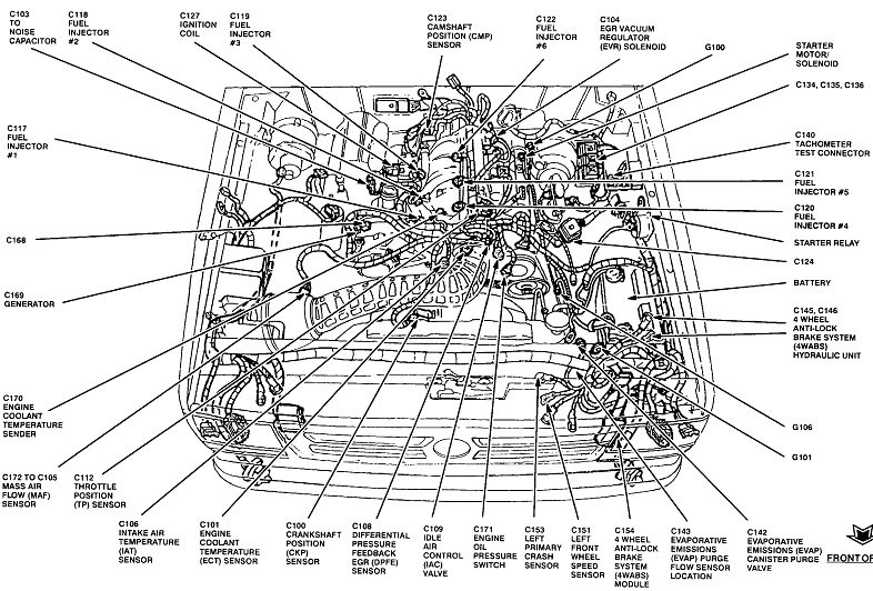

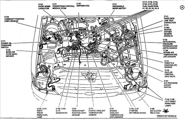

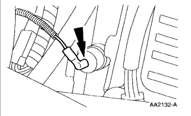

I have what appears to be an oil pressure gauge that is not functioning. I purchased a new oil pressure sending unit in hopes that it will fix the gauge issue. The problem is that I have no clue where the old one in in the engine compartment. I stopped at a Valvoline Quick Oil Change hoping they could help to locate it but they could not. Any place I could find an illustration that would point out the unit in my pickup?
Mar 25, 2010 at 8:10 PM

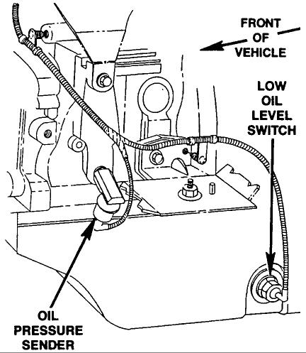

The oil pressure sender is near the oil filter. Here are some diagrams that will show you where the sender is on both 6 and 4 cylinder engines. (below)

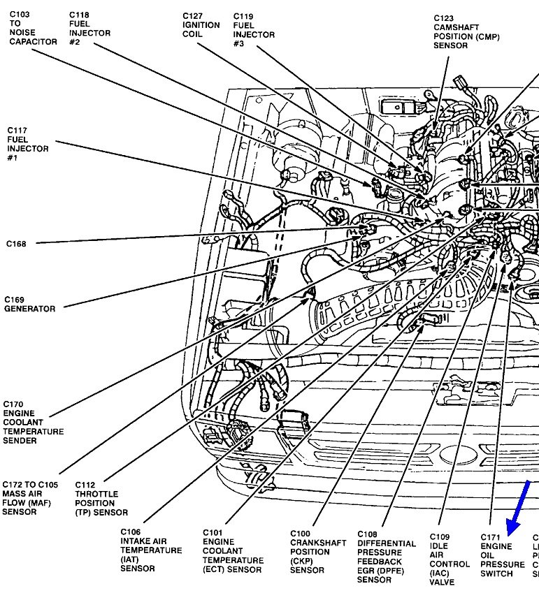

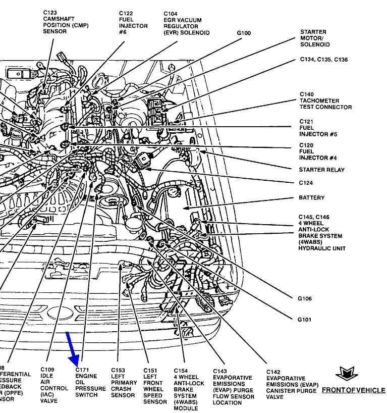

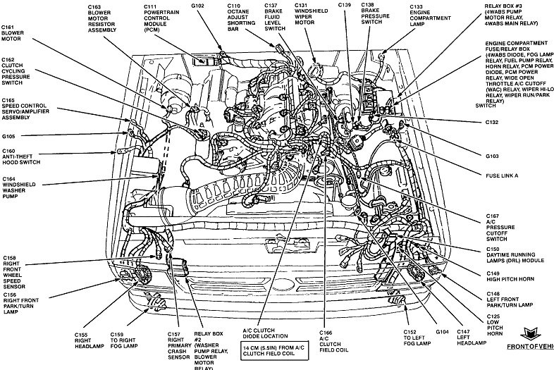

I need to know where the oil pressure switch is at on the truck listed above. also it's not in the front, where all the diagrams say it is. Also it's a manual transmission if that has anything to do with the location of the oil pressure switch.
Dec 7, 2020 at 8:30 AM (Merged)
CARADIODOC
  • 34,306 POSTS

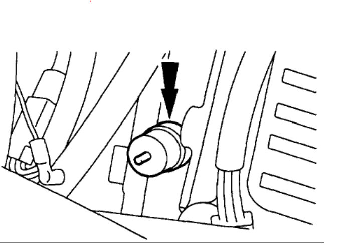

The blue arrows are pointing to it. The first and fourth drawings are the two parts of component layout under the hood. The second and third are just expanded views if the first drawing to make it easier to read.
CARADIODOC
  • 34,306 POSTS
"On the fourth picture where is the oil pressure switch because I think that diagram is the right on but it doesn't label the oil pressure switch.".
The fourth diagram isn't involved with your request. I just included it so you would have everything available for your truck. The sending unit is shown on the first drawing, but it's hard to read. That's why I cut it in half so it could be expanded. That's the second and third drawings, and those are where I added the blue arrows at the bottom.

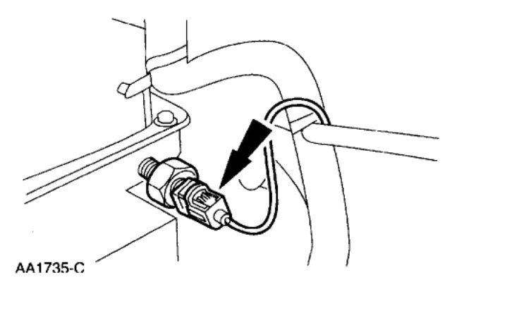

Where is the oil sending unit located? And would that spray oil on the engine & side wall?
Dec 7, 2020 at 8:31 AM (Merged)
DOCFIXIT
  • 18,828 POSTS
Here is location and yes 40+ psi can spray all over
