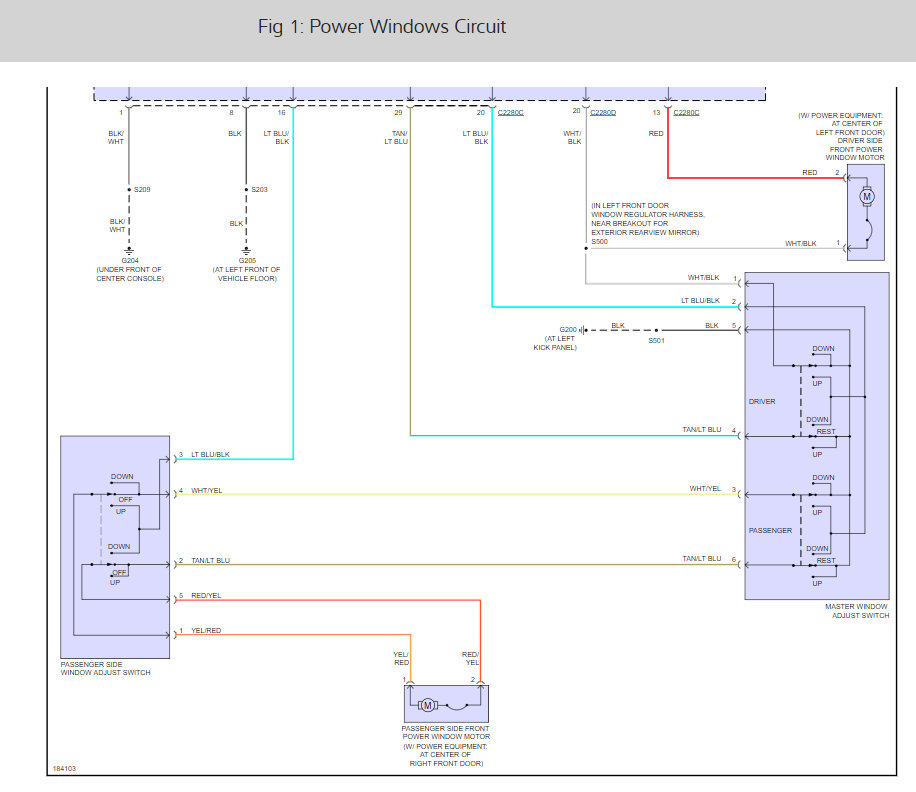

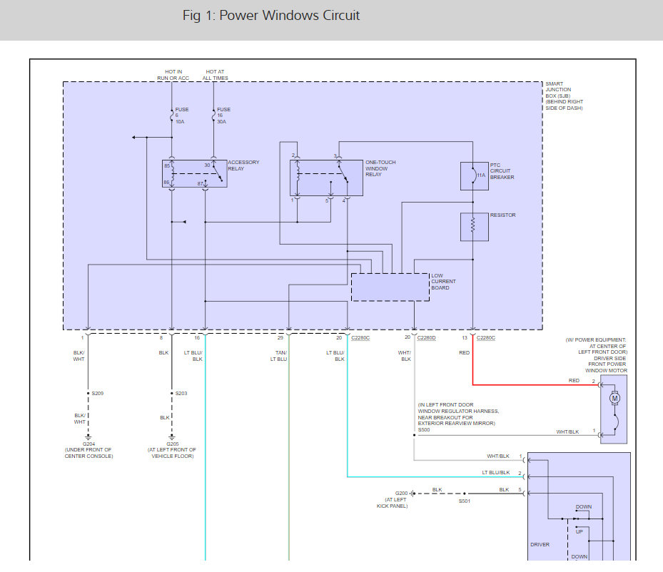

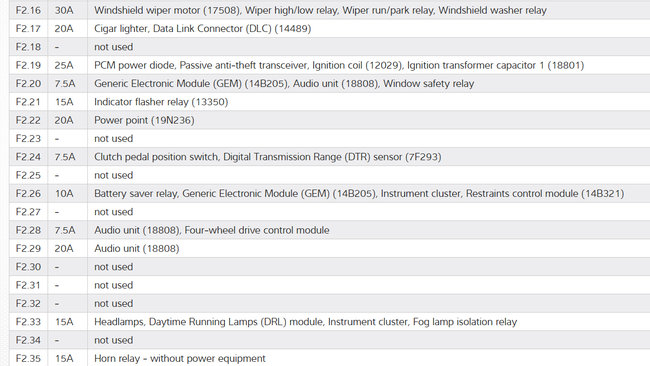

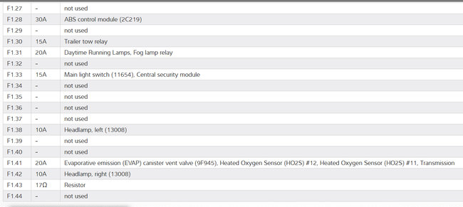

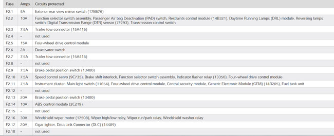

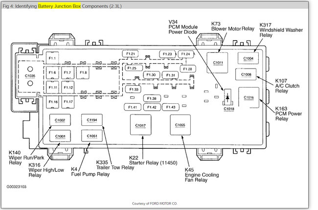

Here is a guide that will help you test to see if it is the switch (that's what is sounds like) and the window wiring and fuse diagrams so you can see how the system works below.
https://www.2carpros.com/articles/electric-window-repair

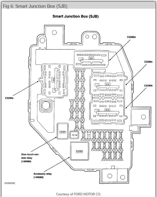

Check accessory and one touch relay and check fuse # f1.16 (30A) and # 6 (10A)
Check out the diagrams (Below). Please let us know what happens.
