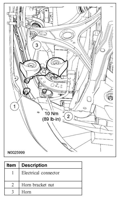

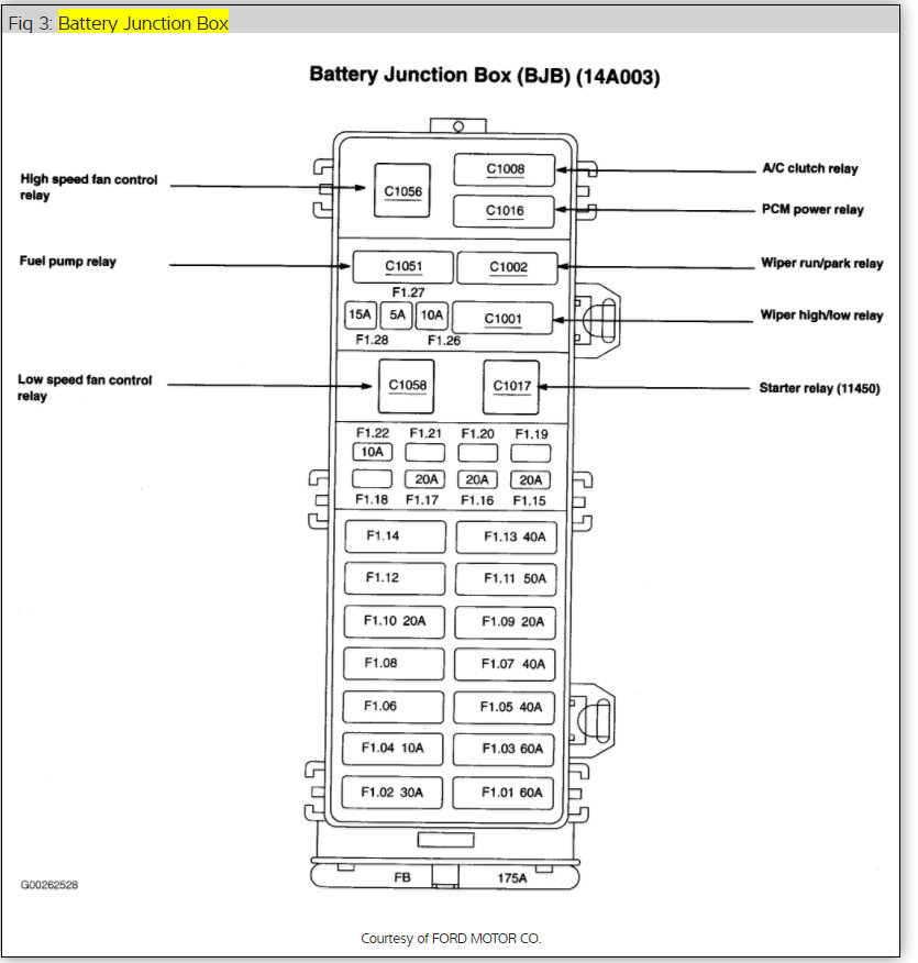

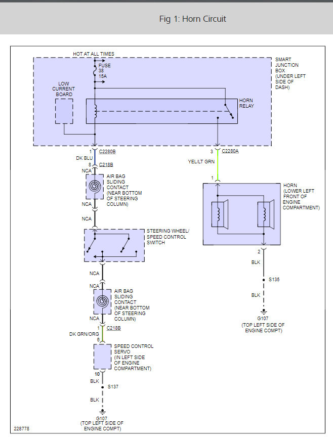

Hi!
It sounds like the horn itself went bad which happens all the time but to be sure lets do some simple testing. Here are some guides and diagram(below) that will help you get the job done.
you will need to get under the car safely
Here is a guide so you can check the relay as well.
Please let us know what happens so it will help others.

Horns are located on lower left front of engine compartment. You have to remove the headlamp for better access. Horn relay is inside the smart junction box under left side of dash. Fuse #38 15A controls it.
Focus: Same location for horn(s). Some have one, others have two horns. Smart junction box under left side of dash fuse #32 20A and a horn relay.

Unfortunately the insane engineers found a solution where there was no problem. Instead of the horn switch turning on the ten-dollar relay to blow the horn, the horn switch now sends a voltage to the most intelligent computer on the car, the instrument cluster, which interprets that and sends a digital signal to the FEM, (Front Electronic Module), which turns on the horn relay. That's right; two computers involved in blowing the horn. The typical repair bill for a dead horn is between $700.00 and $800.00. I hope to hear your bill is much less. The dealer will have to diagnose the problem. You've already done all you can with your dandy observation that the relay, fuse, and horns are okay.
If I had that circuit in my car, I'd be modifying it to work with the simple switch and relay like all cars had in the past. There's no need for this Rube Goldberg system. This isn't just a Ford thing. Most manufacturers are doing the same types of things to purposely make cars unnecessarily complicated and cost us way too much to diagnose and repair.

remove the pad and check the wire to the steering wheel it maybe lose.try grounding the contact in steering wheel with a test light.if still nothing you need to prob the turn signal switch harness connecter with the test light.if it works when you prob the turn signal harness connecter and not at the steering wheel contact its in the steering column.

We both forgot to mention the clock spring too. That has a higher failure rate than a computer module.

Will do. Was just wondering if y'all had any diagrams for it. Was wondering if I'd have to take off the whole front end just to get to it because when I looked at it yesterday I saw it from underneath by the front driver side fender could remove the plastic by the wheel well and the plastic bottom to get to it or just take the cowl off and the bumper

with cruise control and without
the procedure for removing says disconnect the electrical connector and remove a bolt and both hi and lo horns should come out as an assembly

Lol it happens. Y'all get millions of questions to answer. My question was if I had to take the whole front end off to get to it or do what I think I'd be able to do and just take off the bottom plastic piece and the plastic wheel well
Aug 15, 2020 at 12:29 PM (Merged)
MA AV
  • 32 POSTS
just disconnect electrical and remove a single bolt.....maybe hook a test light up to the cut wire on harness side of horn circuit and press horn button and see if it lights up or go aftermarket no sense in removing if we havent tested it first...horns rarely go bad(rarely but they do) id make sure the wiring is ok

Did you use a voltage tester on the fuse circuit, to see if it is hot? Even if fuse is good, if no voltage, the circuit is dead. You could do some checking at the horn relay. The problem is usually the wiring circuit in the steering column, maybe you'll get lucky? At the datalink connector, pin 16 is voltage, hot all the time, fuse 230--15amp. Pins 4 & 5 are grounds.
https://www.2carpros.com/forum/automotive_pictures/512072_horn_circuit_taurus_1.jpg
