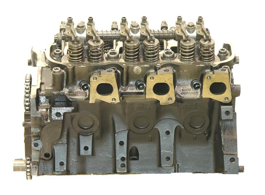

Location of freeze plugs on passenger side engine

There are three on each side, they are in line with each cylinder bore. One on each end of the cylinder heads. They are not easy to do with the engine in the vehicle because of all the things bolted around them. In general you would be replacing them from under the truck.
